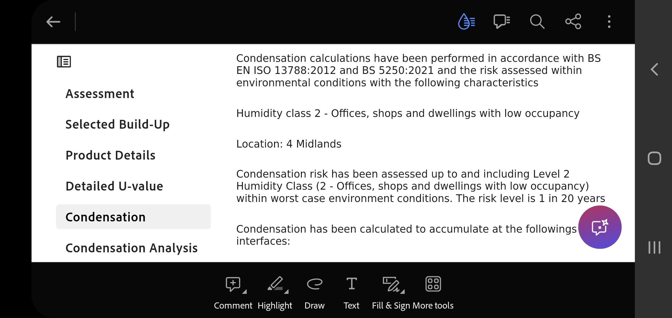

Jit83 Posted May 13, 2024 Author Share Posted May 13, 2024 Unfortunately the builder isn’t willing to make any changes to the top side of the roof. They’ve carried out a condensation risk analysis which is attached below. I’ve never seen one of these before but I think it looks OK? 1-MP-240513-101423-147.pdf Link to comment Share on other sites More sharing options...
Moonshine Posted May 13, 2024 Share Posted May 13, 2024 11 minutes ago, Jit83 said: Unfortunately the builder isn’t willing to make any changes to the top side of the roof. They’ve carried out a condensation risk analysis which is attached below. I’ve never seen one of these before but I think it looks OK? 1-MP-240513-101423-147.pdf 87.69 kB · 2 downloads NO..... it's not o.k, this risk analysis is for a low occupancy building, do not accept this get them to put it right, it's what the drawing said. What else are they doing not to spec? Link to comment Share on other sites More sharing options...
Jit83 Posted May 13, 2024 Author Share Posted May 13, 2024 I know, that’s what’s concerning me too. They’re meant to be a reputable company so it’s really frustrating. They have finally agreed to do the job properly after a lot of going back and forth. Thanks for the help on this. 2 Link to comment Share on other sites More sharing options...
