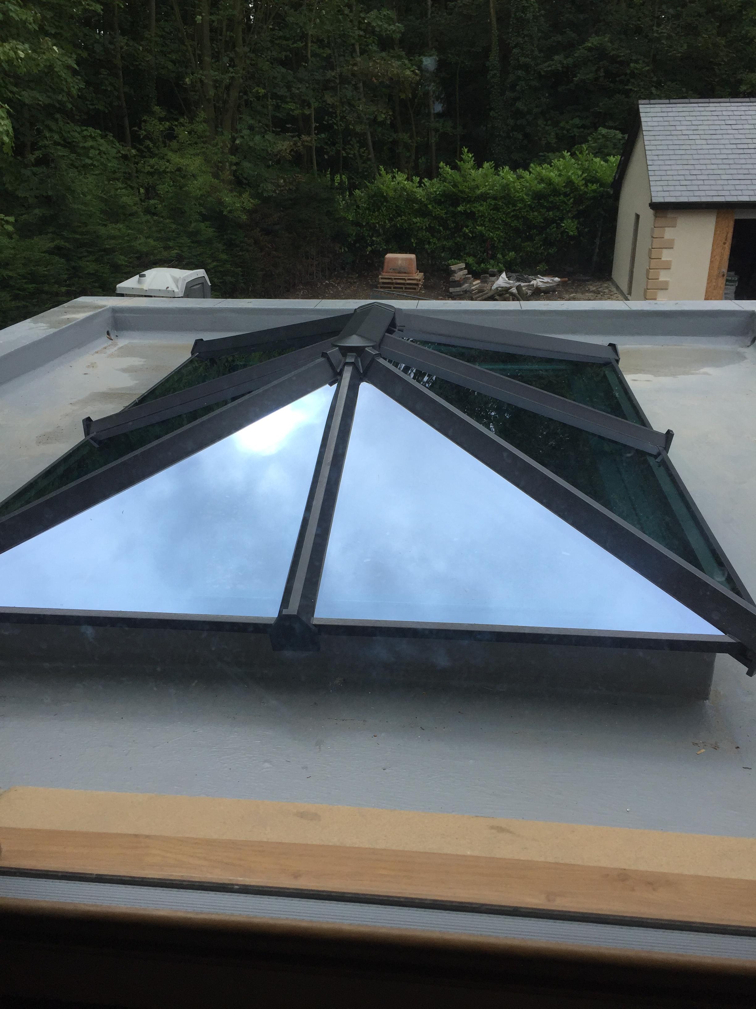

I used fibreglass on ours I had no experience but found it pretty easy with some good advise from a boat builder friend of ours 8D733754-6774-44A3-8652-B2B8244F5A78.thumb.jpeg.1a7b5f4f3f6ff8a6259e67b53298b4dc.jpeg
