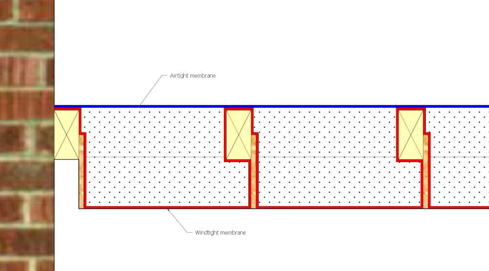

Because the joists and space below are shallow, I'm limited to 100mm of insulation so going to have to use 100mm PIR between our ground floor joists to get the best U value I can.
Previously I'd planned to use the Ecological Building Systems approach of loose insulation and 2 membranes:
optimised-wind-proofed-naturally-insulated-air-sealed-suspended-floor-system.jpg.f3268df86e02864198358f3f2746fd55.jpg

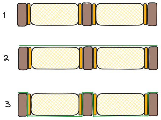

I've come up with 3 ideas for PIR insulation, from least to most work:
  1. Install boards using Gapotape (or home made equivalent as that stuff is seriously expensive. I'm experimenting with expansion joint foam and aluminium tape) and tape joints between boards with Tescon Vana. Don't tape between boards and joists.
  2. As above, but then put an airtight non-breathable membrane VCL over it all. Any poor fitting boards can still let cold air come up to floor level
  3. Put the airtight membrane VCL below the PIR boards and over each joist. No cold air can make it to floor level
Which approach has the least drawbacks?

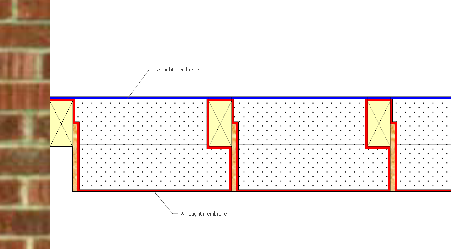

I'd still have a wind tight and airtight membranes at either side of the insulation. Doesn't need to be the expensive ones recommended by Ecological if you're going with PIR, but the benefits of both are still applicable. (So 2 and 3)

4 hours ago, Redbeard said:
Can I suggest a point 4? VCL over the lot.
That would be idea 2 I think, with VCL being the proper term which I didn't know for "airtight non-breathable membrane" (something that keeps water vapour in the house and stops it from getting into the void)? I've edited my original post to clear this up.
22 minutes ago, jayc89 said:
I'd still have a wind tight and airtight membranes at either side of the insulation. (So 2 and 3)
Interesting, is that to be belt and braces? So 2 stops water vapour and air moving down and around the PIR, while 3 stops air and water vapour coming up from the void?
Any brand alternatives you can suggest? I'm unclear if a cheaper VCL is just thick polythene in this case or it's something more fancy and reinforced.

Can you not just allow the lower membrane to drape below the level of the floor boards to fit more mineral wool?
You could add rips of ply or OSB to extend it as low as you like.
I'll do a sketch

Presumably the void is/should be ventilated so the wind tight membrane will prevent cold air flowing through the insulation (as, again I assume, you'll only be taping the top of it). Airtight membrane on top to prevent warm, internal air going the other way.
No reason some cheaper polythene, or suitable gauge wouldn't do the trick. I'd probably go for something like a DPM for the bottom and a thiner sheet above,

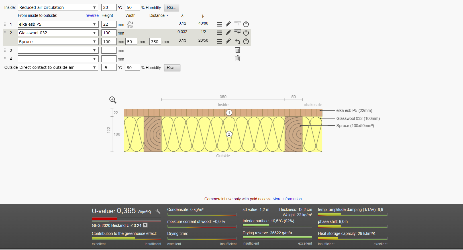

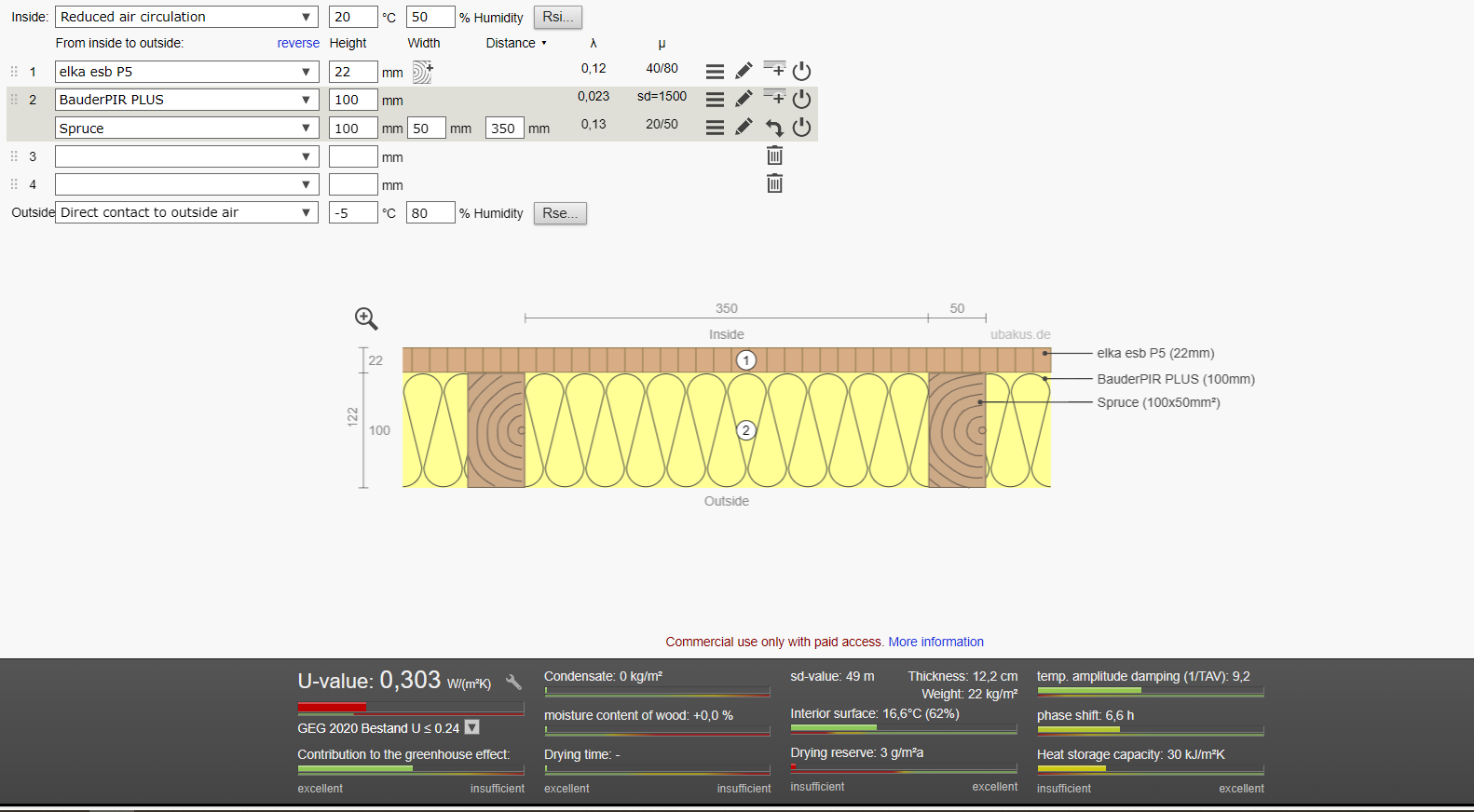

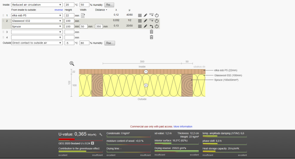

Don't get hung up on U values. There's really very little in it. The actual performance will be much more affected by the airtightness and wind tightness.
Have a look at these examples.
As the timber is such a large factor the type of insulation makes much less of a difference. If you were able to break the thermal bridge of the joists with a continuous layer you would fare much better but as you're limited with space no such luck.

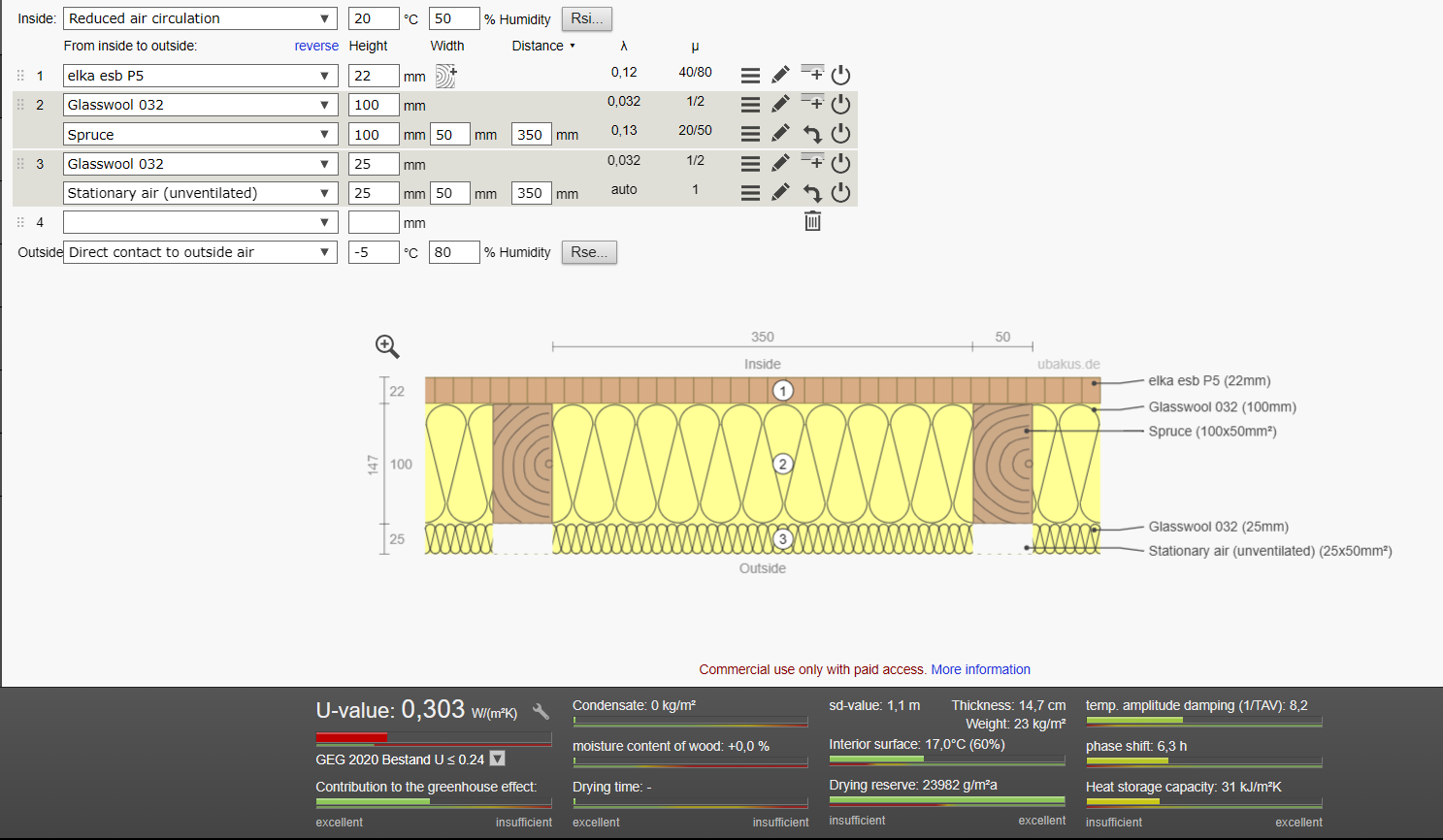

I agree. Whether I notify BC or not I'm trying to get it to meet the required U-value of 0.25W/(m2K) and got myself in a right tangle with Ubakus
I will try and recalculate with other insulation materials, but I haven't understood properly the perimeter/area ratio stuff used in England for floors. Like perimeter of whole suspended floor, or just the current room?

Should the membrane between the joists and under the fibreglass be vapour permeable, in case the insulation ever gets damp (dripping pipe or whatever)? If so, what's the cheapest one I can get?
The layers I'm thinking are:
VCL (polythene sheet, stapled down) on top to stop any moisture getting into the space, and as a second airtightness layer.
Fibreglass between joists
Vapour permeable airtight layer (TBC, draped over joists and fixed in place) to support the fibreglass, prevent wind washing and add airtightness
Void

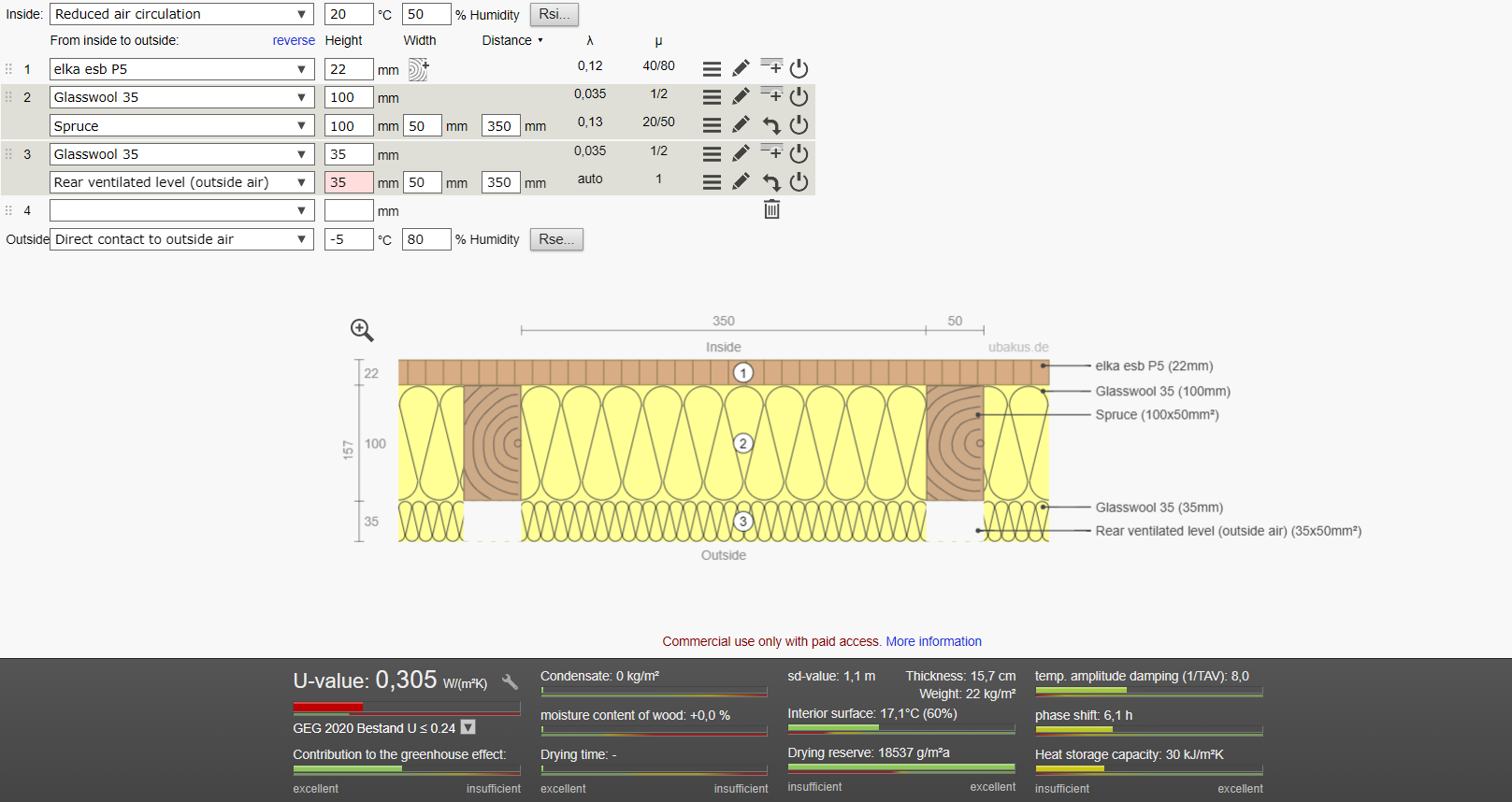

While your earlier calculations used 0.32 glass mineral wool the stuff easily available here is 0.44 Knauf loft roll. It means the calculated U-value of the floor is 0.29, but is cheap.
