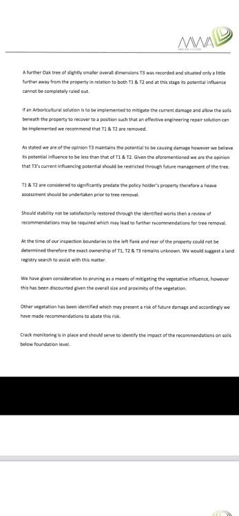

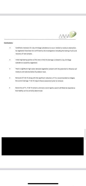

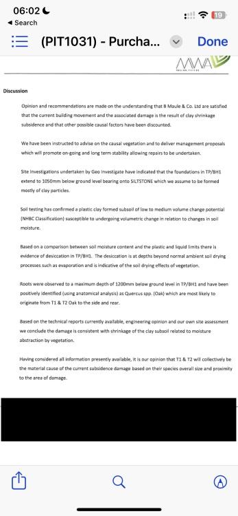

Bluebaron Posted May 4, 2024 Posted May 4, 2024 Looking at a house and just got the legal pack. I’ve found a report of subsidence in 2013/14. It’s all been fixed and was blamed on clay soil and three large oak trees less than 10m form the house. the report recommended removal of these trees and this hasn’t happened. 10 years later I’m concerned that a re-occurrence is a distinct possibility. I’ve asked the seller to confirm and why the trees have not been removed. Should I walk away from this one or what would you recommend?

Bluebaron Posted May 5, 2024 Author Posted May 5, 2024 Thanks Jilly, yes the trees are all on the property. They currently are not TPO’ed. I was concerned about heave, I’ve asked if a heave survey was carried out. I’m waiting to hear back. It doesn’t look like any crown reduction as taken place in the last 10 years. Except from 2014 report below. not sure what advice to get here? Full structural survey? Would this include test pits to assess root invasions? the next door had just had a small rear extension added and the builder said there were roots everywhere he got away with 2.5m trench fill. He’s further from the trees, he said piling would have been a better option but homeowner wanted to save money. I was hoping to remove the trees anyway to use the side plot for a new dwelling. I’ve read up on heave and not sure how to prevent it causing damage to existing particularly with the history.

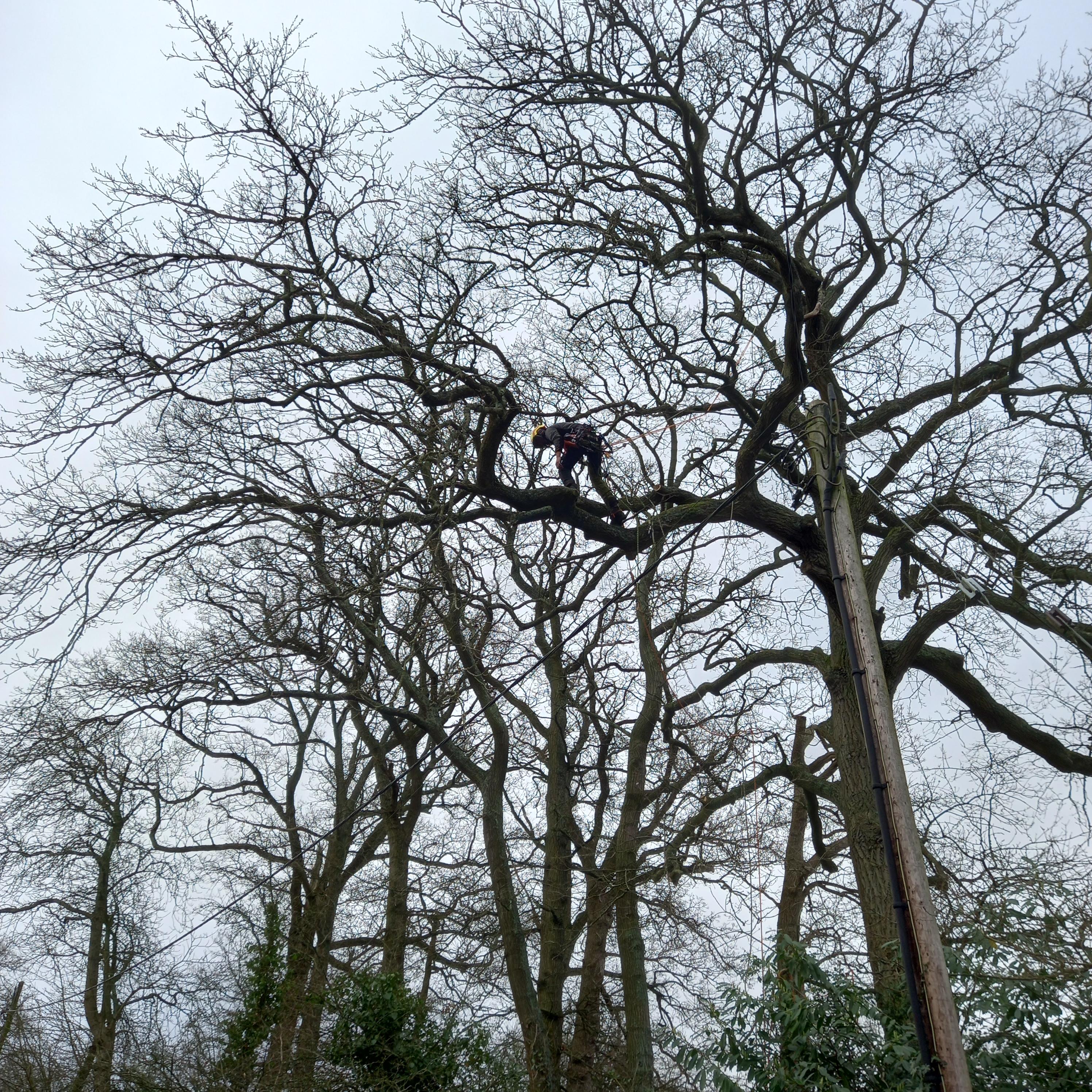

twice round the block Posted May 6, 2024 Posted May 6, 2024 (edited) On 05/05/2024 at 18:27, Bluebaron said: I think I’ll probably go back and say I want the trees removed entirely before completion and a full foundation survey done at their cost. If not I’ll have to drop price significantly. I'm not sure any seller would agree to that. It's down to you to get a full survey done, then take a punt on it if you think it's still viable. To remove large oaks with a climber and ground team is probably £800 per tree, without stump grinding. Edited May 6, 2024 by twice round the block
ProDave Posted May 6, 2024 Posted May 6, 2024 Add some more £££££ for dealing with those electricity cables.

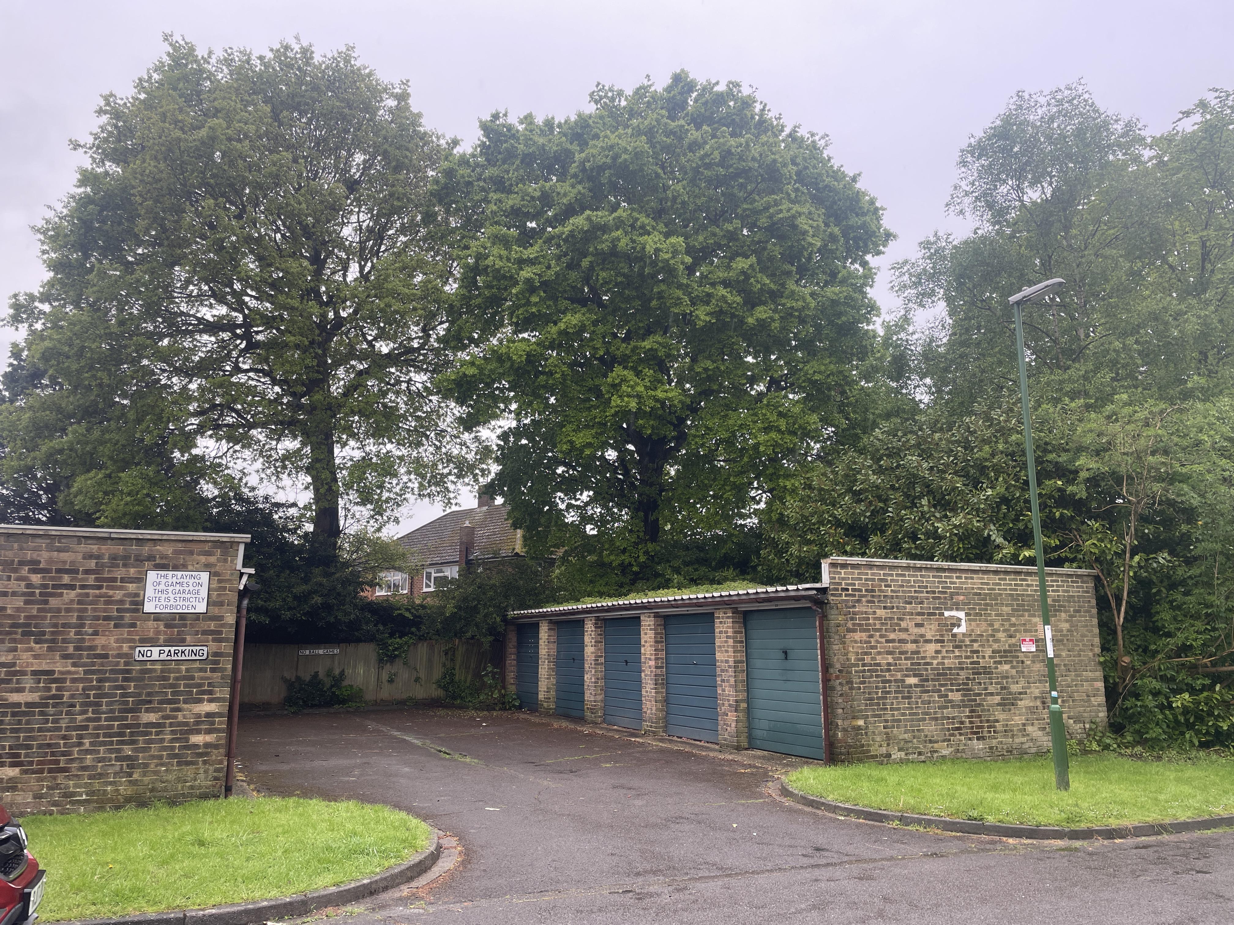

Bluebaron Posted May 7, 2024 Author Posted May 7, 2024 £800 would be great last time I had a tree down cost me £2500 and this is a lot larger. 🤷🏻♂️ These are the tree la I’m looking at. Not sure what that photo above is.
Bluebaron Posted May 16, 2024 Author Posted May 16, 2024 OK so i'm still debating on this one. Pro's, established residential area guy across the road has done similar end of cul-de-sac location Looks like a good shot at getting PP. (local history) If not ill go down the side extension route con's history of subsidence. Looks to fine now but the 3 large oaks 7-10m from the house right where i want to build. If i take the trees out there's a real risk of heave, this shouldn't effect the new build as ill design around the risk. But it could affect the existing including the neighbour. (who just finished a rear extension) Aso taking out 3 large oak tree will piss a few locals off i bet as to be fair they are quite nice trees that predate the house (1950). Spoke to one SE who said i would mad to remove the trees and would definitely cause a heave risk. (over the phone didn't see site). A second specialist soil guy told me to test the soil to see the clay content. I'm thinking i could get a soil survey/heave assessment done to start but will probably be an educated guess. Thoughts? It is worth the investment in surveys/cost/time or is this gamble a bit high risk? If is wasn't for the trees i would be all over it.

Bluebaron Posted May 17, 2024 Author Posted May 17, 2024 Well the point I’m getting at is I’m looking at the plot as a potential site for a self build. The trees are 7-10m from the existing house and would be in the way of any development. removing the trees may pose a risk to the existing property. so I’m wondering if it’s worth the punt to secure a potential plot or whether to walk away before I spend a fortune of expensive surveys.
