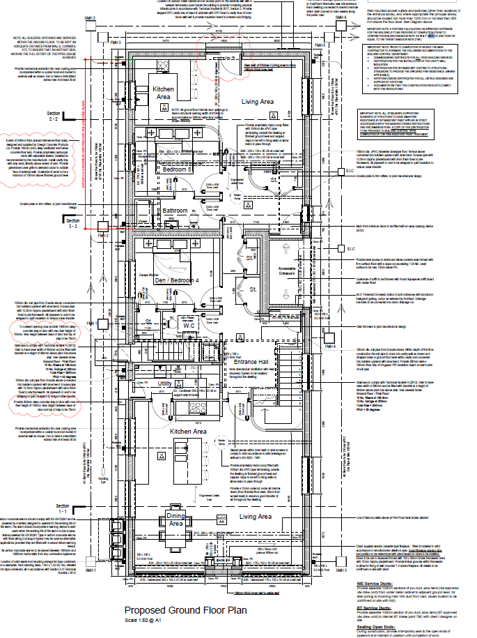

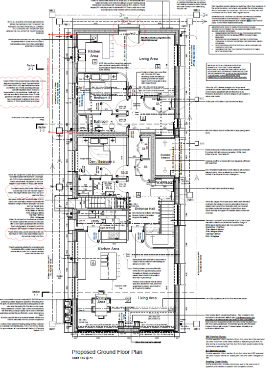

CalvinHobbes Posted April 29 Share Posted April 29 The solar guy said we should not put the battery outside since doing so in our wet cold location will mean it will discharge, (he wants the meter and batteries in the utility room)having had an electric car, a little zoe over a winter I can see what he means. That said the electrician is adamant we dont put it inside saying battery fires are terrible (He wants the meter in the cupboard behind the porch). We don't have a garage. So I was thinking we could put it in the porch but that is open on one side and outside the thermal envelope The electrican wants to put it outside in some sort of hut. Oh and thanks I have gone back and asked for the 3 phase inverter that is hybrid and acceptable to give energy to the grid. Link to comment Share on other sites More sharing options...

CalvinHobbes Posted April 29 Author Share Posted April 29 So went to the fire station. After a debate they agreed what they would do is put them in the utility room with a heat sensor. As long as branded batteries installed by MCs then grand. Link to comment Share on other sites More sharing options...
