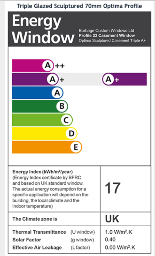

PeterW Posted October 11, 2017 Share Posted October 11, 2017 I've just taken delivery of 3G UPVC from Modern Trade Windows and I'm impressed with the quality and build. Couple of niggles with them but that is down to me making frame sizes very tight to brickwork, not the manufacturing..! They use Profile 22 and its a 4-16-4-16-4 unit with softcoat. We nearly went for their anthracite grey however when I got a sample it appears to have a grey/blue tinge to them. This is common on a lot of the UPVC profiles so I suggest you get a sample of the profile and do not go by the catalogue..! Link to comment Share on other sites More sharing options...

PeterW Posted October 11, 2017 Share Posted October 11, 2017 20 minutes ago, MikeGrahamT21 said: Yeah the 7016 on upvc does have a slight blueish tint i agree, we have some already, but I don't mind it, looks nice when installed. What are the u value on those windows? I'll take a look at that company, and also the profile. This is the certificate for the windows Drop me a PM if you want some installed photos. Link to comment Share on other sites More sharing options...
