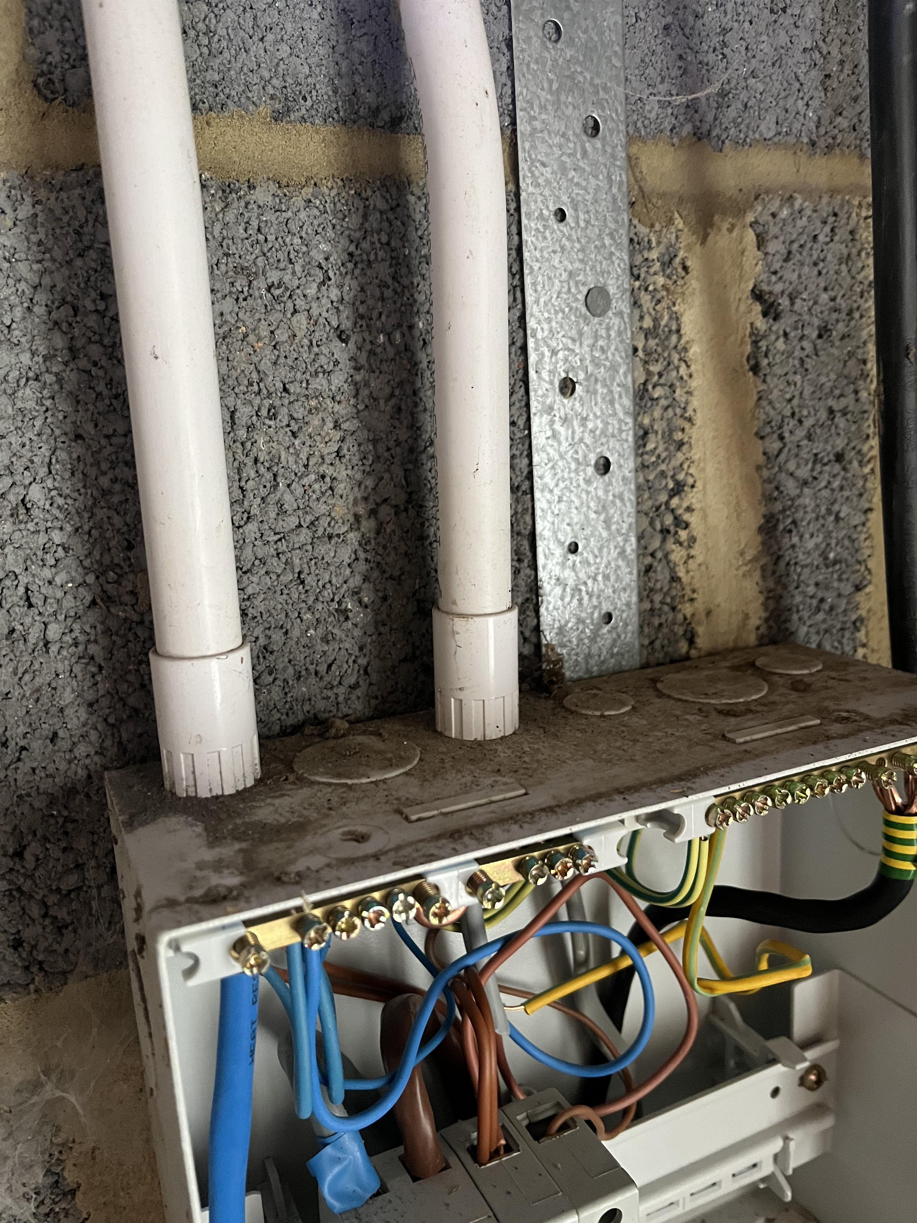

GreenSophie Posted April 23, 2024 Share Posted April 23, 2024 I’m so sorry if this has been asked before. We have a large shed with a south facing roof around 100m from the house and would like to install 8-10 solar panels on it to provide electricity for the house and export any surplus to the grid. Digging a new cable run between the house and the shed would be a nightmare so we wondered if we could put an inverter in the shed and then use the existing mains cable which runs from the house to transfer the AC power produced by the solar set up to the house. It is a 3 core, 25mm armoured cable, each core has 6 strands of copper wire. It’s around 100m long and the shed has its own consumer unit. We’d want to be able to continue to use the cable to supply power to the shed. Sorry if this sounds a bit vague, we just want to know if the project is viable before contacting an electrician. Link to comment Share on other sites More sharing options...

ProDave Posted April 23, 2024 Share Posted April 23, 2024 If it really is 25mm armoured cable, then you are okay, but only 6 strands per core it is far more likely to be a lot smaller. Can you post any kind of picture of the ends of the cable, e.g. where it terminates at either end? Or get an electrician to measure Zs at the shed and post the reading he gets here, from that we can work out the likely volt drop (will be volt rise with PV generation) Link to comment Share on other sites More sharing options...
GreenSophie Posted April 23, 2024 Author Share Posted April 23, 2024 Thanks so much for your quick replies. it’s definitely 25mm diameter armoured cable. Here’s a pic of the inside of the shed consumer unit and you can see the earth core has quite thick copper wire strands. No idea if that helps! Link to comment Share on other sites More sharing options...
ProDave Posted April 23, 2024 Share Posted April 23, 2024 Yes that looks like 25mm. At 16A (typical 4kW PV array) you are likely to get about 3 volt drop over that cable, which should be fine. Remember that will be voltage rise when it is generating. So as long as your mains voltage is no higher than 250V (it should not be) you will be fine. Most inverters trip or start limiting when they reach 253 volts. Link to comment Share on other sites More sharing options...
GreenSophie Posted April 23, 2024 Author Share Posted April 23, 2024 Voltage in shed is 242, in house is 245. So you’re spot on, ProDave 😊 really silly question, but can the same cable be used for both mains supply to shed and solar generated supply to house? Link to comment Share on other sites More sharing options...
ProDave Posted April 23, 2024 Share Posted April 23, 2024 1 minute ago, GreenSophie said: Voltage in shed is 242, in house is 245. So you’re spot on, ProDave 😊 really silly question, but can the same cable be used for both mains supply to shed and solar generated supply to house? Yes it can. With those voltage readings you will be fine. Lucky the original person properly sized the cable for the length. It is surprising how many sheds you find wired with a bit of wet string. I was asked to check a DIY garage conversion complete with electric panel heating, electric water heating and an electric shower. The whole thing was fed with 2.5mm cable. Link to comment Share on other sites More sharing options...
