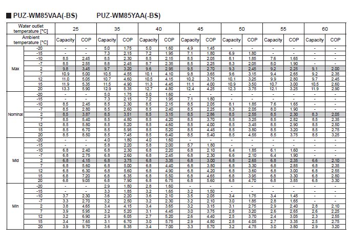

JohnMo Posted April 18, 2024 Share Posted April 18, 2024 Doesn't section 8 not have the heat loss rate in Watts for each month. So wouldn't it be the figure for the worst month (Jan in my case), then allow enough for dhw heating. Mine said 2980W, Jeremy spreadsheet pretty similar, heat meter said the same. Using a 6kW ASHP, which is really a little large, but works fine. Link to comment Share on other sites More sharing options...

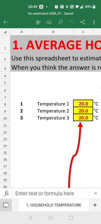

JamesPa Posted April 19, 2024 Share Posted April 19, 2024 (edited) 5 hours ago, MrPotts said: If I use the rule of thumb on Michael de Podesta's blog then I need a ASHP of 4.28kW, I have also gone through the process of working out a heat pump size on Heatpunk and that states 7.69kW. Which is right, I have no idea! Do you know how much energy you currently use to heat your house? How does it compare with the EPC value? If you do that will give you a clue. Have you got any way of monitoring it real time ( I watch my smart meter and download half hourly meter readings). If you can do this then you should be abke pretty much to nail it. Also how much of the 7.7kW is down to unknowns (the biggest possibly being ach). Again potentially bit more data ( this time on the uncertainty in the spreadsheet answer). Realistically all you probably need to know is whether to buy an 8kW or a 5-6kW pump. If your house really is 4.3kW, then most of the time it will likely be consuming 2.2, so you need the pump to work smoothly at that load. An 8kW one won't, a decent 5-6kW one should. On other hand if your house is really 7.5kW it will be consuming 4kW most of the time, which a decent 8kW model will modulate down to. Sometimes (not always) combining data may allow the answer to be deduced to a level which is, with a high degree of certainty, good enough. Edited April 19, 2024 by JamesPa Link to comment Share on other sites More sharing options...

MrPotts Posted April 20, 2024 Share Posted April 20, 2024 (edited) 10 hours ago, JamesPa said: Do you know how much energy you currently use to heat your house? How does it compare with the EPC value? If you do that will give you a clue. Have you got any way of monitoring it real time ( I watch my smart meter and download half hourly meter readings). If you can do this then you should be abke pretty much to nail it. Also how much of the 7.7kW is down to unknowns (the biggest possibly being ach). Again potentially bit more data ( this time on the uncertainty in the spreadsheet answer). Realistically all you probably need to know is whether to buy an 8kW or a 5-6kW pump. If your house really is 4.3kW, then most of the time it will likely be consuming 2.2, so you need the pump to work smoothly at that load. An 8kW one won't, a decent 5-6kW one should. On other hand if your house is really 7.5kW it will be consuming 4kW most of the time, which a decent 8kW model will modulate down to. Sometimes (not always) combining data may allow the answer to be deduced to a level which is, with a high degree of certainty, good enough. I use just under 12.5kWh of gas in a year. That also includes hot water and cooking on a gas hob. Edited April 20, 2024 by MrPotts Link to comment Share on other sites More sharing options...
