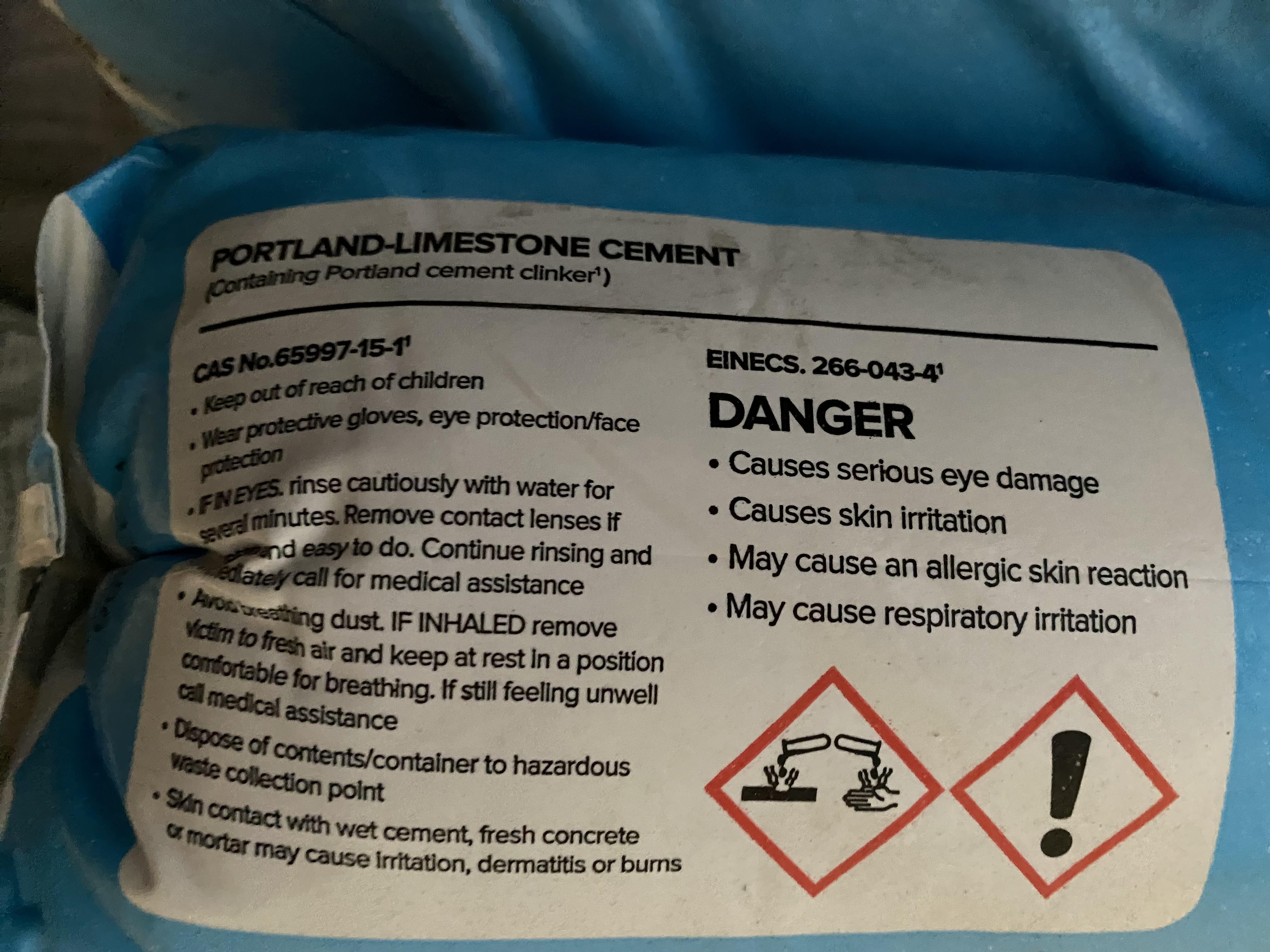

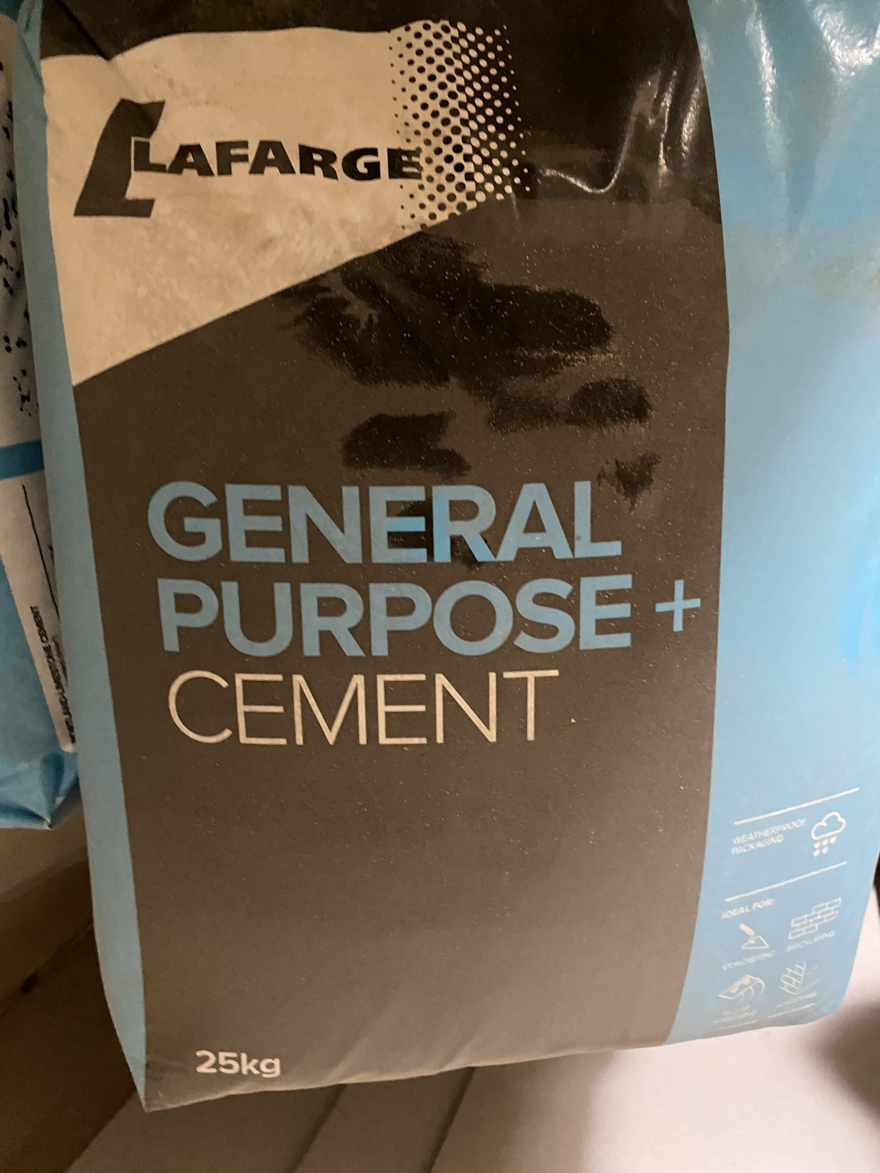

Reginald Posted April 17 Share Posted April 17 Hi everyone Our floor fitter suggests that we avoid anhydrous screed ahead of laying a herringbone floor as it apparently takes much longer to reach the required low moisture level to lay the floor. I’m struggling to find non-anhydrous cement to make up a sand & cement mix for the screed. We were looking at Lafarge General purpose + cement but that has clinker in which I believe is anhydrous. any tips please? (I also thought all cement was anhydrous so it’s a learning curve!) thank you Link to comment Share on other sites More sharing options...

Reginald Posted April 17 Author Share Posted April 17 47 minutes ago, garrymartin said: I have to start most of my responses by saying "I'm not an expert in this area..." but my understanding was the opposite, i.e. that the anhydrous element (calcium sulphate) *replaced* the cement as a binder. Here you go - this should be useful; https://www.homebuilding.co.uk/advice/a-screed-masterclass This is a helpful read, thank you 44 minutes ago, Thorfun said: afaik from my research you can get anhydrous and cement based liquid screeds. i didn't want anhydrous due to having a laitence removal requirement and being gypsum based. the cement based liquid screed was brilliant and ticked all the boxes for me. @nod is a screed expert (i most definitely am not!). hopefully he'll be along soon to comment. 😉 Ok it’s getting clearer!! Thank you all for helping me navigate this I wonder if anyone can advise if the image is anhydrous or not? My suspicion is that it is. Tried calling the manufacturer but keep getting passed around! Link to comment Share on other sites More sharing options...

saveasteading Posted April 18 Share Posted April 18 Cement powder is anhydrous. Add water and it hydrates.but we don't call it hydrous. I think people throw in the word anhydrous to make it sound more interesting. If minimal water is added to cement, then a large proportion reacts chemically, and becomes fixed and isn't wet. Then there isn't much left to evaporate. Floor fitters make lots of money adding a waterproof seal on concrete floors, mostly unncessarily. I've even had them make me sign a paper that it's my responsibility if the floor lifts. Some are chancers, some don't understand. Link to comment Share on other sites More sharing options...
