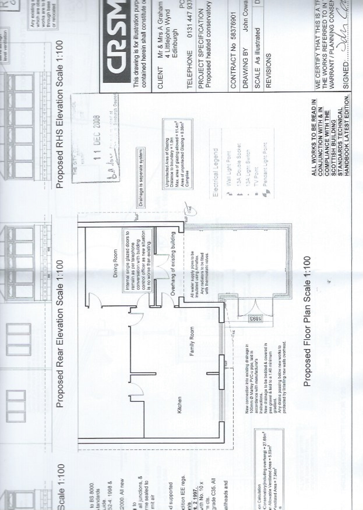

AliG Posted October 8, 2017 Share Posted October 8, 2017 I have sold my existing house, but none of the people who have previously done work on the house ever got the completions signed off. I am on Scottish regs. A couple of years ago BC came out and gave me a list of things to do. I had all of them done, but then when I called them out again recently a different person came and started asking more questions. I really need to get these things done in the next 4-6 weeks, we are supposed to complete on the sale on December 8th. I actually applied for the completions in April, but somehow the BC department lost the applications done over the internet and they didn't come until last month. Now they say they are waiting for the person who inspected the original work coming back from holiday to see what they say before they will issue the list of things needing done, they aren't exactly the easiest people to get hold of. The issues I think are. 1. Missing SVP - The drawings show a SVP terminating above the roof. They also show a Durgo AAV in an upstairs WC. connected to the same line. BC asked where the SVP was, is an AAV enough, or does every line need a SVP. There have been no issues with the drainage. 2. I had some work done on the kitchen that needed BC sign off. This meant I had to upgrade the smoke alarms from when the house was built. The alarm company have fitted a smoke alarm. BC asked for the spec, I am thinking it maybe has to be a heat detector? 3. The games room drawings show two smoke detectors, but only one has been fitted. I cannot find anything in the regs that would suggest I need two. 4. There is a downpipes that goes through the garage it enters the front wall of the extension goes through the garage then exits the side wall before going down to ground level. I am sure it was agreed to by BC at the time and the previous inspector said nothing but the new inspector has brought it up again. She said that she wasn't sure if it was allowed. 5. Loose banister - I have tightened it up by, not clear how solid it needs to be. I think the main issue is number 1, I can always get new detectors added. If they change their mind on the downpipes there is no where else to put it except across the front of the house which would not be great. Thanks for any help Link to comment Share on other sites More sharing options...
Jeremy Harris Posted October 8, 2017 Share Posted October 8, 2017 How long ago was the work done? Last time we encountered this problem when selling a house, we just paid a one-off premium for an indemnity policy, IIRC it was around £150 or so. That was for no record of building regs compliance on two extensions that the previous owner had built - should have been picked up by our solicitor when we bought the house but wasn't. Link to comment Share on other sites More sharing options...
AliG Posted October 8, 2017 Author Share Posted October 8, 2017 There are 3 outstanding warrants, 2 from 2008 the extension and a larger conservatory and 1 from 2012, the kitchen. There was a 4th one for a new set of doors which was signed off straight away. I think you can apply for indemnity if there was no warrant ever applied for not sure if you can do the same if warrant was applied for but completion never received. I would rather get all fixed though as that will mean definitely no issue selling the house. My solicitor insisted that I had to have all the warrant drawings to go with the deeds of the house. I didn't know that was necessary. I just got them from the council. This is the first house I have ever had work done on, I didn't't really know what was involved at the time. I just thought that the builders got the completions when they were done. You live and learn. Link to comment Share on other sites More sharing options...

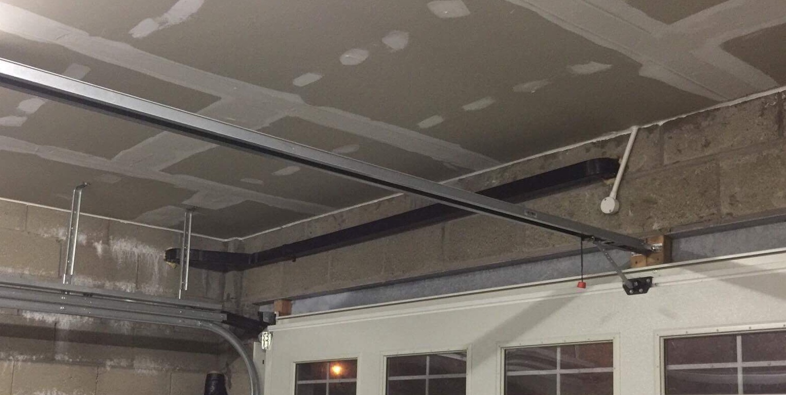

AliG Posted October 18, 2017 Author Share Posted October 18, 2017 I finally got a reply with a list of what needs done. Apparently my BC inspector is off sick but no one told me. Here is the list. Any help is most welcome. 1. The rain water pipe at the front of elevation has been duct through the garage. The rain water pipe requires to be waste quality and sealed joints. (Technical Standard 3.7) 2. Steps at garage as not as per the approved plans, please clarify the construction and it should be a permanent fixture. 3. Fire test certificate for the garage door. Technical Standards 2.2.4 requesting a minimum 30 minutes fire resistant rating to garage door) 4. The kitchen requires to be provided with a heat detector as indicated on approved warrant 12/00160/ALT. Heat detector to be interconnected with other detectors (smoke) if in place. 5. Provide a photograph of the stone gable vent. (08/02003/EXT) 6. Provide photographs as discussed. Eaves and ridge vents to all roof areas, and insulation to the garage wall. (08/02003/EXT) 7. Second smoke detector to be fitted in games room. (Under Technical Standard 2.11 smoke detectors are required to be a certain distance apart and also shown on approved plans (08/02003/EXT) 8. Door to toilet on the first floor is less than 800mm. (08/02003/EXT) 9. Final drain test at rear of house failed on the 4 April 2014, no further test has been carried out since (08/04783/ERECT) I am going to try and speak to the person who sent it who is the manager of the inspector who came out, but have a few questions. 1. There is a down pipe that goes through the garage. I don't understand the reference to Technical standard 3.7 as this is for wastewater pipes. I didn't think that a rainwater pipe was a wastewater pipe. If you read the standard it says that it applies when they go into a wastewater system but why would it need to be sealed like a wastewater pipe as it is just rainwater. 2. They could see the steps, this is just stupid. they are built from blockwork, concrete and concrete slabs and obviously not temporary. 3. The door has intumescent seals and a closer on it, it is clearly a fire door. 4. Fair enough 5. The approved plans had a stone gable vent on them, it's not there, I don;t know why not. I don't see why it would be needed. 6. Done and provided 7. I am checking this rule, I can fit another one if necessary. 8. I am not sure why this is an issue, it is on the first floor. 9. Annoyed, no one told me. Link to comment Share on other sites More sharing options...

Temp Posted October 18, 2017 Share Posted October 18, 2017 5 hours ago, AliG said: 1. There is a down pipe that goes through the garage. I don't understand the reference to Technical standard 3.7 as this is for wastewater pipes. I didn't think that a rainwater pipe was a wastewater pipe. If you read the standard it says that it applies when they go into a wastewater system but why would it need to be sealed like a wastewater pipe as it is just rainwater. I note they refer to sealed joints. Does this rainwater pipe go to a soakaway or into the sewer? If it goes into the sewer they might be worried about sewer gasses coming back up and leaking into the garage. Sewer gasses can contain methane and low oxygen levels (explosion and suffocation risk). Link to comment Share on other sites More sharing options...

AliG Posted October 18, 2017 Author Share Posted October 18, 2017 (edited) Thanks @Temp that is a good point, but as far as my reading of technical standard 3.7 goes it is only for wastewater pipes and this is a rain water pipe which is what I will put back to them. If I have to the pipes can be changed but it seems pointless. Thinking about it surely a rainwater pipe effectively vents to the outside anyway even if it passes through the house, but I can see this argument. It is not a combined system, but it does eventually enter the sewer system. I have already arranged a builder to come and do a new pressure test, my hope is it was just a bad test. I also called the people who built my conservatory. They could not find records of the test but are going to try and find out why it failed and sound like if it needs fixed they will try to do so. I don't know how much I can push back on BC, some if these issues seem an extreme reading of the rules and notably that it is almost impossible to get anyone on the phone to speak to them. Edited October 18, 2017 by AliG Link to comment Share on other sites More sharing options...
Temp Posted October 18, 2017 Share Posted October 18, 2017 Just now, AliG said: Thanks @Temp that is a good point, but as far as my reading of technical standard 3.7 goes it is only for wastewater pipes and this is a rain water pipe which is what I will put back to them. If I have to the pipes can be changed but it seems pointless. So there aren't any joints in the pipe? Joints in rainwater pipes aren't designed to be gas tight (the wind will just blow it away) but indoor waste water pipes have rubber seals. Link to comment Share on other sites More sharing options...
AliG Posted October 18, 2017 Author Share Posted October 18, 2017 There are joints, they are glued together, not with rubber seals, it might be reasonably easy to change the part of the pipe inside for a sealed one if necessary. You make a fair point that sewer gas could come back up the pipe, my argument was that as the top of the pipe is open to the outside where it attaches to the gutter then this is the path of least resistance so it would seem unlikely that gas would leak into the garage. I spoke to the architect and builder of my new house who had never come across this issue, but I will put your point back to them as it makes sense. Link to comment Share on other sites More sharing options...
AliG Posted October 18, 2017 Author Share Posted October 18, 2017 I got my wife to send a picture. I thought that maybe I could buy replacement downpipes that had rubber seals but they don't seem to exist. I think I can use one of these, a 68mm square rainwater to 110mm soil pipe adaptor at each end and then run 110mm soil pipe through the garage. This would give rubber seals within the garage. https://www.screwfix.com/p/floplast-rainwater-adaptor-110mm/38593?kpid=38593&ds_rl=1245250&gclid=EAIaIQobChMIveO42Pv61gIVg7vtCh1POwsmEAQYBSABEgI0VvD_BwE&gclsrc=aw.ds&dclid=CPTd7uP7-tYCFWWr7QodRpADEg#product_additional_details_container Link to comment Share on other sites More sharing options...
Jeremy Harris Posted October 18, 2017 Share Posted October 18, 2017 3 minutes ago, AliG said: I got my wife to send a picture. I thought that maybe I could buy replacement downpipes that had rubber seals but they don't seem to exist. I think I can use one of these, a 68mm square rainwater to 110mm soil pipe adaptor at each end and then run 110mm soil pipe through the garage. This would give rubber seals within the garage. https://www.screwfix.com/p/floplast-rainwater-adaptor-110mm/38593?kpid=38593&ds_rl=1245250&gclid=EAIaIQobChMIveO42Pv61gIVg7vtCh1POwsmEAQYBSABEgI0VvD_BwE&gclsrc=aw.ds&dclid=CPTd7uP7-tYCFWWr7QodRpADEg#product_additional_details_container Sounds like the standard solution to this problem. We had an extension where the main roof downpipe ended up being boxed inside a corner of the extension. The building inspector insisted that this pipe be a bit of 110mm soil pipe, so that it had proper seals, even though it was running to a soakaway. I think the logic is that rainwater downpipe never seals properly at the joints, even if glued, and a blockage at the lower end could result in water running inside the extension. Link to comment Share on other sites More sharing options...
AliG Posted October 18, 2017 Author Share Posted October 18, 2017 (edited) So looking at the picture, we attach one of the adaptors to the square rainwater pipe at each end. I am guessing the tails of the rainwater pipe might have to be replaced with longer pieces. Then at the left hand side two 90 degree bends which should take us to the wall above the garage door. At the right hand side another 90 degree bend and a straight pipe in between. My only slight concern is that it might be difficult to get the bend tight enough to the wall for the pipe not to end up floating in mid air. Now to figure out why I am being asked for a gable vent. The construction is warm roof, but there is an empty attic space between the roof and the room, would it need to be ventilated? My architect thought this was very odd. Now I think about it, the building is one and there quarter storeys, I wonder if the drawings are showing warm roof, but in fact that is only as far as the ceiling slopes, then it becomes a cold attic above the flat roof that needs to be ventilated. I have never been up there, I will have to go look at the weekend. This is when working in London is a real pain. Edited October 18, 2017 by AliG Link to comment Share on other sites More sharing options...
