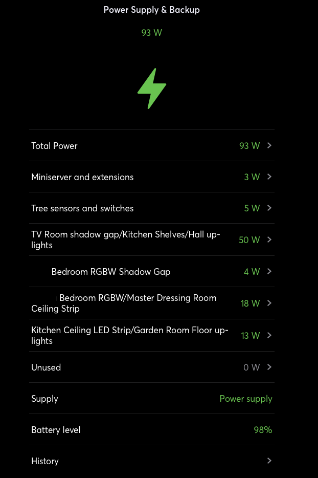

Thorfun Posted October 5 Author Share Posted October 5 batteries installed and 42Ah backup available. I like the reporting capabilities of the Power Supply and Backup on top of the whole 7 x PSUs in one unit. nice bit of kit. expensive, but nice! I'll test the battery backup during the day when the family aren't using their lights. 😉 Current usage is 93W so even if we maintained that in a power cut that would give us over 10hrs of 24V backup lighting. more than enough I think. what the reporting also shows is that we have loads of headroom on the PSUs. the ones with 10A fuses in them can take 240W so I could actually amalgamate some of the lights if I need more than the one spare output I have left. 1 Link to comment Share on other sites More sharing options...

Thorfun Posted November 17 Author Share Posted November 17 11 hours ago, Johnnyire said: Have you solar and a battery? I am building and installing Loxone. Was thinking I will get the Gateway with a Sigenergy system so can run the house if we lose power. I do have solar pv (10.5kWp array) and batteries (LuxPower with 6.4kWh storage) but the LuxPower has a max 13A on the EPS so we only have a few emergency items running from it in case of a power cut. I didn't want to put the whole house lights through it hence looking for 24V batteries so Loxone can run and can power the low voltage lighting which is enough to allow us to see in all rooms of the house if needed. I also found that the LuxPower is not quick enough to react to a power cut (despite what their manual says) and my computer equipment did not remain on in the last power trip we had. and so I have bought a dedicated UPS for that simply to keep the equipment going until the LuxPower kicks in. yet to test it in anger yet though but it should mean that our wifi and router remain active allowing me to wfh in a power cut. my advice is to make sure you know how much power the battery system for your whole house backup can run. 1 Link to comment Share on other sites More sharing options...
