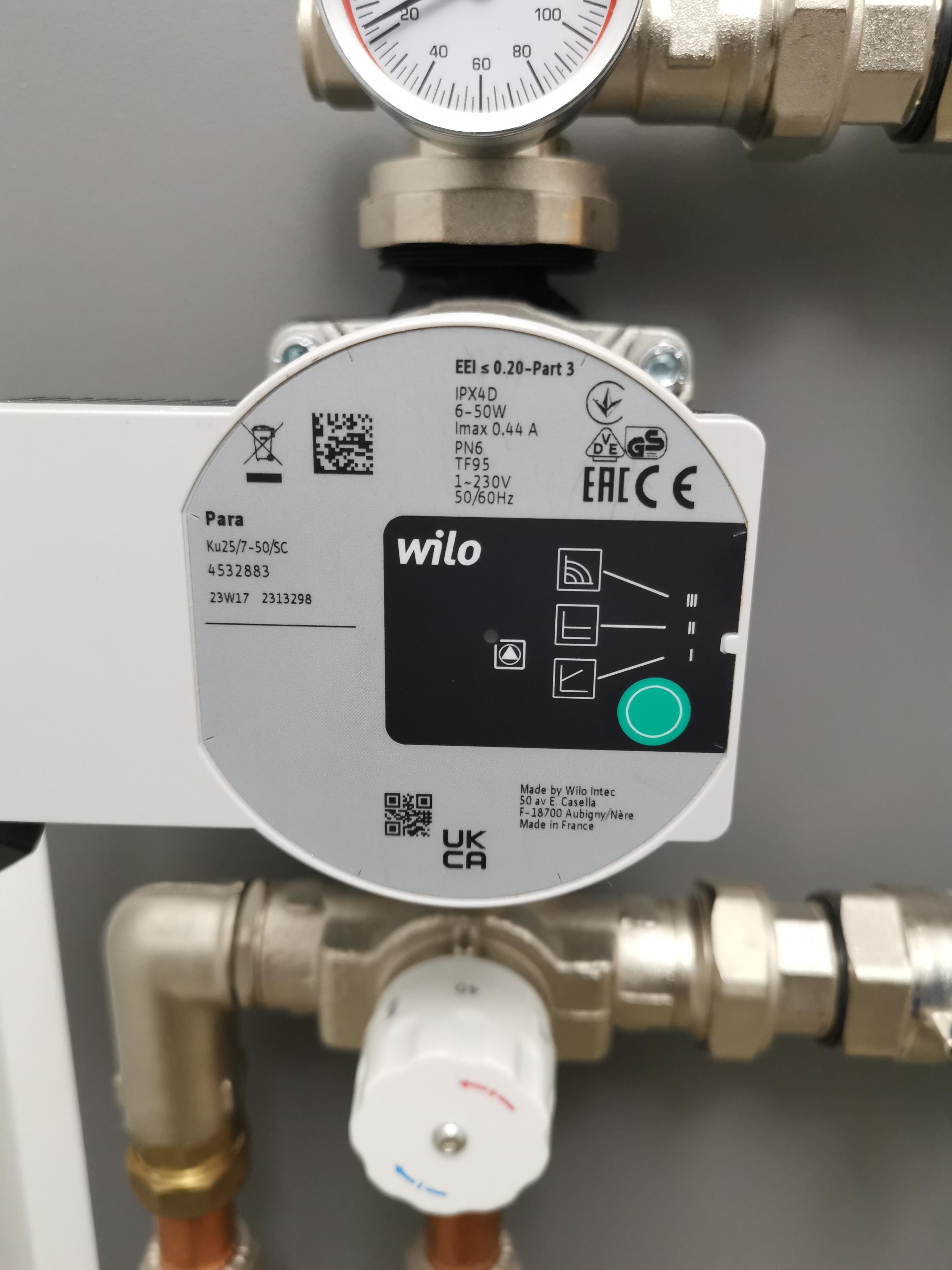

Super_Paulie Posted April 4, 2024 Posted April 4, 2024 Before I turn on the UFH system for the first time, does anyone have any suggestions on what settings to run the Wilo pump on? I'll be honest, the curves etc mean nothing to me so any helpful advice would be awesome. 4 loops, 2 zones, 400m, 16mm Pex-al-Pex, biscuit mix between joist, Wilo Para pump as in the picture. Pipes tested at 5bar. Thanks gents, much appreciated.
ProDave Posted April 4, 2024 Posted April 4, 2024 It's pointless looking at graphs and doing sums. Just try it, and aim to run it at the slowest (quietest) speed that will achieve the flow rate that you want. Good pumps those nice and quiet. 2
John Carroll Posted April 4, 2024 Posted April 4, 2024 (edited) Suggest the centre one, II, (constant pressure) there are three setting, i,ii & iii,, try ii for a start. Edited April 4, 2024 by John Carroll 1
Super_Paulie Posted April 4, 2024 Author Posted April 4, 2024 Thanks guys, I'll just have a play about. I have no idea what he curves are (the symbols) and what effect that would even have.
Nickfromwales Posted April 4, 2024 Posted April 4, 2024 3 minutes ago, Super_Paulie said: Thanks guys, I'll just have a play about. I have no idea what he curves are (the symbols) and what effect that would even have. You can't do any harm, so just work out what the lowest setting is that will maintain the room temps. Biggest question you should be asking right now, is what temp to set the mixing valve to Start off at 40oC and go up each day in 2oC increments until you are happy. Don't make adjustments in the same 24hr period, patience will pay dividends here 1

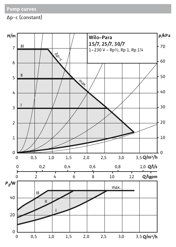

John Carroll Posted April 4, 2024 Posted April 4, 2024 (edited) The top icon (your pump, below) shows the pump in Constant Curve, CC, mode or better known in older pumps as constant speed, it has 3 settings, yours may be a 2M, 4.5M & 7M setting, corresponding to i,ii&iii, the higher the setting the greater the pump head and the greater the flow rate, its primarily used for radiators and sometimes UFH but the the second icon setting, Constant pressure or CP mode is generally recommended, the settings may be somewhat similar to the CC settings, the difference is that the pressure is held constant at whatever setting you set it to, the third icon shows Proportional Pressure or PP control where the pump head decreases with decreasing flow demand like rads fitted with TRVs, a example is my own, I have 8 rads on TRV control, I have the pump (Wilo Yonos Pico) set to PP 4.6M which gives me my required flowrate of 13LPM at a pump head of 3.5M, as the TRVs throttle down the pump (speed) and head reduce to ~ 2.8M resulting in reduced power consumption and no noise from the TRVs when well throttled down, power consumption varies from ~ 23 watts down to 14/16 watts. Edited April 4, 2024 by John Carroll 1
Super_Paulie Posted April 4, 2024 Author Posted April 4, 2024 22 minutes ago, John Carroll said: The top icon (your pump, below) shows the pump in Constant Curve, CC, mode or better known in older pumps as constant speed, it has 3 settings, yours may be a 2M, 4.5M & 7M setting, corresponding to i,ii&iii, the higher the setting the greater the pump head and the greater the flow rate, its primarily used for radiators and sometimes UFH but the the second icon setting, Constant pressure or CP mode is generally recommended, the settings may be somewhat similar to the CC settings, the difference is that the pressure is held constant at whatever setting you set it to, the third icon shows Proportional Pressure or PP control where the pump head decreases with decreasing flow demand like rads fitted with TRVs, a example is my own, I have 8 rads on TRV control, I have the pump (Wilo Yonos Pico) set to PP 4.6M which gives me my required flowrate of 13LPM at a pump head of 3.5M, as the TRVs throttle down the pump (speed) and head reduce to ~ 2.8M resulting in reduced power consumption and no noise from the TRVs when well throttled down, power consumption varies from ~ 23 watts down to 14/16 watts. Thanks a lot John, that's great knowledge and very welcome, appreciated. Looks like CP mode will do the job and I'll play with the speed and flow to get what I need. All coming together nicely 👌

John Carroll Posted April 6, 2024 Posted April 6, 2024 Whatever about the thermal mix. would suggest CPi setting at 3M initially, 3M (2.8) should be sufficient to circulate 3.0LPM through each 100M loop, total 12.0LPM, 0.72m3/hr, as long as there is a bit of adjustment left in the (max) flow loop regulator then its fine, if not, go to CPii, 5M setting. In practice, the flow requirement will probably be less than 3.0LPM/loop. "4 loops, 2 zones, 400m, 16mm Pex-al-Pex, biscuit mix between joist, Wilo Para pump as in the picture. Pipes tested at 5bar." 1
