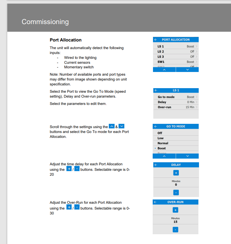

Our unit uses volt free momentary switch and it starts a rundown timer. But once the house is dried out, you really don't need to boost. Something smelly in the kitchen we boost, and maybe when having the annual bath, don't bother after shower.

I think I could quite easily live with having a setup like that, let the unit decide what it wants to do most the time, but have a couple of switches that boost for a period of time.  Just picking through the commissioning guide now to see if I can set a timer on the volt free.
