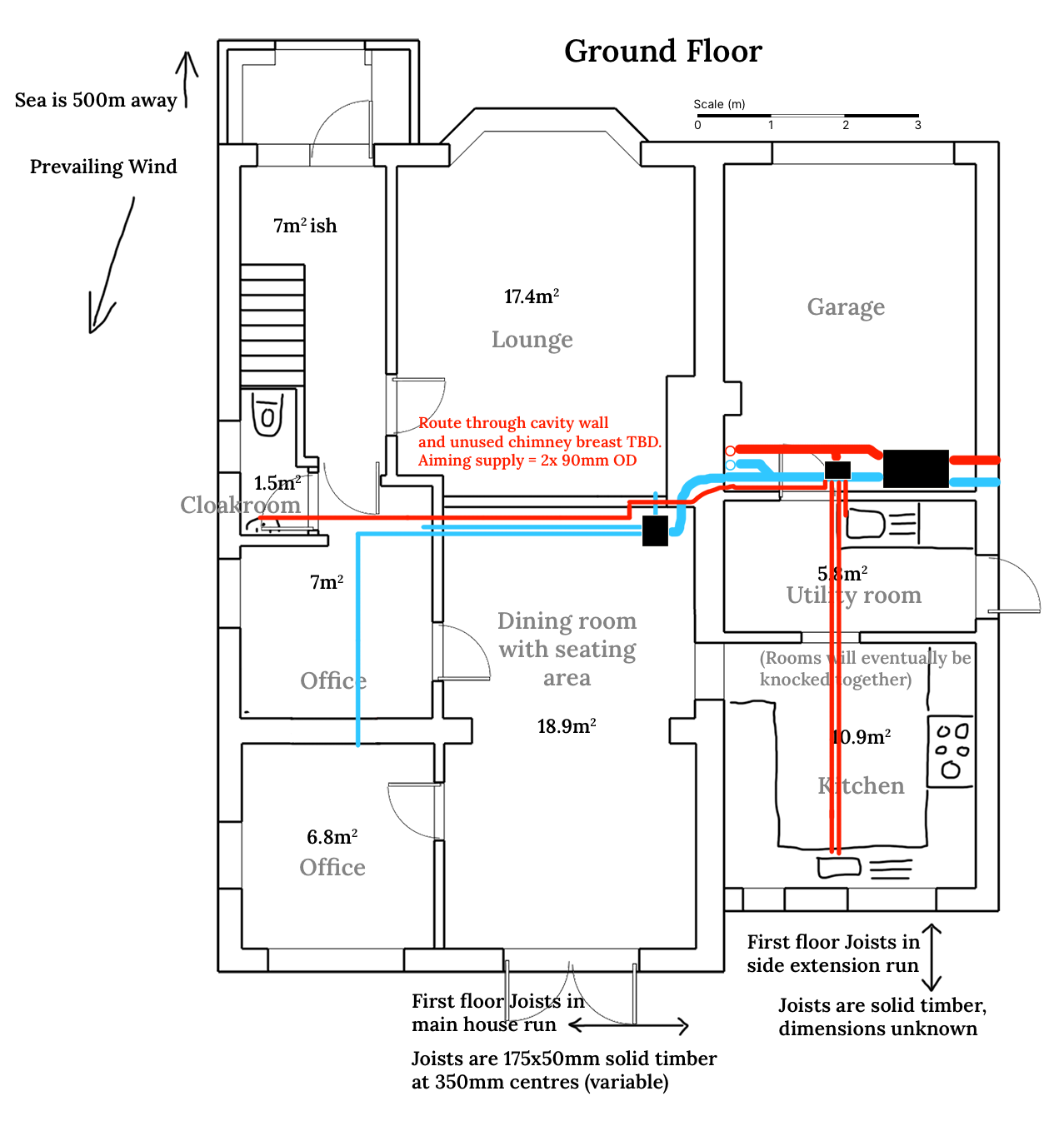

After my last ask, we've negotiated with the neighbours to redirect their boiler flue so we can put the MVHR in the most logical place: the garage. I've also compromised by putting upstairs ducting in the cold loft. This has simplified things:

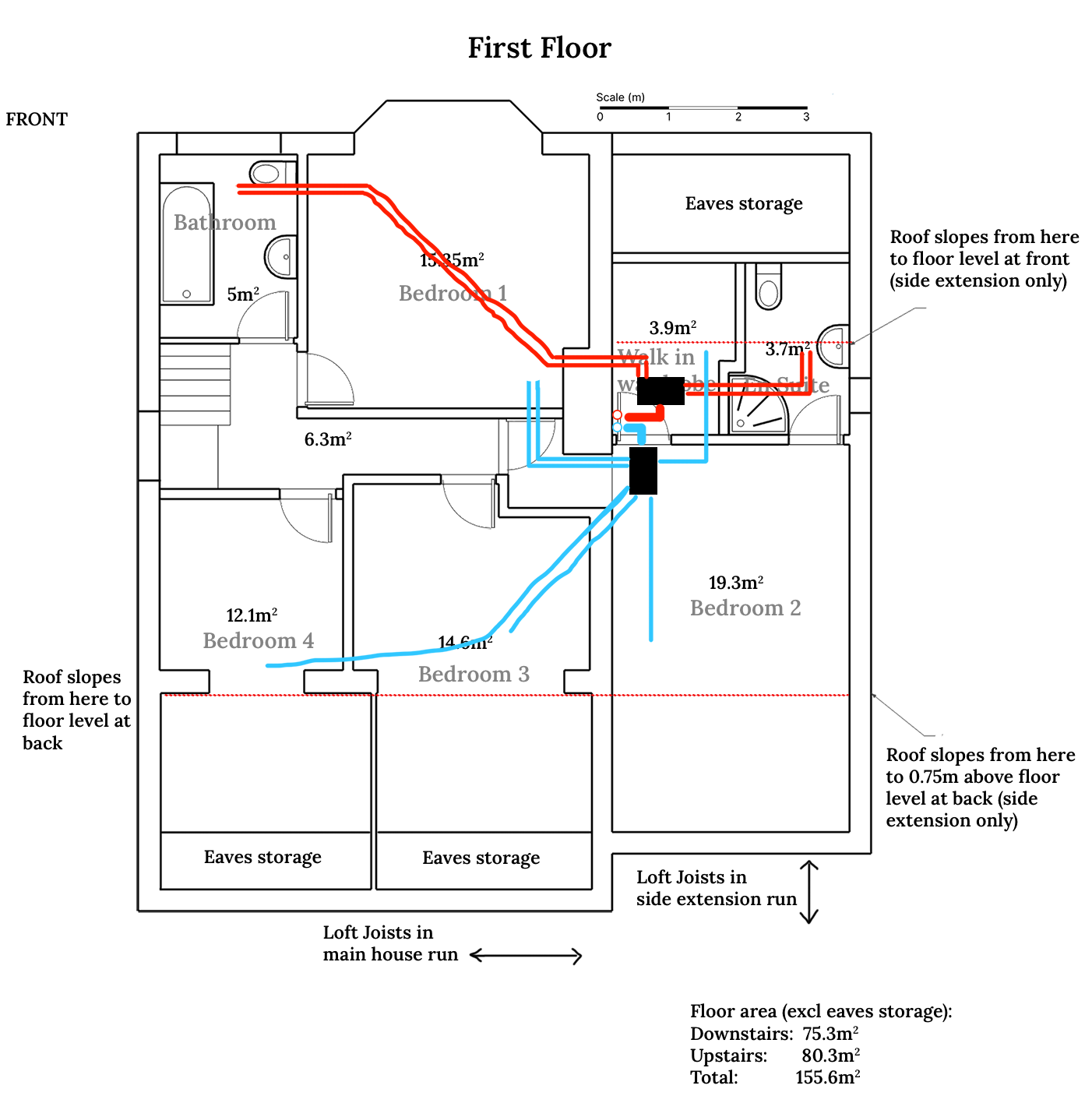

Upstairs
  • I've compromised by putting ducts in the cold loft outside the thermal envelope, as my wife is 100% against any boxing in
  • The loft is well ventilated at all eaves (anywhere there is a fat wall on the plan)
    • Positioning supply away from doors makes the pipes run close to vented eaves, so more exposed to cold air in winter. Best compromise is to keep pipes warmer and put near doors?
Between floors
  • I've gone for separate distribution boxes on each floor, to minimise number of penetrations into cold loft (airtightness). This is open to negotiation.
  • The chimney breast has wood frame round it supporting floor joists, so cannot drill straight through in ceiling void - has to be within the downstairs room
Downstairs

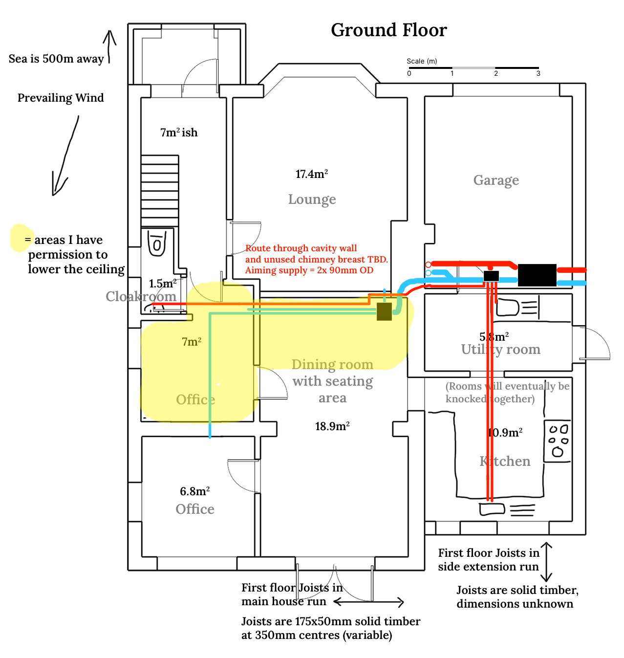

  • Got permission to lower part of the ceiling in the dining room & hall to hide ducting
  • Need to sort route to downstairs cloakroom - an annoying run to the other side of the house
  • Have to get the ducts through an external wall + chimney breast into main house
  • No duct to dining room - assuming the flow through from the office & lounge will be enough ventilation
MVHR
  • Compromised by putting outside thermal envelope in unheated garage
  • Will build insulated "plant room" around it with 100mm PIR to protect from temperature fluctuations
  • Fire safety requirements?
    • Can mitigate with 2x plasterboard boxing in the MVHR and ducts?

  1. Downstairs has v little supply, despite people being down there 15 hours/day. Bedrooms having more seems wrong?
  2. The utility room and kitchen are effectively a single room (no door between them). Worth reducing utility room extract so the kitchen clears more easily?
  3. I am stuck with how to treat duct length for pressure drop figures - do I calculate it from the MVHR to each plenum, or do MVHR to first splitter / splitter to distribution box / distribution box to plenum?

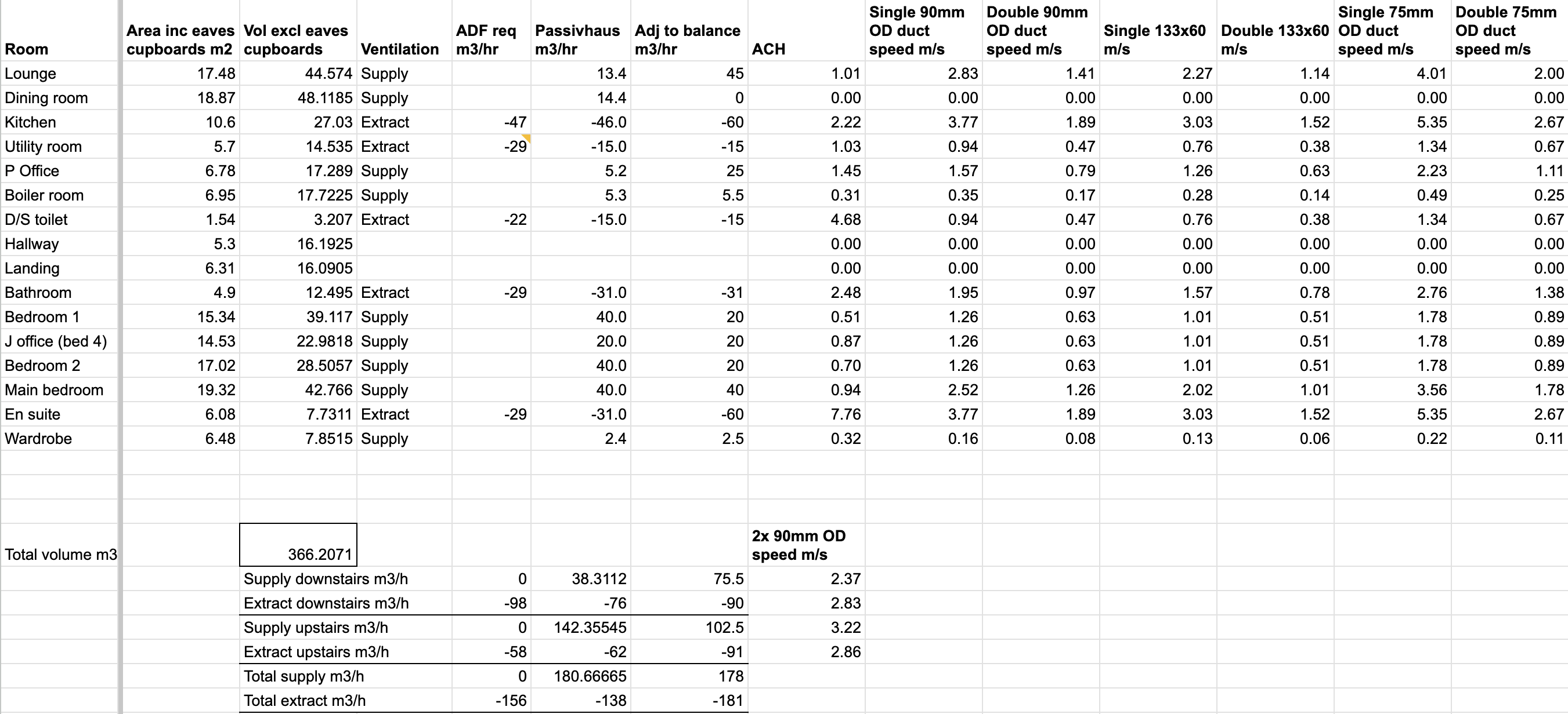

  4. Correctly sizing the ducts between ground floor and loft distribution box, and to the Dining room distribution box, is going to be crucial. Does 2x 90mm OD for each of these seem right?
  5. How do I best make the loft penetrations airtight? Sealing multiple circular ducts to the ceiling so there are no leaks looks a challenge

You could do a cascade system downstairs to simplify duct routes etc.
Downstairs, supply air to lounge, via 2x coanda nozzles, high on wall next to dining room. A further outlet would be to office (7m2). The 6.8m2 office would have a transfer fan in the wall from first office to second office). This could be a dMEV type fan or something like this which works on demand only.
https://www.ventilationland.co.uk/en_GB/p/brink-indoor-mixfan-co2-controlled--up-to-70-mh/17927/
Extracts leave as you have them.
Upstairs leave as is.
Flow rates, you need to balance overall flow and extract - you don't need to balance downstairs/upstairs extract and supply by floor, any excess will go via the stairs.
With two people in the house your flow rates overall can be 0.3ACH or slightly lower.
Coanda nozzles high on wall looks like this (my lounge made by zehnder) and fit direct onto 90mm duct.

The transfer fan is something I can't add though as due to the nature of our work clients need privacy, and I think that fan would break soundproofing. A separate supply to the 6.8m2 office is the best alternative?
Oh good, I thought I had to balance each floor.
Great to see what a coanda nozzle looks like, that will blend in nicely with what's planned for that lounge wall.
Yes

The big question/issue  for me is the detailed routing of the ducts, particularly  downstairs, in locations where you haven't negotiated "permission" to reduce ceiling height. There is still a lot of investigation and detailed work to be done to ensure that you are able to make penetrations in floor joists  without compromising structural integrity BEFORE you start installation.
That's my bad, downstairs I've got permission to lower ceilings as the ceilings are higher to begin with / the rooms don't have sloping ceilings cutting into their height.
I do need to find out if in the 30cm side of chimney breast I can drill 2x 9cm holes for the ducting (as drawn above) without weakening it. If not then I need a big rethink for how to get from the garage to the dining room.
I've updated my spreadsheet, and it looks like 90mm single/double runs will cover all, while double 75mm would break the 2.5m/s rule for the kitchen and en suite extracts.
To connect downstairs to upstairs I think something larger than 2x90mm is going to be needed, given those speeds for the full supply and extract volume.

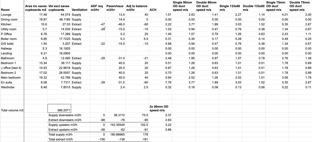

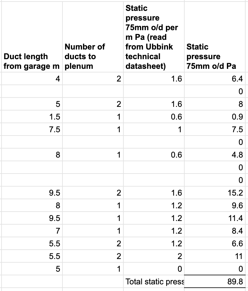

Am I correct in thinking that when you do a radial ducting system it's the max pressure drop of any of the ducts that matters, not the sum of all the pressure drops?
A simple calculation on duct length and flow (assuming straight ducts) gives:
The total static pressure is getting close to what a well designed system should have as its max, before adding plenums, bends and more, so I'm assuming I've done something wrong.
Max drop of the worst duct run from MVHR outlet to and including the outlet nozzle / terminal. As this run will also determine your fan running speed the nozzle should be in the fully open position, so its lowest pressure drop.

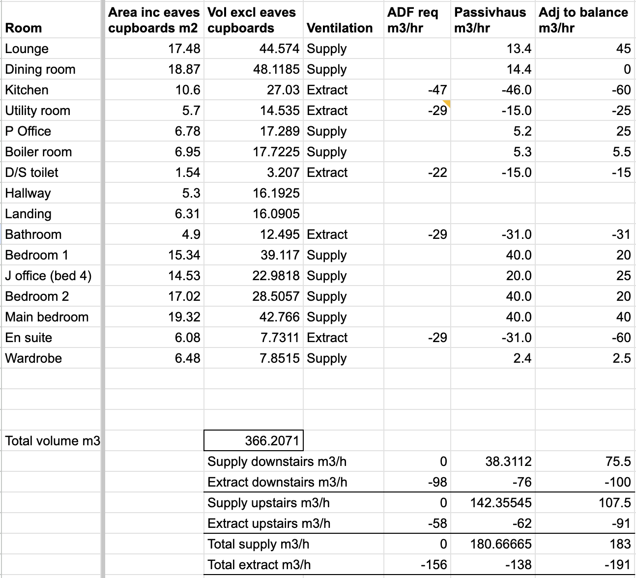

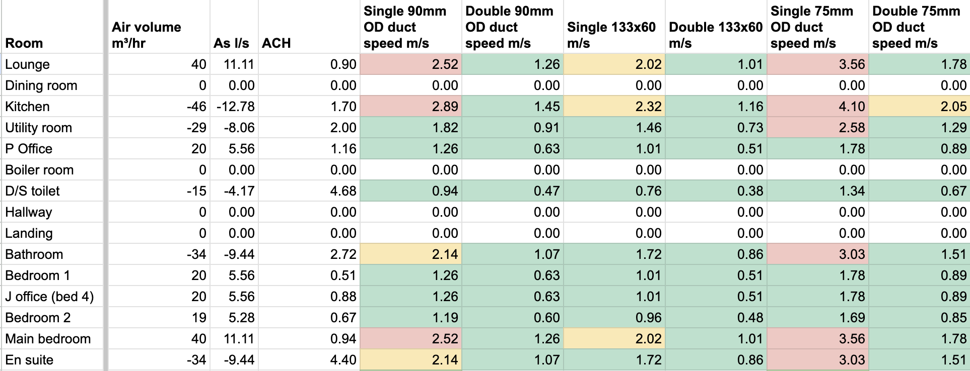

Latest update: I've redone the floor area reducing it for the skeilings, excluding areas under 1m in height and taking 50% of the floor area for areas 1m-2m high. 50% seems to be the done thing, but makes that part have an effective ceiling height of 3m instead of the 2.5m elsewhere 🤷🏻‍♂️
That gives a floor area of 142m² (previously 162m²)
ADF for a 4 bed (Table 1.3) = 133.2m³/h
ADF on floor area (1.24a): 154m³/h
ADF boost extract rates (Table 1.2): 156m³/h
And 0.33ACH of the volume is 120.6m³/h
So designing for a minimum ventilation rate of 154m³/h:
This gives distribution of (downstairs = lounge/P office, upstairs = bedrooms)
For 2 of us in the house I expect to need to turn this down (based on forum members' experiences), but I think we should still have 40m³/h into our bedroom which will need it rebalancing. We will see.

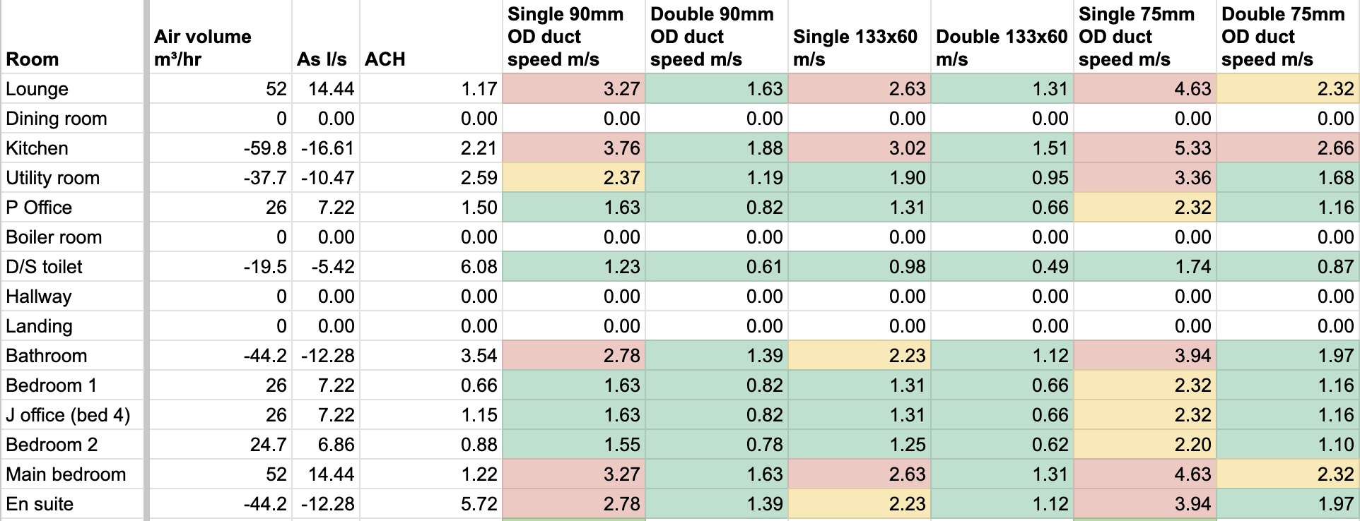

Nevertheless, I thought I'd best calculate a boost mode. I arbitrarily chose 1.3x (the Passivhaus figure is 1.42x). This results in:
with distribution as
Should I keep boost mode under 2.5m/s? If I should, Boost mode means doubling more duct runs.
