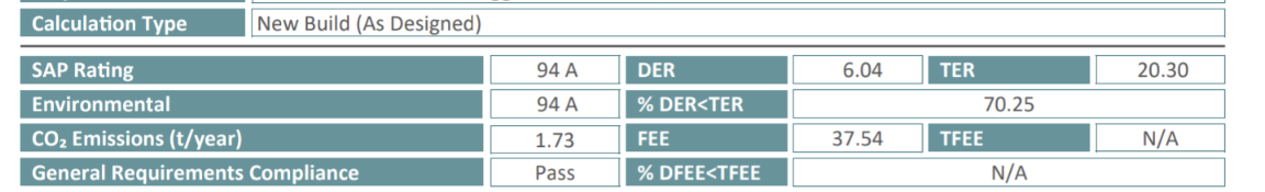

MR10 Posted April 2 Share Posted April 2 4 hours ago, Raine said: All understood, but I need to include the relevant figures in my energy statement, which I can't do if I don't know which is which. Mine was in the design u value calculation, see image below. I just took the figure next to the %DER<TER and included it in my energy statement. Link to comment Share on other sites More sharing options...

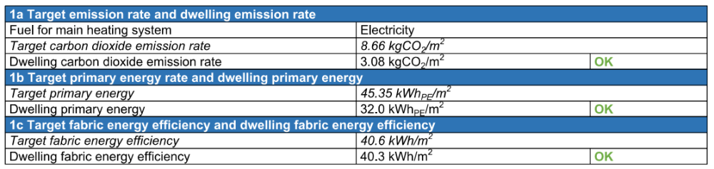

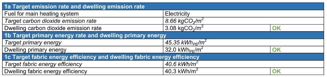

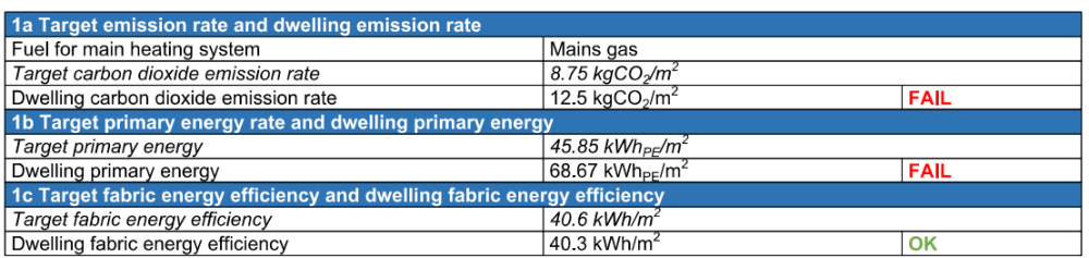

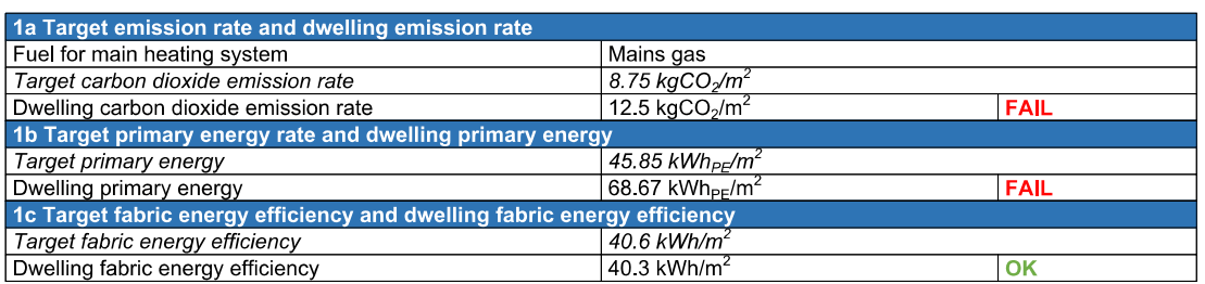

Raine Posted April 2 Author Share Posted April 2 This is from the doc named "baseline": This is from the doc named "as proposed": I was expecting either one or two TERs (one for 2022 Regs and possibly also one for the Planning requirement of 40% improvement) and one DER. There are two TERs, but the lower figure isn't a 40% improvement on the higher figure, so I don't know what they are. And there are two DERs, and I have no idea why, other than I presume the lower figure is my proposal, as he said it passes. Is it just me, or is this hard / impossible to figure out what's what without being told? I know you all say "forget it and move on", but I'm the type of person who likes to understand things (not every detail, but at least to some extent), and also, I might want to down-spec a bit to save costs in some areas. Link to comment Share on other sites More sharing options...
ADLIan Posted April 3 Share Posted April 3 I'm not sure exactly what is being shown there. The 'baseline' may be the 'notional' building used as the benchmark to compare your actual proposed dwelling (see Table 1.1 in AD L1). As mentioned before the Planners will look at this very simply (unless they have more detailed requirements which is doubtful). The important numbers are those for your 'proposed' house - a 40% reduction in the DER here is normally sufficient for the Planners. I note the main fuel is electricity do you have lots of solar PV or using a heat pump to get the CO2 emissions down? Link to comment Share on other sites More sharing options...
