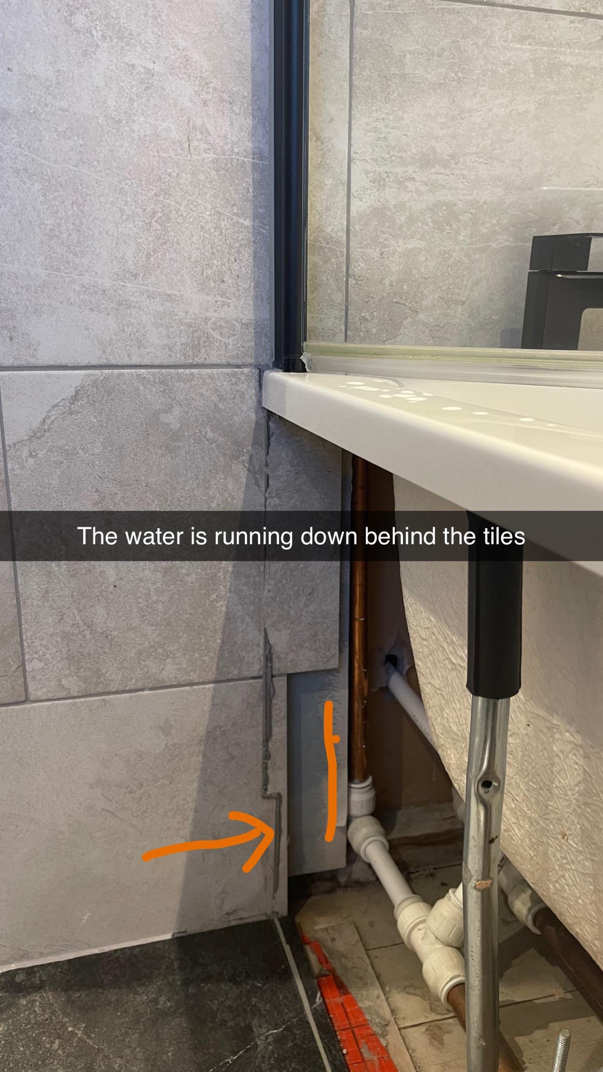

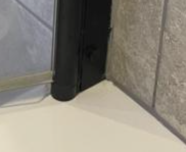

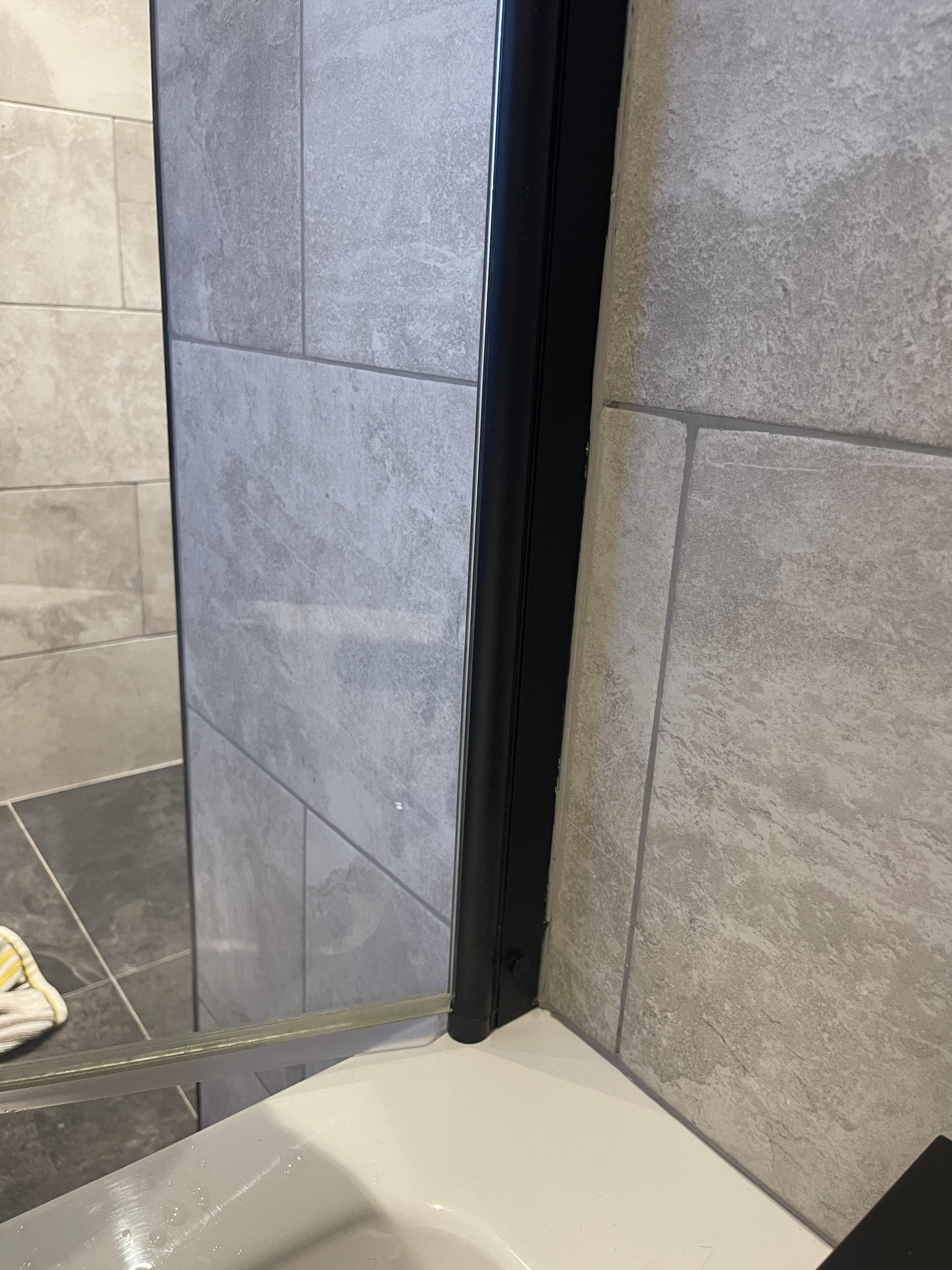

Faiza Posted March 24 Share Posted March 24 Hi, please can someone help with some bath screen leak advice. we have had our bathroom done few months ago. We have had a leak, after taking the bath panel off, we noticed the water was running down from behind the wall. The plumber has come 3 times now and played around with the screen but we still have the same issue. I will attach some pictures, if anyone has any idea what it could be. Thank you. Link to comment Share on other sites More sharing options...

MikeSharp01 Posted March 24 Share Posted March 24 That is then very weird. So the problem is here: Can you put a spirit level on the bath edge and see if it sloping towards or away from the wall - because to get behind the tiles it MUST be getting through them either directly - some tiles can be porous, or the grout - more likely. So I suspect the bath edge is slightly sloped towards the wall causing the water to flow under the hinge and behind that there is a hole in the grout that is letting the water through and behind the tiles where it runs down and out as you have indicated. Has the plumber take the hinge off to look? 1 Link to comment Share on other sites More sharing options...
joe90 Posted March 24 Share Posted March 24 IMO that screen needs to come off, for water to “pour through” rather than be damp something is seriously wrong. Link to comment Share on other sites More sharing options...
markc Posted March 24 Share Posted March 24 32 minutes ago, joe90 said: IMO that screen needs to come off, for water to “pour through” rather than be damp something is seriously wrong. +1 I reckon the tile line is not fully grouted or sealed behind the screen rail allowing water to go behind the tiles 2 Link to comment Share on other sites More sharing options...

BotusBuild Posted March 25 Share Posted March 25 .. and before you re-apply the sealant, make sure the surfaces are VERY clean and dry, and then wipe them over with some methylated spirit to remove any "grease" from fingers. Let that evaporate off naturally (leave it for 5-10 minutes to be sure) Link to comment Share on other sites More sharing options...

Mr Punter Posted March 25 Share Posted March 25 I have seen similar on a shower. The tray was fitted, then tiled and grouted, then the screen fitted, then all siliconed. The tiler leaves out the grout around the top of the bath/shower so it can be siliconed after the screen goes on. When the screen profile is fitted, the small bit at bottom ends up with no grout or silicone. You need to take off the wall profile (a bit of a ball ache) and either grout or silicone the bottom, then refit. Link to comment Share on other sites More sharing options...
