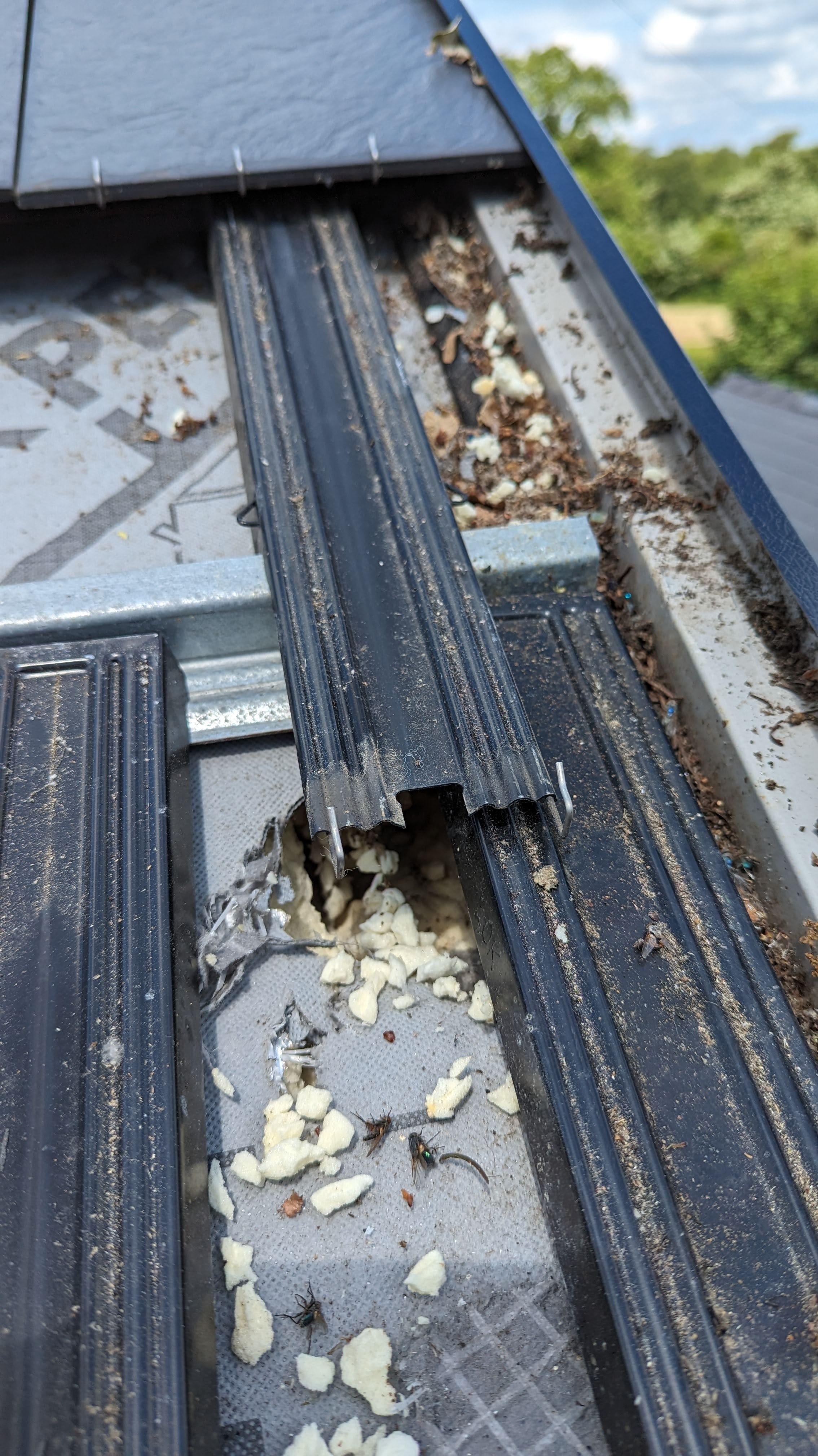

ToughButterCup Posted March 20, 2024 Posted March 20, 2024 2 hours ago, David001 said: .... My feeling is that to ensure no creatures can get behind the cladding, the unplanned gaps (marked in green on the photos) should be filled with black filler or black foam, and that every metre or two along the top-most board a couple of wide holes should be drilled and then covered with a rain-proof and insect-proof vent cover, to allow moisture and warm air to escape. Could not agree more. Here's why I agree. And I can't say @Russell griffiths didn't warn me. 1

David001 Posted March 21, 2024 Author Posted March 21, 2024 Many thanks, @ToughButterCup and @Kelvin. After reading your replies and then doing some research online I have decided that I will request the builder to fill all the gaps, to ensure no ingress of any form of wildlife. However, after having read that professional Canadian housebuilders don't believe in ventilating at the top of such cladding, and because there is no observable deterioration in the cladding that was added to my house's modern extension 12 years ago, I won't insist on vents being fitted to the top of the cladding currently being added to the other part of the house. @ToughButterCup, thanks for your photo of the damage done by insects. I can't afford for any creatures to nibble into the delicate silver-foiled blanketing on the other side of the cladding. How tempting it would be for them to snuggle inside it in the winter - and possibly break the thermal seal that is costing us thousands!
ToughButterCup Posted March 30, 2024 Posted March 30, 2024 That's no insect @David001, that was a rat. Just the one. That rat is now a has been rat. An ex rat. An is no more rat. A dead rat. We are now armed with 3 tomcats, a visiting Terrier Rat Pack, poison boxes and a decent Weihrauch rifle with an expensive night sight. Our sheep dog will spend a happy hour or two digging any newbies out of their nests. In proportion to the damage that rats can cause, we just about break even. Which reminds me: agenda for today, blocking all recent holes bar one. And then a simple water, bicarb and acetic acid bomb in the remaining hole. The resulting CO2 rocks them gently to sleep. I hope. In case you're interested, 200 ml bicarb, 200ml acetic acid 200ml water in old plastic bottle. Screw top tight shut. Shove in hole. Block hole. Hard. The reaction causes large volumes of CO2. Bottle bursts. Rats nest flooded with CO2. Rats die ( lose consciousness first then die) or leg it elsewhere. Yes hit and miss, probably miss more than hit. No one technique works with rats. After the initial explosion, rats that escape from holes I've missed are fair game for Tess. And other canine guests.
