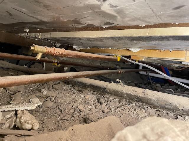

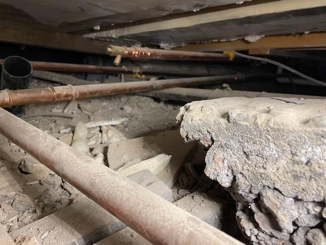

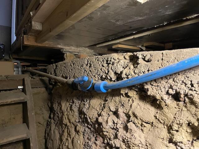

nmh Posted March 19, 2024 Share Posted March 19, 2024 Finished major renovation on a Victorian semi. These pictures show the mains water pipe (new in blue and attached to new copper piping) and some of the new copper piping under the ground floor. Photos taken from stairs into cellar - so these are the lowest pipes in the house. Some are in 'hangers' - but some look to be unsupported - especially longer copper pipes. Is this ok? Or is this a very lazy builder causing me issues later down the track? Any help much appreciated. Link to comment Share on other sites More sharing options...
Russell griffiths Posted March 19, 2024 Share Posted March 19, 2024 Nope that’s shit. clipped and supported every 600mm I would say. and what about insulation, it should all be insulated if it’s under a floor. look up some regs it will give you the correct support spacing. Link to comment Share on other sites More sharing options...

deancatherine09 Posted March 19, 2024 Share Posted March 19, 2024 That's very poor Ours are all clipped at 600mm centres and fully insulated. Link to comment Share on other sites More sharing options...

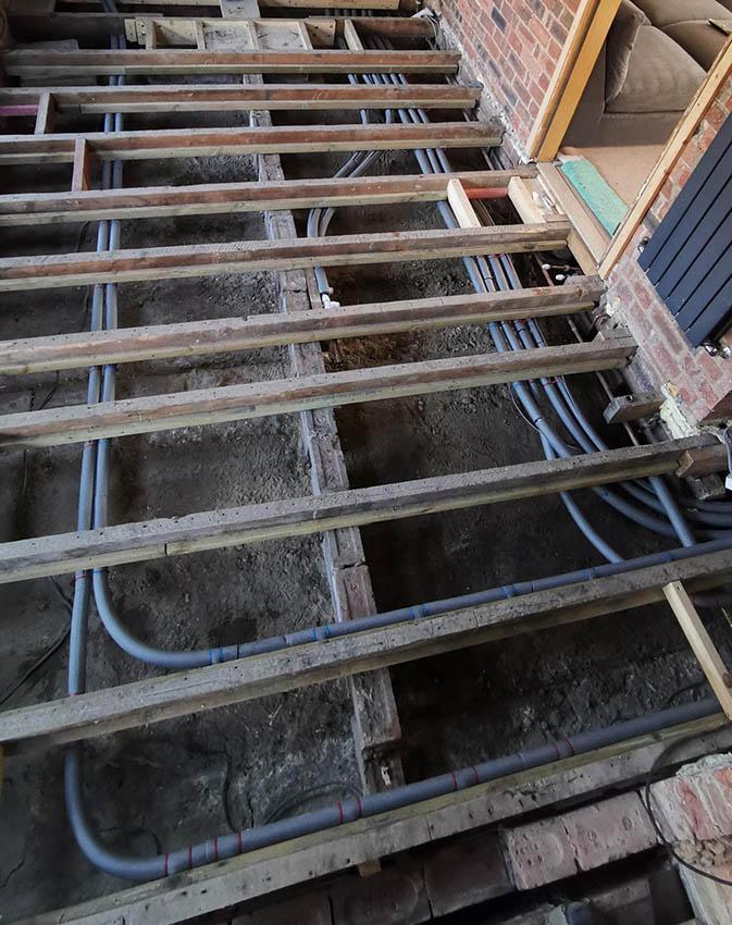

Super_Paulie Posted March 19, 2024 Share Posted March 19, 2024 ah man, thats not great... in the void its basically outside temperatures, pipes need lagging to stop freezing. Also supported to stop water hammer and generally good practice. A minor gripe that they have used a yellow talon which would indicate gas but thats the least of your worries there. Heres a shot of mine that i did last winter but i think you know the answer to your own question im afraid 😞 Link to comment Share on other sites More sharing options...
nmh Posted March 19, 2024 Author Share Posted March 19, 2024 Thanks for this - yes we can often hear some water hammer in the pipes above the kitchen ceiling for the bathroom up there - but they're now covered. Can this be remedied without pulling floors up?? Link to comment Share on other sites More sharing options...
Super_Paulie Posted March 19, 2024 Share Posted March 19, 2024 im not entirely sure, you'll have to use a bit of improvisation. At the very least id clip that MDPE pipe to that concrete wall. If its a cellar and not exposed to the outside temperatures im sure it'll be fine freezing-wise but if thats unlagged heating pipes then its a really poor show. Its an awful job from an awful plumber im my opinion. 1 Link to comment Share on other sites More sharing options...

Crunchynut Posted March 19, 2024 Share Posted March 19, 2024 (edited) What are the blue and red pipes/cables in the background? Edited March 19, 2024 by Crunchynut Link to comment Share on other sites More sharing options...
nmh Posted March 20, 2024 Author Share Posted March 20, 2024 Pretty sure the blue and red pipes are cold and hot water pipes Link to comment Share on other sites More sharing options...
