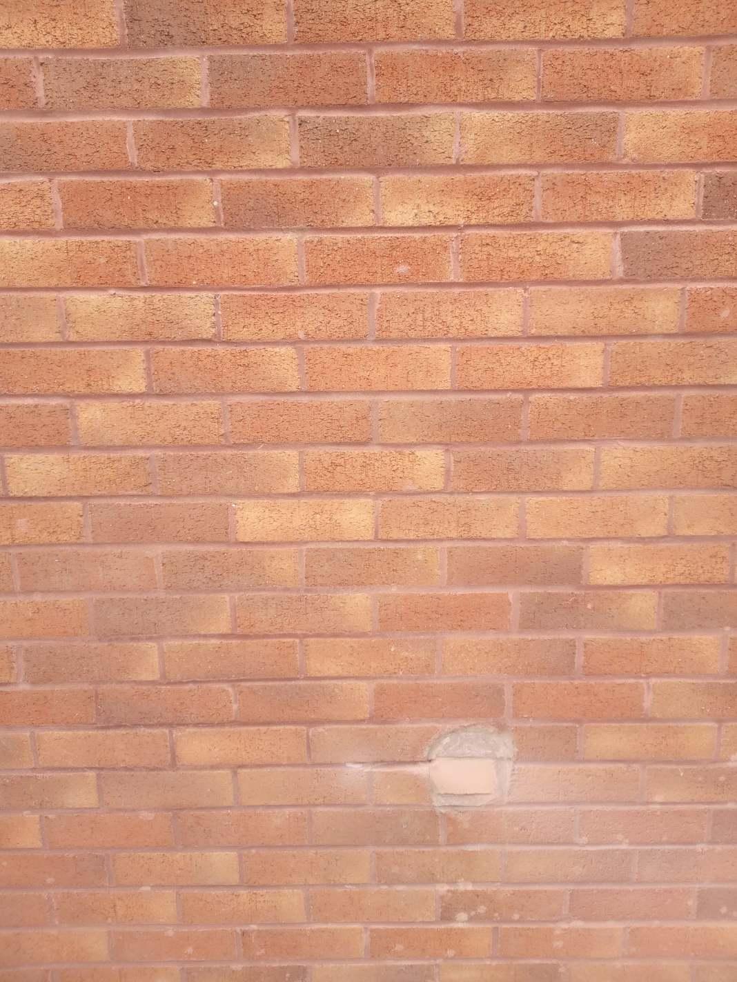

Stu84 Posted March 18, 2024 Posted March 18, 2024 Hi everyone. First post here. Great to be part of this friendly forum, lots of amazing info. I'm designing my own small side extension. A lean-to 4x3m. Looking to use wall starter kits and a ledger board to hold the rafters. Only thing is my bricks are vertically perforated, not solid right through. It's a 90s house so they aren't soft, but I don't know the brick type nor their compressive strength (more compressive strength = better resistance to anchor breaking through the side of the brick under load) The chemical anchors by Fischer seem on paper like a good option. This involves inserting a plastic sleeve with holes. You fill with resin which expands through the holes of the sleeve and push threaded bar in. I guess the resin bonds to bits of brick/mortar and also increases pull-out surface area. Anybody have any experience of this type of anchor in perforated facing bricks? Other ideas welcome. I'm trying to avoid tooth brickwork. I suppose I could replace a number of bricks with solid ones, but it would be quite a number all said and told. I'm hoping the wall starters don't take much load. Aren't they mainly to resist wind loading? It's the ledger board and roof weight I'm more concerned about. Thanks all Stuart

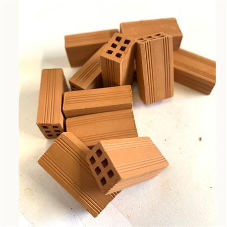

saveasteading Posted March 18, 2024 Posted March 18, 2024 I'm assuming you have this. Which is the UK style. these are usually engineering bricks so very hard. The holes are often about 25mm dia. I'd use a new and branded drill bit to minimise bashing. I think there is plenty of info on the wrappers of the gauze inserts.

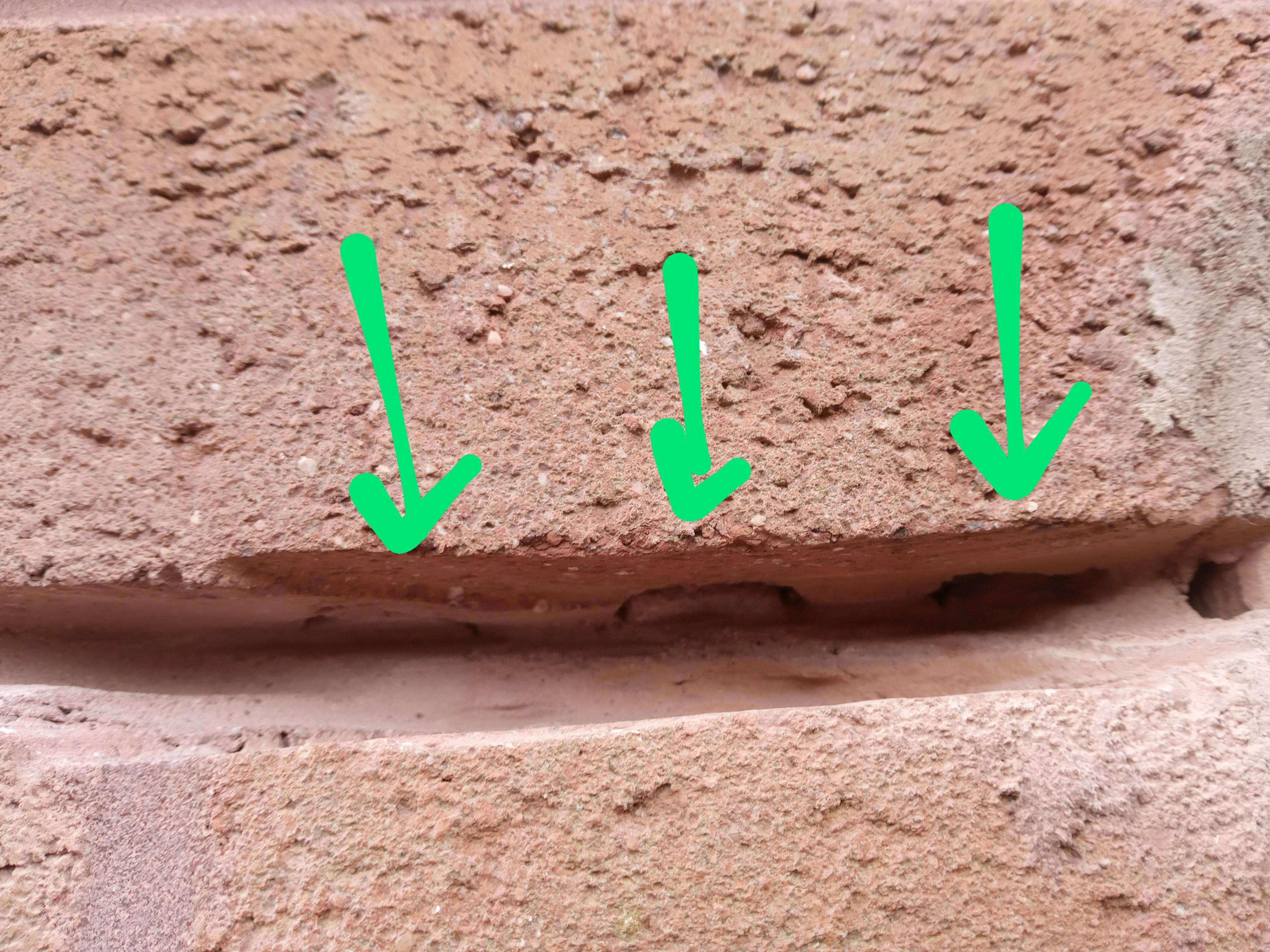

Stu84 Posted March 18, 2024 Author Posted March 18, 2024 33 minutes ago, saveasteading said: I'm assuming you have this. Which is the UK style. these are usually engineering bricks so very hard. The holes are often about 25mm dia. I'd use a new and branded drill bit to minimise bashing. I think there is plenty of info on the wrappers of the gauze inserts. Just raked out part of a bed joint. Seems I have the bricks with ten holes (2 rows of 5). Going to head to merchant see if I can find the same bricks and then will order some resin and experiment. Any brick ID pros? It's a rustic finish, 10 holes, and there are multiple thin scribe lines on the back side (cavity side) of the brick, perhaps to speed up breaking them to length? Or maybe to encourage rain that has got through to dribble down the outer leaf? Just guessing. House built '92. Thanks
Russell griffiths Posted March 18, 2024 Posted March 18, 2024 @Stu84 they are just normal face bricks, we are assuming you meant hollow clay blocks like they use abroad. no sleeves needed, resin anchor and away you go. the starter profile will just need the screws and plugs they supply.
Stu84 Posted March 18, 2024 Author Posted March 18, 2024 1 hour ago, Russell griffiths said: @Stu84 they are just normal face bricks, we are assuming you meant hollow clay blocks like they use abroad. no sleeves needed, resin anchor and away you go. the starter profile will just need the screws and plugs they supply. I'll take that. Thank you. Yea I didn't really know what to call them. They are facing bricks, made of clay, with holes but perhaps not quite as much air as the EU bricks!
