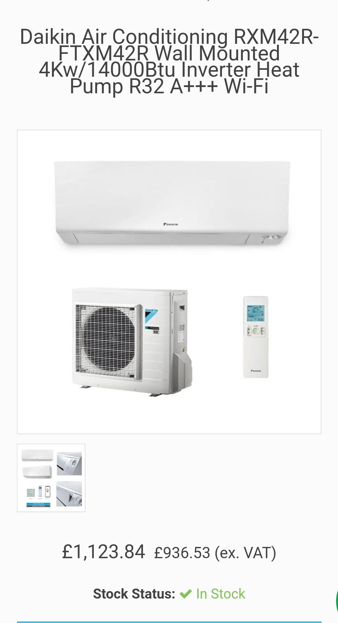

Iceverge Posted March 17 Share Posted March 17 I'd be tempted to keep the gas boiler and install a few slimline vertical rads. Or if you really want an ASHP just get a good A2A unit like this. Link to comment Share on other sites More sharing options...
