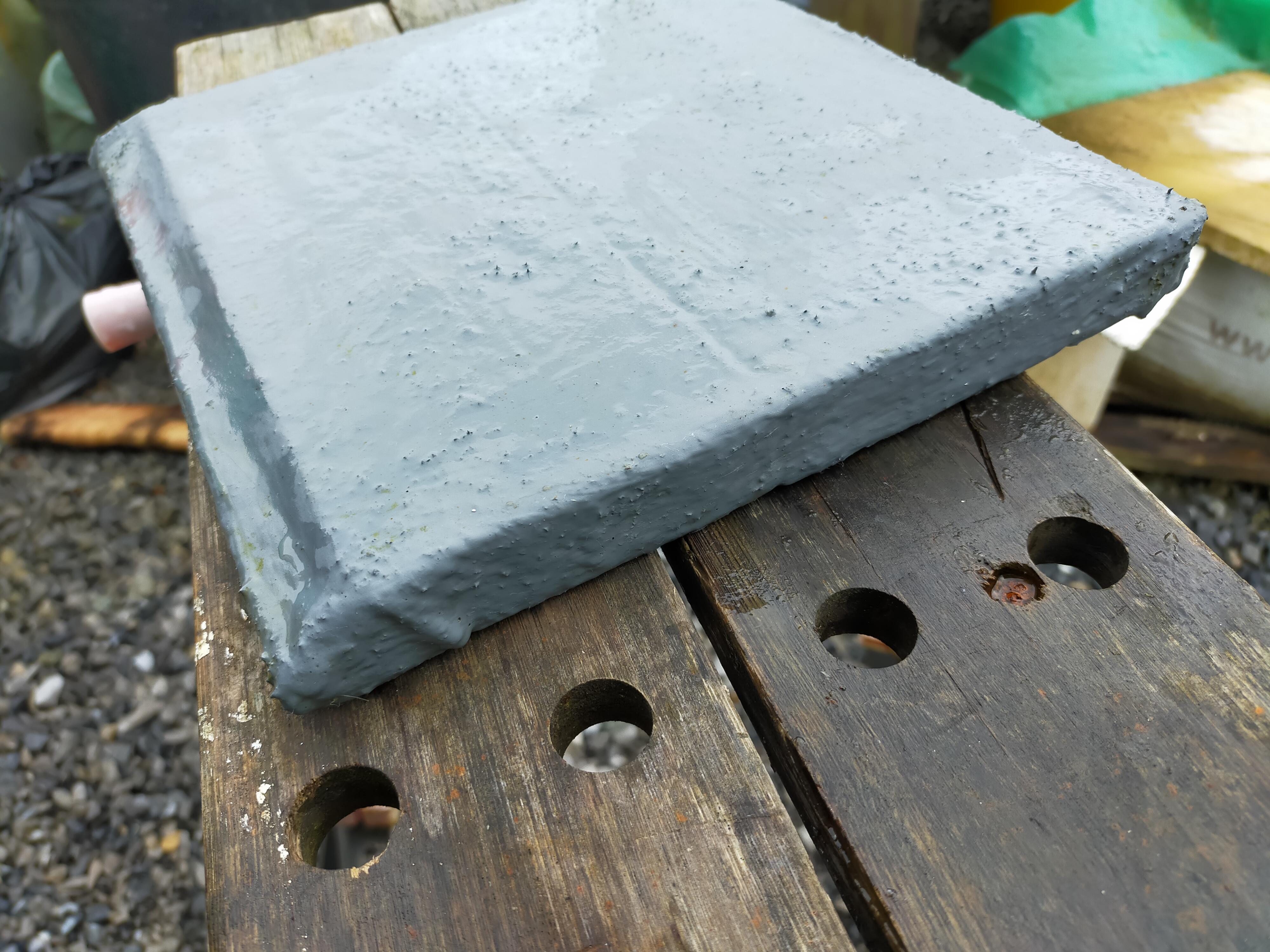

tuftythesquirrel Posted March 15, 2024 Share Posted March 15, 2024 17 hours ago, Gone West said: 17 hours ago, SteamyTea said: If you could nail a thin sheet of ply to it, then it can be coated in-situ. I wouldn't want to do any fibre glassing on the roof. I wonder why someone hasn't come up with a resin that uses moisture to set, like PU glue. I can recommend the Everbuild Aquaseal. I used it because it was a single coat application. I looked others, but priming and top coating would extend the job time. I put on a double coat of fibre glass, the second at 90 degrees to the first, then two more coats. It UV resistant out of the can, whereas other products need a top coat. I used it on a pitch change on our Kingspan Quad-Core metal roof. The professional roofer had attempted a fiberglass joint which blew off in the wind, it was worse than useless. I would definitely use this on a flat roof if it had to. Everbuild technical support were very helpful. https://www.sealantsandtoolsdirect.co.uk/everbuild-aquaseal-liquid-roof-membrane-coating-21kg-grey-aqliqrfgy21?language=en-gb¤cy=GBP&gad_source=1&gclid=CjwKCAjw48-vBhBbEiwAzqrZVIIoeVRo2Uq_AorAxtICel9dYxZNqqNpzFaSn7J-g7lzr8sZM2PNrRoCrEcQAvD_BwE 1 Link to comment Share on other sites More sharing options...

tuftythesquirrel Posted March 15, 2024 Share Posted March 15, 2024 4 hours ago, SteamyTea said: Did you use the Everbuild Aquaseal instead of polyester resin? I was only looking for a waterproof, easily applied, durable covering. I've got an in built aversion to anything two pack. That is, manufacturers instructions say 30 minutes gel time and you're 15 minutes in and it's started to gel and your brush is stuck to the roof, mould or anything else you are using it on. This product is is way more flexible than polyester resin, even with multiple layers of fibre in it and you've much, much longer to get it on the substrate, literally hours. I've coated a piece of internal floorboard and left it outside 18 months ago (in the sun and rain etc.) and it still looks like I just put it on. Link to comment Share on other sites More sharing options...
