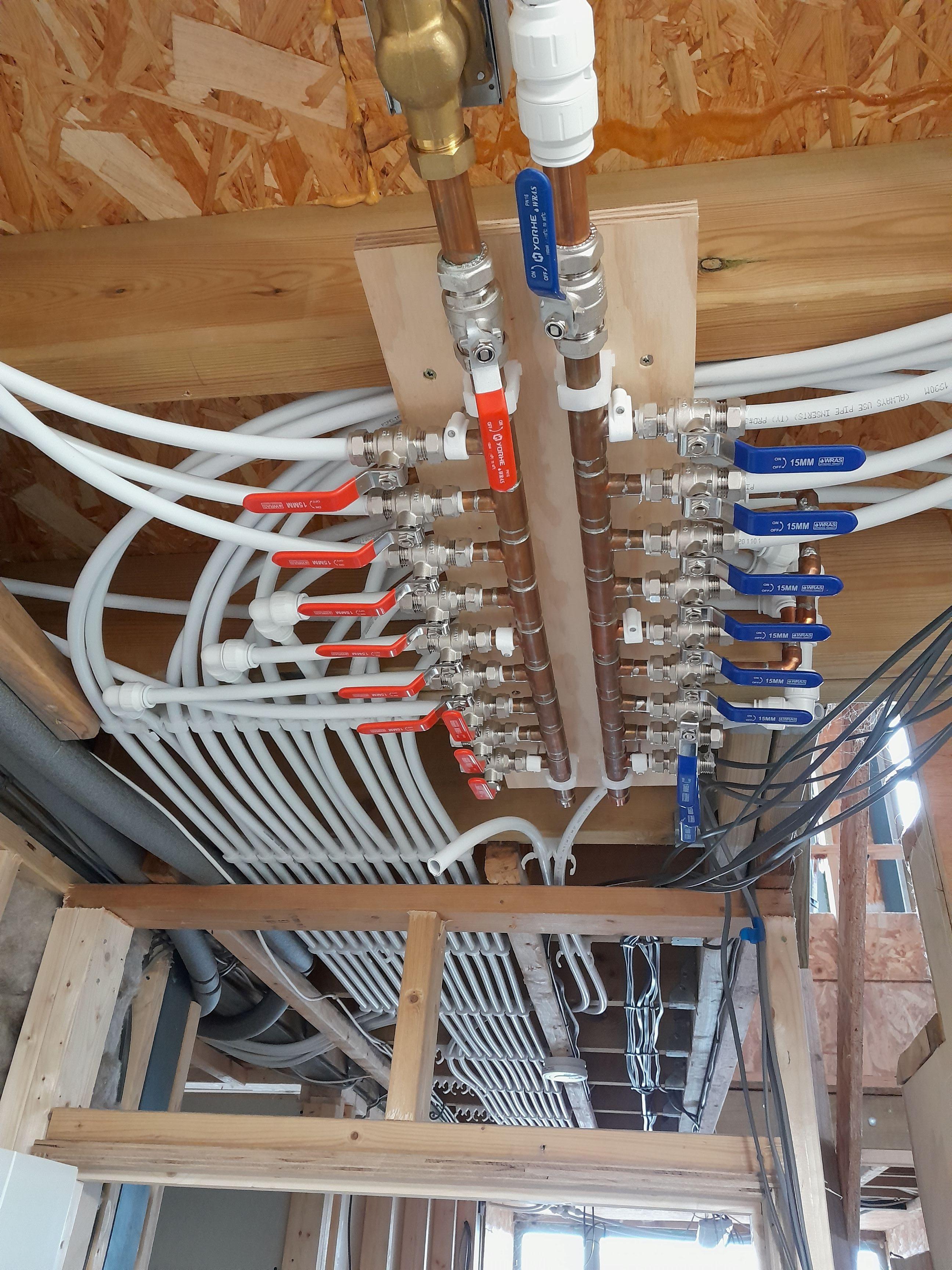

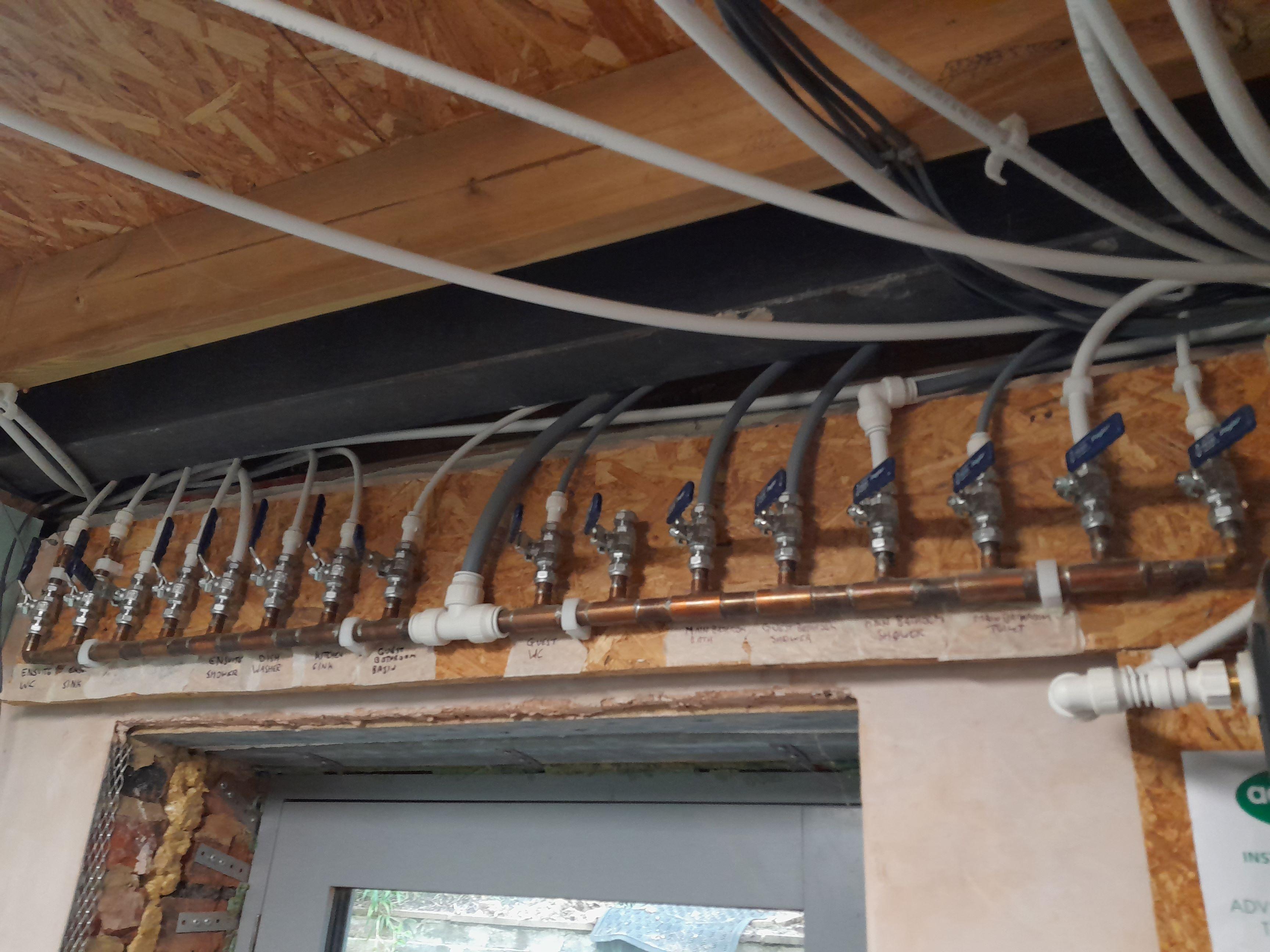

I did something similar to you, but slightly simpler. All plastic pipe (almost)
Cold water entered house, tee one side to cold water manifold the other to the combi. Ran to combi in 22mm and then reduced down. Ran a single cold pipe into each wet room then branched inside the wet room in 15mm
Hot water came from combi in 15mm to manifold and then one hot pipe to each wet room and then branched in the room as per cold. Each run from manifold in 15mm.
Keeps number of pipe runs down, simpler, cheaper, same functionality.
We are all UFH.
I think you'll struggle to find a plumber who knows and understands manifold systems. You might just have to burn out your phone trying!
What you're proposing however is not impossible but the manifold manufacturers for cold and hot water distribution manifolds tend to suggest a limit to the number of ports. In some cases this is as low as 7 and in some it goes up to about 10. In my build, I needed 16 cold water ports and 11 hot water, so I built my own and feed the cold water manifold from the centre rather than the end - no problem so far with flow and pressure any where. Heating manifold wise I have one with 9 posts and 1 with 6 ports and all were a dream to balance.
I've yet to install a manifold system for a customer so @Nickfromwales is the man for long term experience in a variety of projects.
Here are mine (although a bit messy at the time as the water distribution manifolds were in experimental mode to see if they worked ok with the number of ports!).
I used the Rehau smart manifold system largely because it’s much more compact and lent itself to a neater install. I also felt it was a more robust system. This covers an island, a utility room, and two bathrooms. Each manifold has hot and cold that can be individually isolated  IMG_0865.thumb.jpeg.c544a9a89570b8a0f9df3d7883f314ce.jpeg
Edited by Kelvin

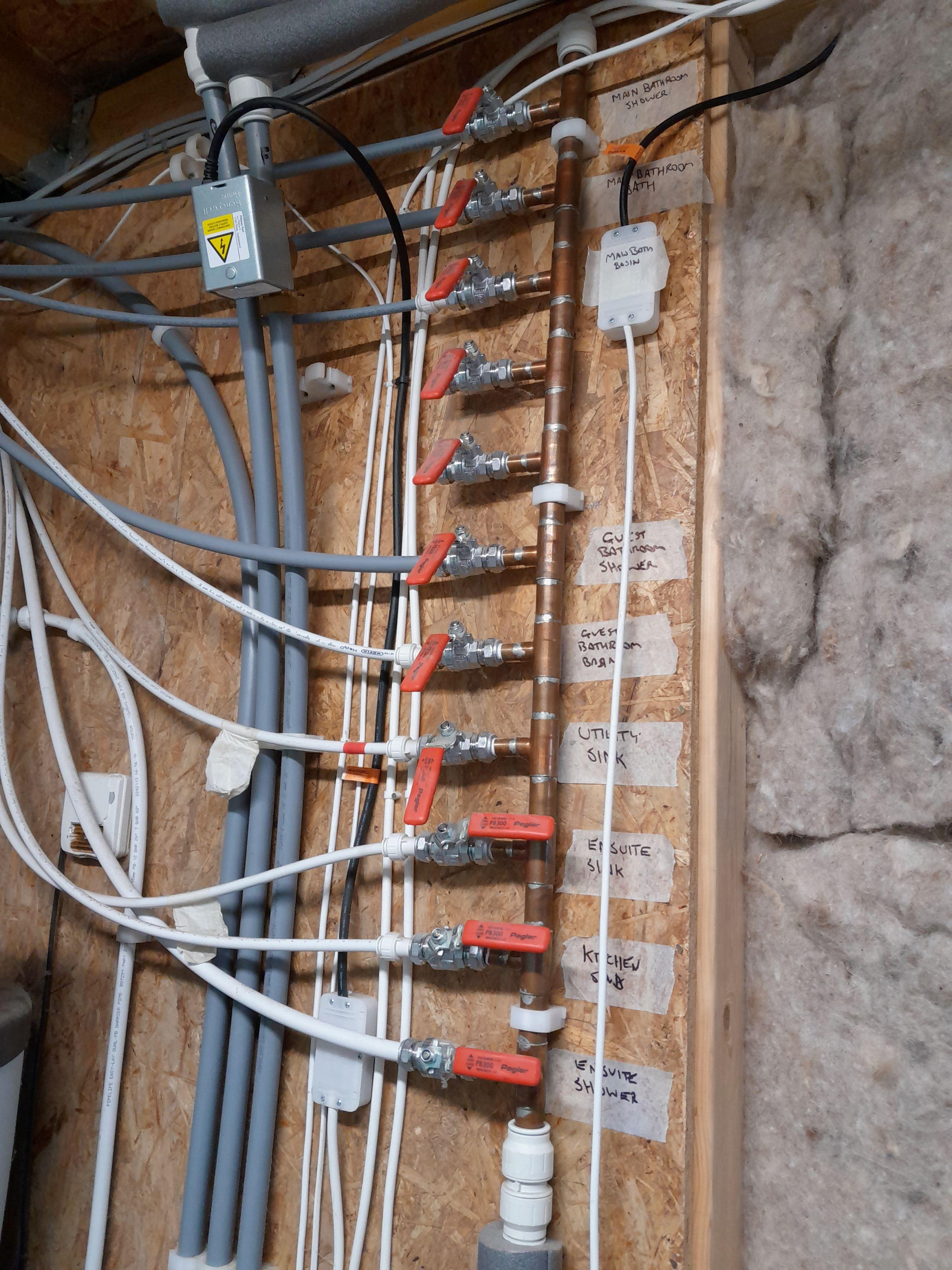

Hello @SimonD, @JohnMo, what are your thoughts on the need for an inlet control group valve to balance the cold supply.
https://www.unventedcomponentseurope.com/22mm-inlet-control-multibloc-valve-group-3-bar-6-bar.html/
In a lot of the threads about the manifold approach for distributing supply, there are lots of great pictures of the manifold, but not so much talk about inlet control group valve. Is this because it is a part of the UVC install?
I currently have my hot and cold manifolds, but have not got to the UVC bit as I will need to bring someone in for this. In my rental the UVC does not have an inlet control group valve and none of the thermostatic valves appear to work correctly, it is either hot or cold, there is no gradual change in the temp as I have experienced in the past.
Does the inlet control group valve have any downsides?
Mine started with a combi boiler, same as the original poster. If starting from scratch with an unvented cylinder you really should take the cold water from the UVC inlet group as a balance supply.
If retrofitting as I did, I have a house inlet pressure control valve, as well as inlet control group on the UVC with the cold balance feed closed off. You also need a check valve on the UVC hot outlet to stop any reverse flow.
Ideally you would feed cold to the cylinder inlet group, and balanced cold water from inlet control group to the cold water manifold. Hot water direct from cylinder to manifold.
Not really. It will have a filter screen in it which needs to be looked at occasionally but mine gets very little debris so once a year is enough. You need a balanced cold feed to all things like shower mixers. It is useful to have mains pressure at the kitchen sink and any outside taps so in practice it may be sufficient to pipe it to the upper floors. Unlike bath/basin fittings kitchen mixers do not actually mix within the tap body (Water Regs) so this is not a problem.
Thanks @JohnMo, I actually found your original thread about inlet control groups and balanced cold.
Thanks @sharpener for the clarifications, where I was getting confused, is my cold manifold includes toilets, showers and basins. @PeterW covers this point where I was getting confused in this thread:
Quote
I feed WCs off the same branch as the outside taps but that is preference - they don’t need to have soft water or be reduced pressure.
As I have already plumbed and tested my cold manifold, I’m not going to break it all apart. But the design nuance I missed, is that not all cold feeds need to be balanced like to a toilet cistern or kitchen tap.
So for the benefit of others attempting to follow the plumbing manifold approach popular on BuildHub, you need to consider if you need a non-balanced cold manifold that comes before the inlet control group, this could also be hardwater if appropriate. All mixer outlets should/must* be fed from the balanced cold outlet on the control group. (*There are exceptions to this rule)

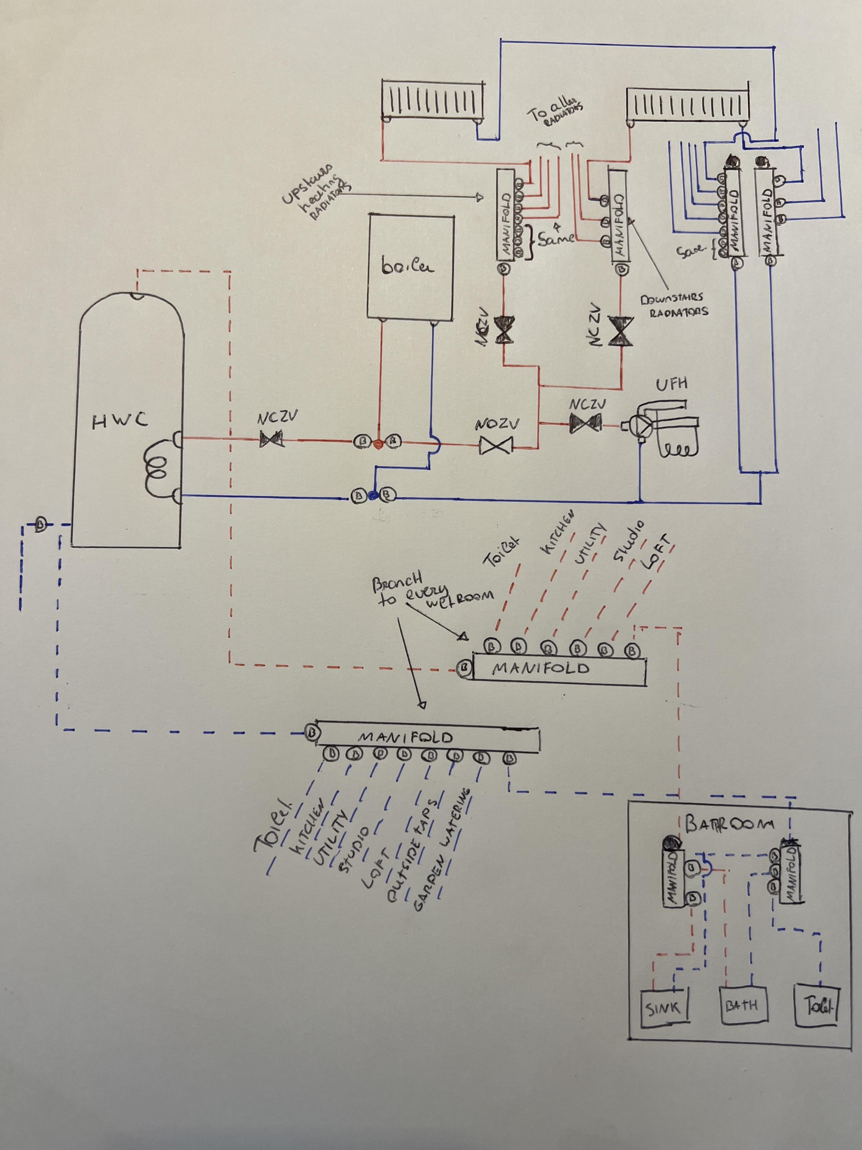

Thanks everyone for the great input. I've asked 2 questions on this forum so far, and I've learned so much from everyone here already. So I tried to combine all my learnings, and put this together in a diagram.
Here's what I'm doing:
- Use HWC + System Boiler instead of Combi Boiler
- Use Priority Domestic Hot Water set up
- Use PEX pipes for CH and DW water supply, but use copper for connections between boiler and HWC as I've read that with PDHW boiler can heat water up to 80 degrees for the HWC which is about the max PEX can take safely.
- Use multiple zones (1 for upstair radiators, 1 downstairs radiator, 1 of downstairs UFH) -- I want to split upstairs and downstairs as downstairs temperature should be lower than upstairs.
- Use manifolds for CH.
- Use manifolds for DW with an outlet for every wet room. In the wet room put another manifold where needed. Mostly doing this to save space in the boiler area.
Just to call out once again that I have no plumbing experience what so ever, nor do even know if this is even possible or right! I just wanted to draw something out and get input from the professionals here before I'm sitting together with my heating engineer / plumber again to ensure the understand what I'm after.
