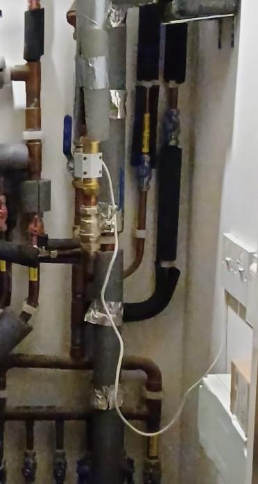

bassanclan Posted March 3 Share Posted March 3 I have a thermal store with an external plate heat exchanger (phe) When a tap is turned on a dlow switch detects the flow of water and turns on a pump to pump water through the phe and heat the mains cold water. There is a problem. The pump isn't coming on, so manually wired the pump to a plug temporarily - it works. Input 240v into the flow switch, 220v coming out. So i got a new flow switch, but that behaves similarly, 240v in and 224v out, this time getting the pump on, but the pump flashing saying low voltage. Pump is a Wilo para RS25. I feel like 220v should be enough to make it work? Specs say 230v +/- 10% Can I have two faulty flow switches? Link to comment Share on other sites More sharing options...
ProDave Posted March 3 Share Posted March 3 You should not be dropping 20V across the switch. I suspect a wiring / measuring error somewhere. Especially as you are getting similar volt drop with the new switch. Post some pictures of where you are taking your measurements and with what. Is it a real flow switch (I have seen some strange setups with a thermostat acting as a flow switch) 1 Link to comment Share on other sites More sharing options...
bassanclan Posted March 3 Author Share Posted March 3 https://uk.farnell.com/te-connectivity/fs-05/flow-switch-brass-ac-10bar/dp/1006768 This is the flow switch. I'm away until Thursday so can't take a photo, but thought I could order a part for my return. I'm taking readings with a basic cheap multimeter. Two wires, brown being live in ans blue (sleeved brown) as live out. It is fed from a fused switched flex outlet. With the switch off there is 0volts Switch on shows 240v going to the flow switch and 0v coming out. When a hot tap is turned on 220v or 224v coming out Link to comment Share on other sites More sharing options...
bassanclan Posted March 3 Author Share Posted March 3 I found this photo which shows the flow switch Link to comment Share on other sites More sharing options...

bassanclan Posted March 17 Author Share Posted March 17 Just getting round to looking at this again Voltage at the pump 240v Input voltage 240v Output voltage 240v Output voltage when going through the flow switch 220v Neutral from pump to neutral on another circuit is 0v It must just be the flow switch has gone and the new one is faulty! Given both are under a year old I will return to RS and see how a third one works! As they will probably send me a replacement is there a better way it could be used to prevent this problem recurring? Alternatively a completely different setup which would make sense? Link to comment Share on other sites More sharing options...

sharpener Posted March 19 Share Posted March 19 19 hours ago, bassanclan said: When it arrives I will initially just put it back as it was to make sure it works, but should the DESIGN change, e.g. relay extra fuse, etc and if so how? Yes, connect output of flow switch to the coil of a substantial mains relay or small contactor. Connect normally open contacts of relay between mains and the pump. I still think the original fault is very odd as there appears to be some 20V across the reed switch contacts, this implies current is flowing but the contacts are high resistance so power is being dissipated. I would expect either 240V if they are burnt away or virtually nothing if they are making. Did you measure the voltage directly across the contacts? Link to comment Share on other sites More sharing options...
Trojan Posted March 23 Share Posted March 23 Could you give a clearer picture of how it's plumbed into your system? Link to comment Share on other sites More sharing options...
