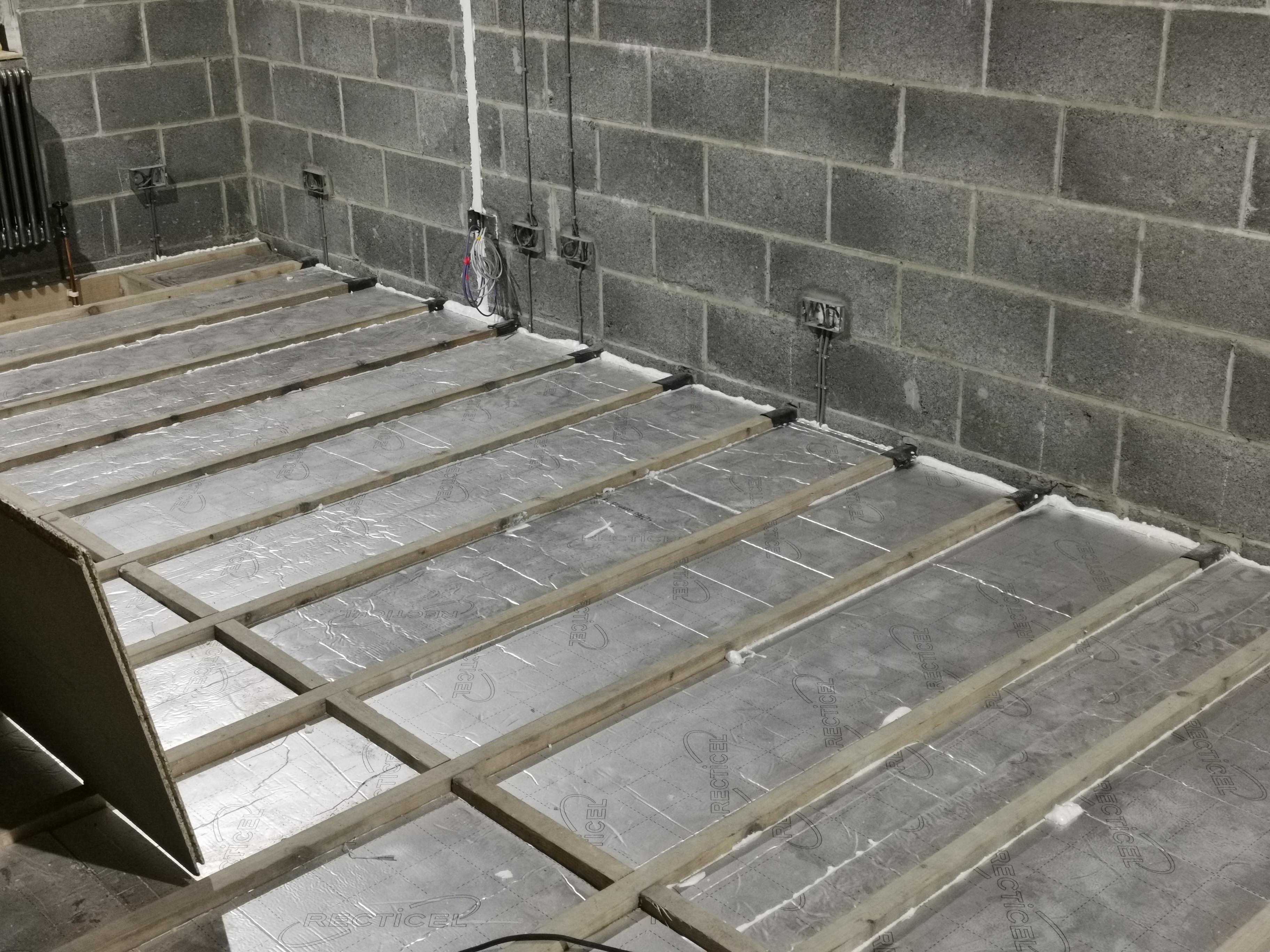

Super_Paulie Posted March 3 Share Posted March 3 I'd go with the 150mm PIR, best bang for your buck and if it's supported on battens then it's rock solid ready for your pug mix. Here's my 170mm version, just need to tape over the joins. 1 Link to comment Share on other sites More sharing options...

Obi_wan Posted March 4 Author Share Posted March 4 12 hours ago, Super_Paulie said: I'd go with the 150mm PIR, best bang for your buck and if it's supported on battens then it's rock solid ready for your pug mix. Here's my 170mm version, just need to tape over the joins. What’s your finished floor buildup plan? Link to comment Share on other sites More sharing options...
Super_Paulie Posted March 4 Share Posted March 4 ive got 22mm caberdeck and then LVT. I got the caberdeck before i was reallly educated on the subject and i needed a structural floor to live on for the last year and a half while the build was ongoing. If i could go back id get something that isnt an insulator like cement board or whatever but it is what it is, ive already got it. If its rubbish i'll just switch the floor out in the future but quite frankly the house is warm enough as it is with having the radiators on for 10 minutes as its so well insulated and air tight. I put rads in as a backup incase the UFH doesnt work as intended (and to dry clothes etc!), the room is 90sqm open plan. In fact, if i could go back i wouldnt even bother with the UFH, but im all in now. Link to comment Share on other sites More sharing options...
