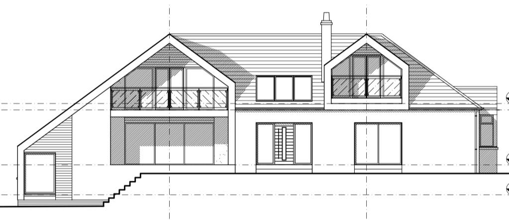

  1. I would but they keep advising that they are supplying 2/3s of it loose timber and I’ll be paying a premium for trusses. I think I might have got a workable outcome with the engineer yesterday where I can buy c24 for everything up to the dormers and then switch to trusses. Once that is fully confirmed I’ll be able to price the cost difference and see if there is enough to bother splittt it. I like the idea of loose as it can be worked on site, especially if the walls are not straight or square etc given that the original part is 100 years old. the feedback from the engineer is that the trusses can do things that he couldn’t due to the consistency of truss joins compared to on-site fabrication and I will need to incorporate 5 additional steel beams and use multiple flinch plates were the truss manufacturer doesn’t.
  2. you’re not the first to say that 😂. I am afraid that it is too late and I’m a reasonable way through, although plenty still left. I am content that the design works, if the roof goes well.

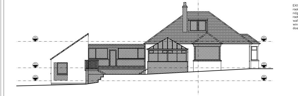

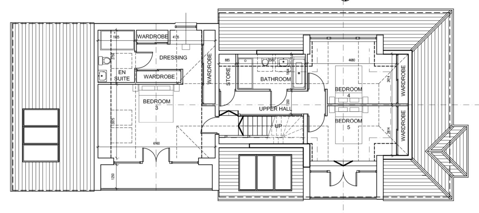

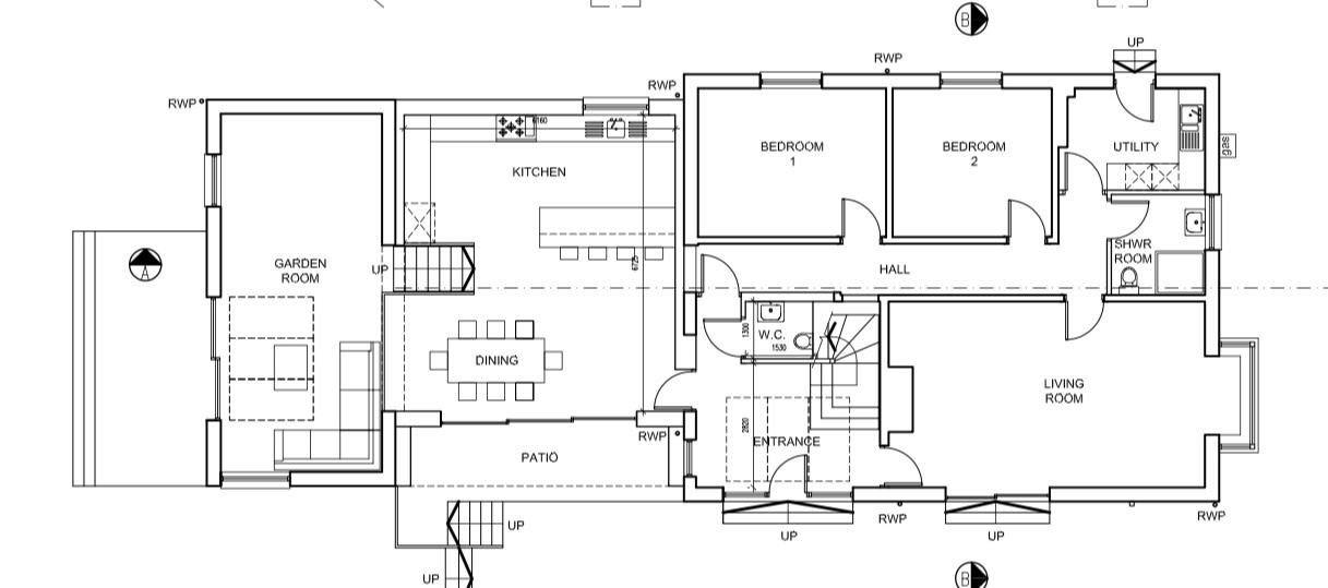

  3. Undertaking a renovation of a bungalow and quickly approaching the most complicated part of the renovation, the roof. The renovation involves a 1 1/2 story extension being built in the middle of the house. This made the joining together of roofs complicated and large chucks were being removed anyways. It was proposed by the engineer and architect that replacing the whole roof would be more sensible. Which I think is correct. Truss manufacturer has provided a proposal but advised they are supplying 2/3 of the roof as loose timber and believe a traditional build might be cheaper. Engineer is advising I should stay with trusses. I want a warm house that is wind, water tight and as air tight as practical. This part will be mostly up to me. link shows the 3d design. any thoughts and advice appreciated. https://sketchfab.com/3d-models/x55138a-80d3ee68d50d471387bbe02d507b80be
