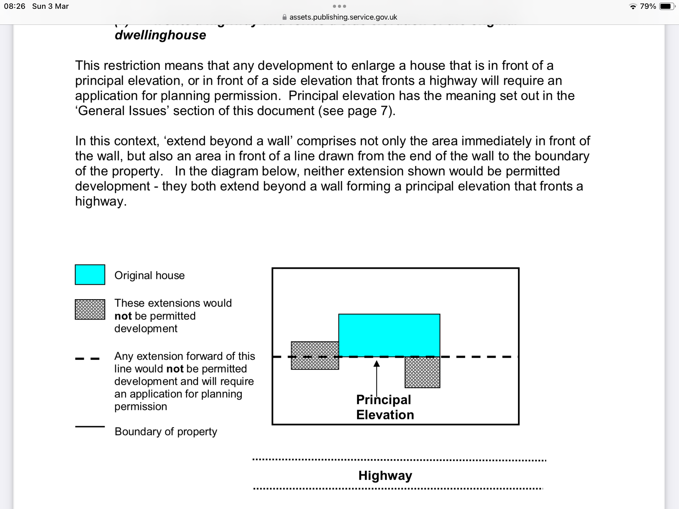

Sunny fallows Posted March 3, 2024 Author Posted March 3, 2024 It’s not an extension, it’s a porch, which is permitted development if under 3m2. my question is where how the 3m2 is measured
