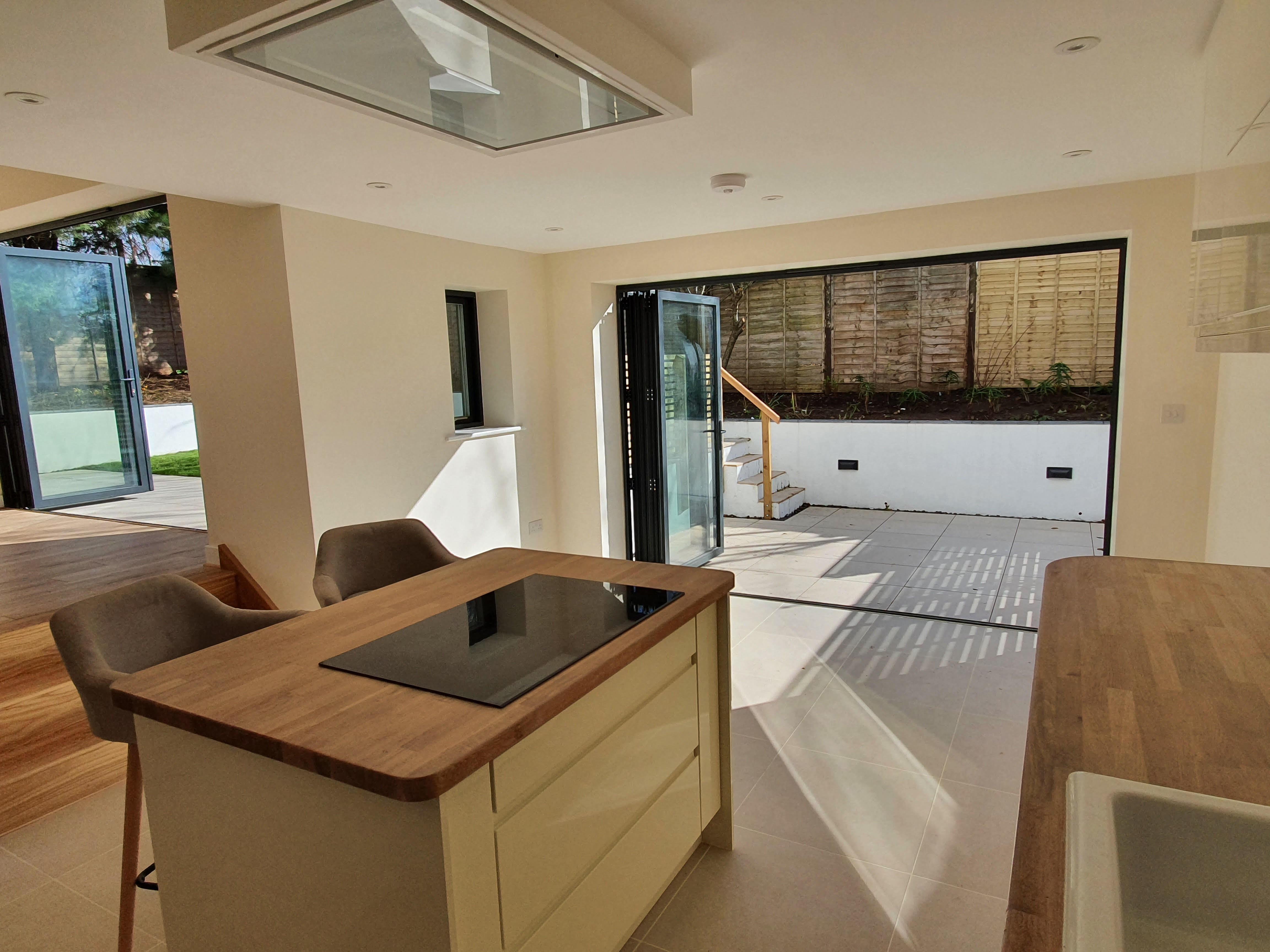

Martin-W Posted February 28, 2024 Share Posted February 28, 2024 Recently started an extension which is going to become a 5m x 5m kitchen with a part-pitched ceiling (c.3m center-height). Kitchen plan has the hob in the island close to the centre of the room, which means either an island extractor, a downdraught, or a ceiling hood. - Island extractor isn't desirable because I'm going to keep hitting my head on it and it's going to be visually 'in the way' - not what we want from a feature kitchen, and especially if you want to have a conversation with someone while cooking. - Downdraught with a 5-ring hob (a must-have) becomes very expensive as it's then a separate item in the island, which is also a separate cut in the quartz. Don't really want either of those. Plus we'd need to duct out through the floor which has already been laid (to concrete), or recirculate which isn't as effective. - ...which leaves a ceiling extractor. But with a 3m high ceiling, that's a 2m rise from the hob, which is pushing it. My research suggests that means we either need a higher flow-rate or a box-section dropped-down from the ceiling (more time/cost, but can do if needed). ...which is where it gets messy. There's a lot less in the usual places about ceiling hoods, so I've had to hunt further afield. All the 'affordable' brands appear to have shocking customer service / warranty response (even Luxair, who appear to have TrustPilot sewn up but get shocking reports on wiggling out of warranty claims and careless engineers everywhere else). Leaving the likes of Bosch/Neff at the 'adequate' end (but flow-rates appear to be borderline for our dimensions), or moving up to Caple/Novy as you head into posher territory. What have people on here fitted (& how easy/difficult was it), and does anyone have any experience of longevity / reliability (brands in general, not just ceiling hoods)? Don't want to put something 'cheap' up only to have to replace it 2 years in or have an argument about a worthless warranty, but don't want to stretch the budget here if we don't have to. Thanks, Martin. Link to comment Share on other sites More sharing options...

OwenF Posted February 28, 2024 Share Posted February 28, 2024 I’m in a similar position My current plan is to have one of these remote (in loft space above the kitchen) venting out via tile vent. https://www.tlc-direct.co.uk/Products/SLTD250SILENT.html Rigid ducted down to a small plenum within some boxing with an egg crate grill eg. https://www.justfans.co.uk/kitchen-extract-grille-with-grease-filter-450-150-cef-p-1454.html Must admit I’m sceptical about the look of it (possibly very industrial) but the Luxair or Elica range coming in around £1000 with limited remote fan options (or at extra £££) is equally unappealing Variation on the above might be buying a cheap, nice looking, hood extractor then gouging the internals and grill out to retrofit a remote fan. Link to comment Share on other sites More sharing options...

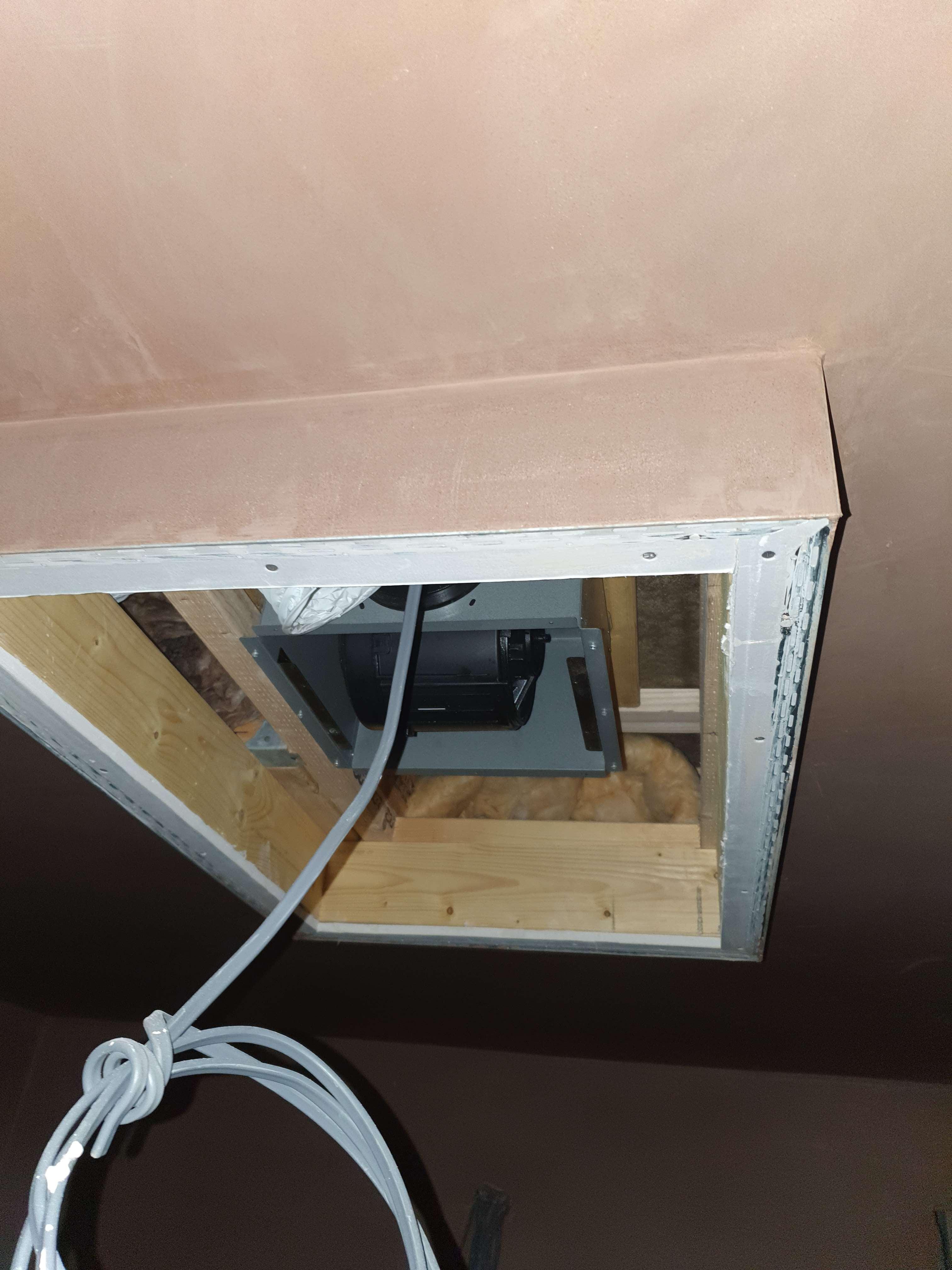

Moonshine Posted February 28, 2024 Share Posted February 28, 2024 I have a Luxair one that fits in a boxed out recess in my ceiling. You need to be planning for the fan when you do your joists as the fan sits in the ceiling cavity. Also factor that you need to get a 150mm duct out the house some how. I didn't know what fan i was using so i have to do some messing with the joists and the designer had to check the calcs but it got done to make the recess. Fitting is easy if you have got your measurements right, though was a pig if not (i know from experience). As for longevity, this fan is new to me (£100 of facebook marketplace) and has worked fine and isn't too noisy. I had to get a new remote and give it a good clean but been good value Link to comment Share on other sites More sharing options...
Moonshine Posted February 28, 2024 Share Posted February 28, 2024 Found an image if the fan unit installed in the hole, before the main chassis attaches Link to comment Share on other sites More sharing options...

Martin-W Posted March 7, 2024 Author Share Posted March 7, 2024 Quick update - going for a Bosch unit, as I know they've got a good customer service team if anything does go wrong. More than i wanted to spend, but buy-cheap/buy-twice. Box section has been built into the roof trusses to house, with a second 'inner ring' of 45mm trusses so if any replacement turns out to be slightly bigger we've not got to bugger around with the whole ceiling. Going to be vented out of the roof, will now have a proper 6" chimney-style vent out of the roof (which is only going to be about 3-4' above the unit) and just need to make sure that it gets 6" ducting all the way, ideally more solid than flexi. Thanks for the advice...it's really helped plan it all through. Link to comment Share on other sites More sharing options...
