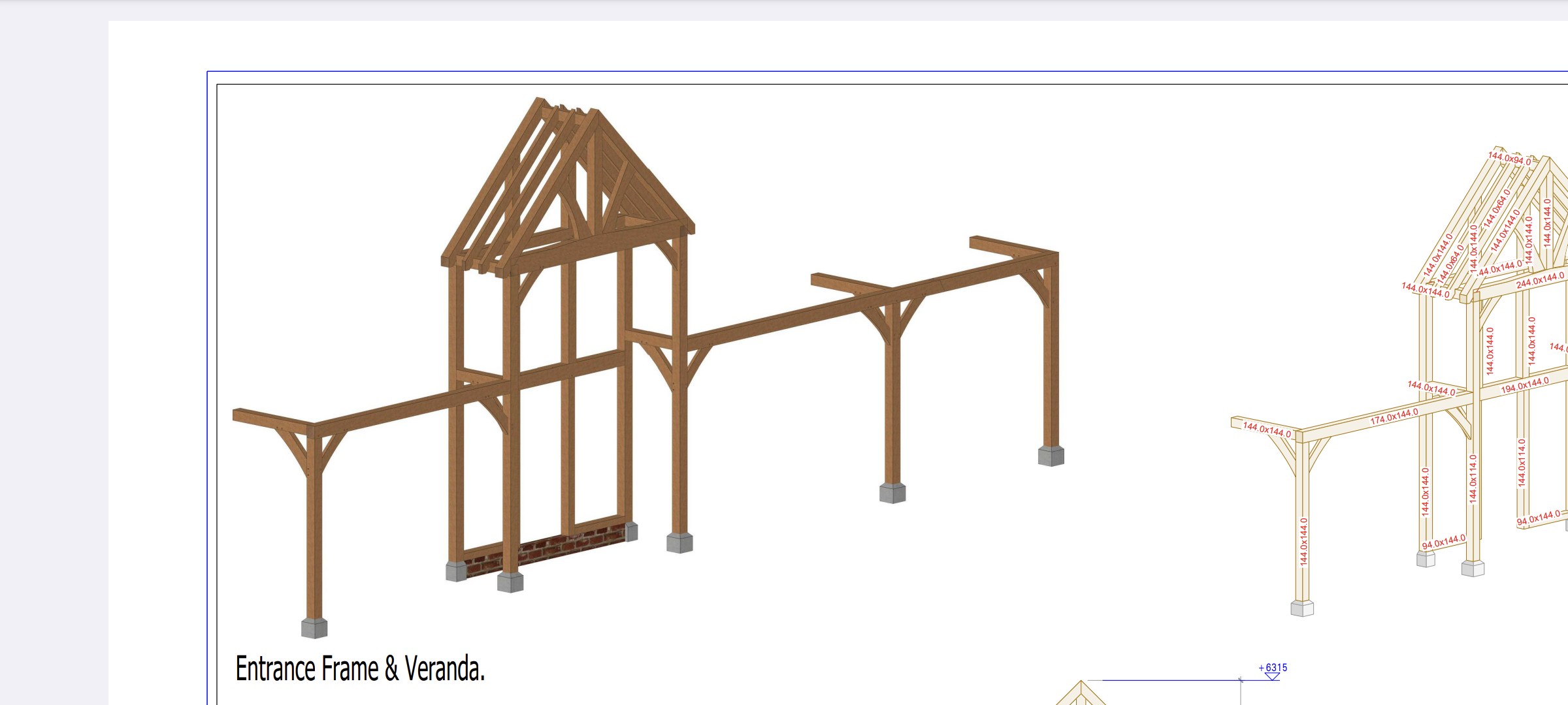

peekay Posted February 22, 2024 Share Posted February 22, 2024 Hi. Our timber frame building supplier is also providing a green oak framed structure for the front and rear of the house to support a veranda and a double height oak frames porch structure. We think that we have selected the windows and doors for all of the traditional openings in the house, Aluclad Timber with a sub 1.0 U Value. The rest of the house will be very well insulated. I haven't quite figured out how we are going to deal with the amount of glazing in the oak structure. Keeping it well sealed, airtight, with the right U value for the glazing whilst minimising heat transmition through the oak frame itself between the glazed panels which will be in effect uninsulated. Does anyone have any thoughts, or glazing suppliers that might be worth speaking to? There are several oak frame companies who look to also do glazing, but the ones that I've spoken to so far are not interested in working within someone else's oak frame Thanks Link to comment Share on other sites More sharing options...

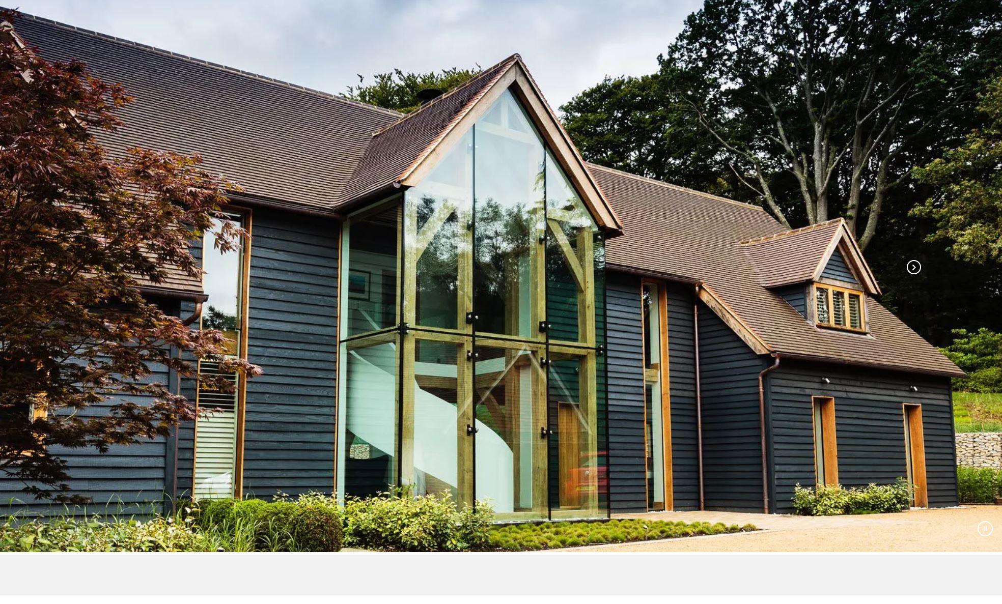

Alan Ambrose Posted February 22, 2024 Share Posted February 22, 2024 No, I think you'll have to sort out the detail yourself. If I remember rightly, for that kind of detail, an Oakwrights frame I saw had the glazing unites mounted on the outside of the frame and then some full width oak 'trim' pieces mounted over that. Unless you looked very carefully, the effect was as though the glass was mounted in the 'frame'. I think the trim was held by counter-bored A4 SS screws but with little oak dowels over, so the whole thing looked through-dowelled. Having said that, I'm not sure why you couldn't mount the glazing units within the frame, allowing plenty of room for the frame to move, and then mount trim pieces inside and out over the units. Maybe you can mount one big triangle somehow in the apex to avoid dealing with the curved braces. Actually it's not clear which parts you're planning to glaze and which parts not. 1 Link to comment Share on other sites More sharing options...
markc Posted February 22, 2024 Share Posted February 22, 2024 +1 to mounted on the outside, the oak frame will shrink and move so any glazing or frames in between need to allow for a fair amount of movement. i once saw glass sat in deep channels in an oak frame with gaskets that allowed movement but it looked bulky and ugly Link to comment Share on other sites More sharing options...
peekay Posted February 23, 2024 Author Share Posted February 23, 2024 Thanks. Keen to avoid any movement impacting sealing. I'm almost considering creating a glazed curtain wall behind the oak frame, to remove the oak from any windows. Link to comment Share on other sites More sharing options...
Alan Ambrose Posted February 23, 2024 Share Posted February 23, 2024 Ah yes, I saw an image - actually with glazing on the outside and it looked great - you just reminded me. 2 Link to comment Share on other sites More sharing options...

Rishard Posted February 24, 2024 Share Posted February 24, 2024 +1 to external glazing. I’ve built several oak frames this way. It’s a bit of a hybrid as the cover boards which sandwich the glass to the oak frame are separate pieces of oak which on a traditional ‘oak frame’ is a bit false but I’ve not seen a better system out there. If the cover boards are rough sawn then it looks best. We use expanding foam tapes to seal the frame to the glass and glass to the cover boards. These are weatherproof and adjust with the shrinkage of the oak. Oak frames are harder to airtightness seal and have some fairly substantial thermal bridges but it can be done. Oakwrights system is good. Link to comment Share on other sites More sharing options...
GaryChaplin Posted February 26, 2024 Share Posted February 26, 2024 The system to use is called "direct glazing", "applied glazing", "face glazing" or "curtain walling". Pick one! https://sessile-oak.co.uk/oakFrames/glazing Link to comment Share on other sites More sharing options...

peekay Posted September 21, 2024 Author Share Posted September 21, 2024 I started this topic back in February, but as there has been a bit of recent activity on the thread I thought I'd give a quick update. We have found a local company that specialise in direct mount glazing to oak frames. They surface mount and then cover the edges with oak trims as described by someone earlier in the thread. I've in the last week finished sanding the internal faces of the frame and the glazing company have prepared the frame with various bits of DPC, and adding fillets/notches where required to sit the glass on. Rather annoyingly the glazing can't be finished until the front door is fitted, which will be in November, so we will have the upper levels glazed in the next few weeks, and the door level sections covered with Ply for a couple of months. We chose triple glazed glass, with a solar film, as the front of the house gets sun all afternoon and we wanted to avoid it becoming a greenhouse in the summer. None of this has been cheap, and if we were to do the house again, we might choose something more simple, but hopefully once it is all finished we will be happy with the choice. Link to comment Share on other sites More sharing options...
