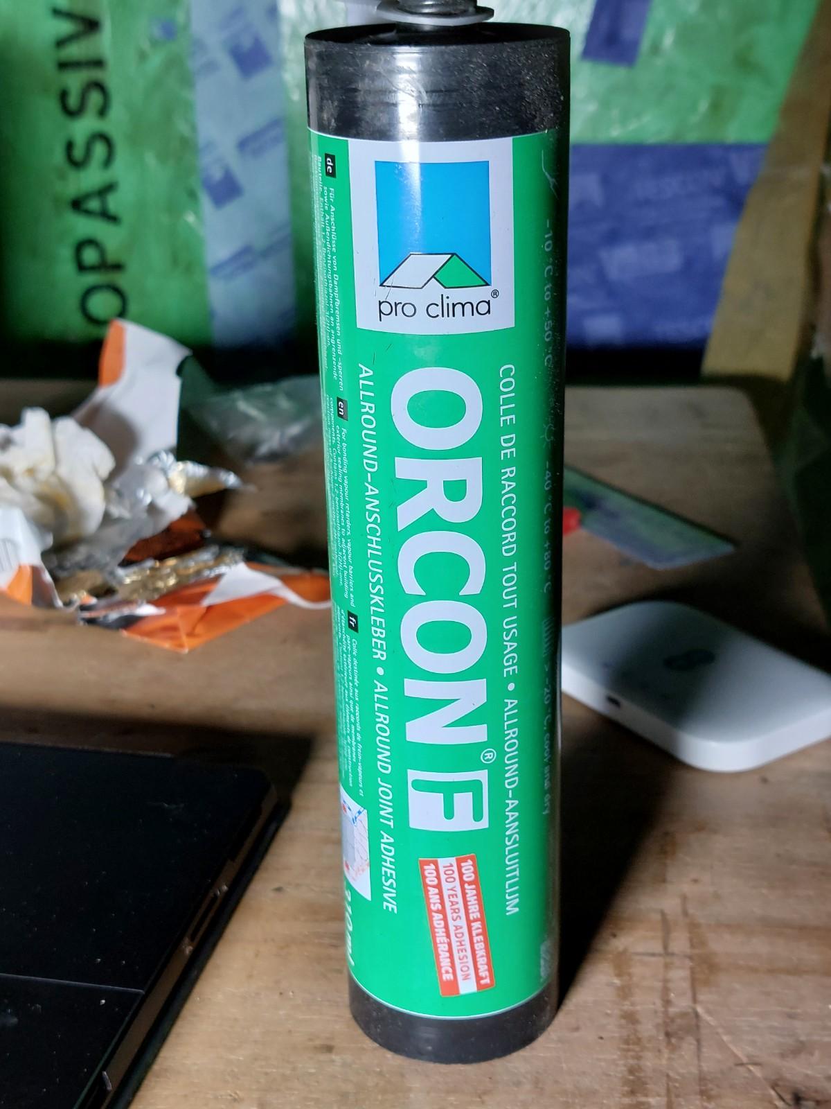

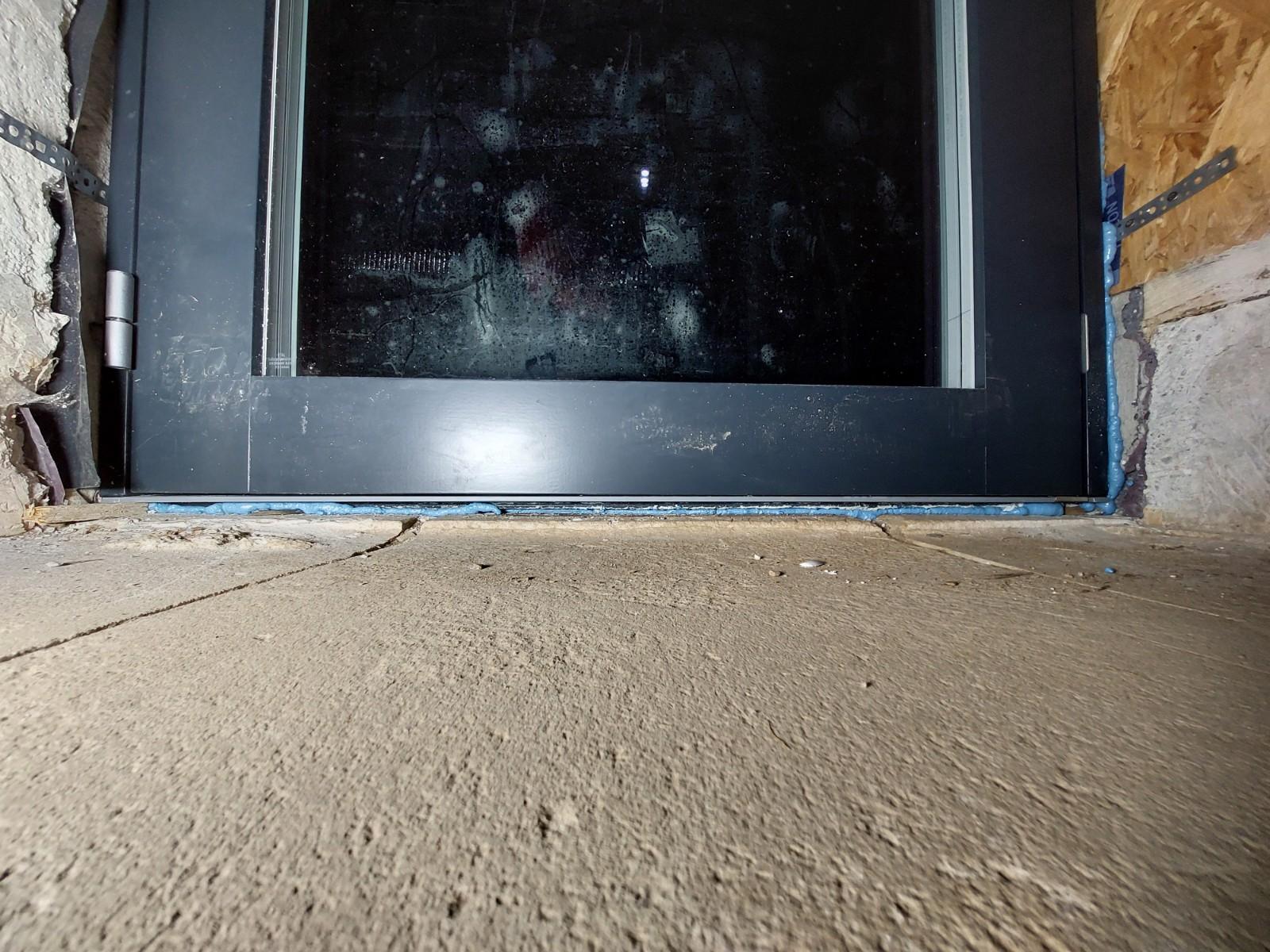

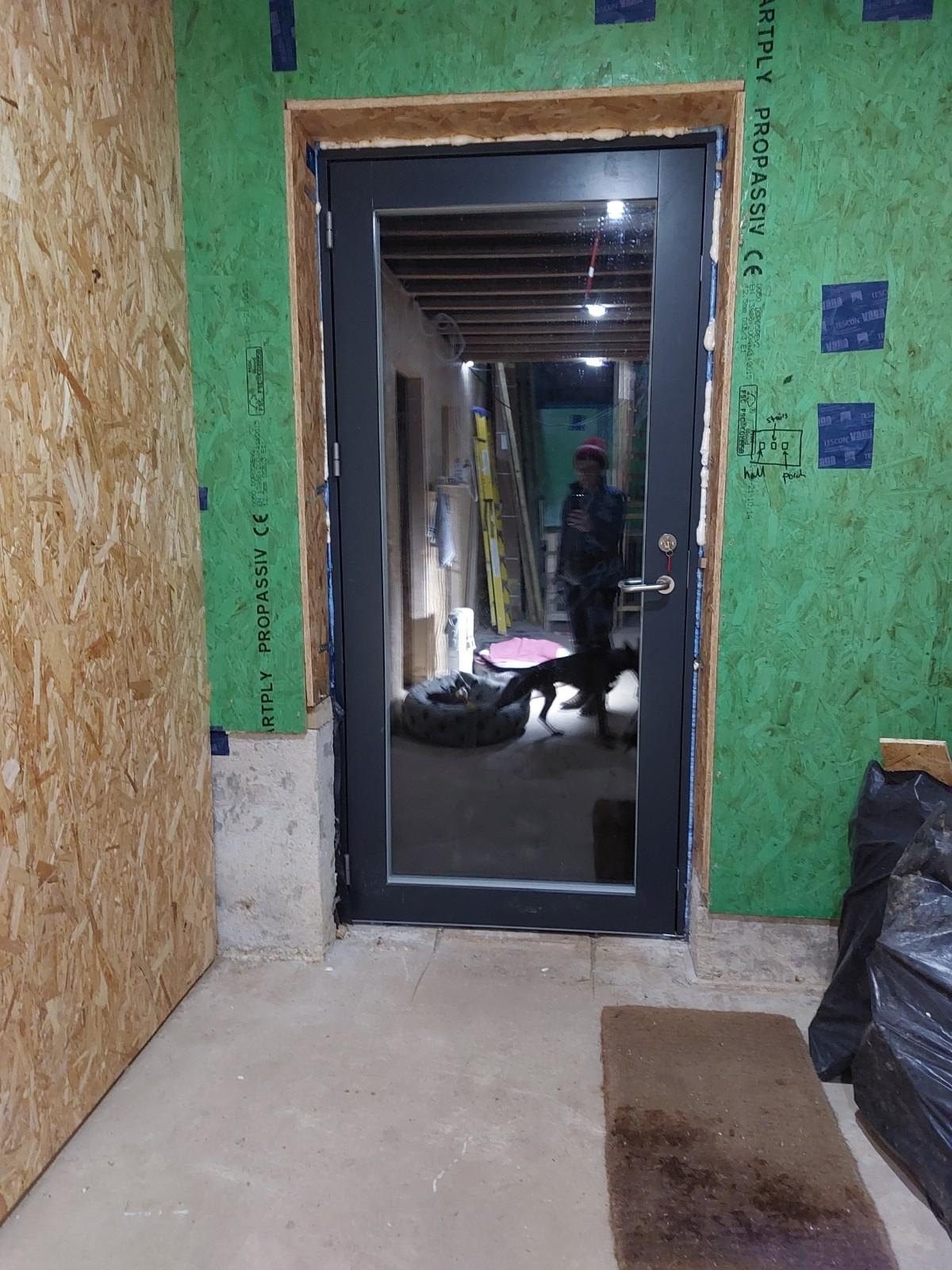

Omnibuswoman Posted February 10, 2024 Share Posted February 10, 2024 Our front and back doors were changed last week, correcting an error the builder made last year. The replacement doors have been installed slightly higher than the others, to allow sufficient clearance for the hallway flooring. Underneath the front door is a small gap which the builder said we could fill/cover with Orcan F before taping with air tightness tape. Is this right? I can only find videos that show Orcan F as an adhesive, like OB1, rather than as a sealant. All advice greatly appreciated. Link to comment Share on other sites More sharing options...
Thorfun Posted February 10, 2024 Share Posted February 10, 2024 I thought Orcan F can be used as an airtight bead. 🤷♂️ can't you just tape down to the sub-base though with Tescon Vana using a concrete primer to aid adhesion? you could do both I guess! 1 Link to comment Share on other sites More sharing options...
markharro Posted February 10, 2024 Share Posted February 10, 2024 My understanding is that Orcan is not designed to be used as a sealer in this way. For our front door I used this - https://www.ecomerchant.co.uk/interior/airtightness-products/blowerproof-liquid-airtightness-system/non-shrink-gap-filling-mortar-5kg.html - with a home made thin spatula to push it in. Then taped over but you can also use the blowerproof paint. A complete pain but got the job done I think. 1 Link to comment Share on other sites More sharing options...
DC5 Posted February 14, 2024 Share Posted February 14, 2024 I think the priority there would be water tightness, certainly up to 300mm up the door sides. I don't think the Orcon would be suitable, I would use a high modulus silicon and then use the airtight tape to make airtight! I had to use a primer like the one below to get the tape (I used Vana) to stick to the concrete. https://insulationmerchant.com/products/pro-clima-tescon-sprimer-spray-can-primer-750ml 1 Link to comment Share on other sites More sharing options...
