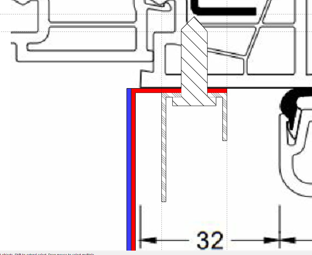

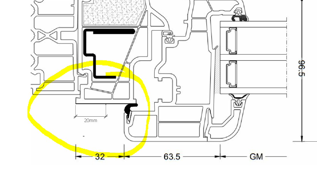

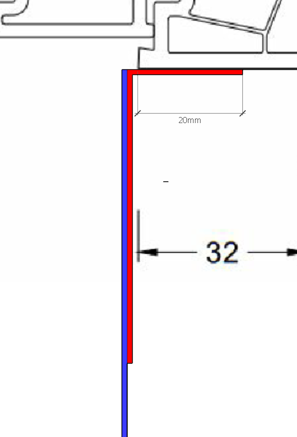

Posted
Ok bear with me here's my suggested steps. Based on Larry O'Donougue's blog which has since disappeared.
Step1.
Draw an accurate line 20mm in from the edge of the window frame with a pencil. Tis will mark the edge of your tape and bead later.  Below is a vertical cross section of your window.
Step 2

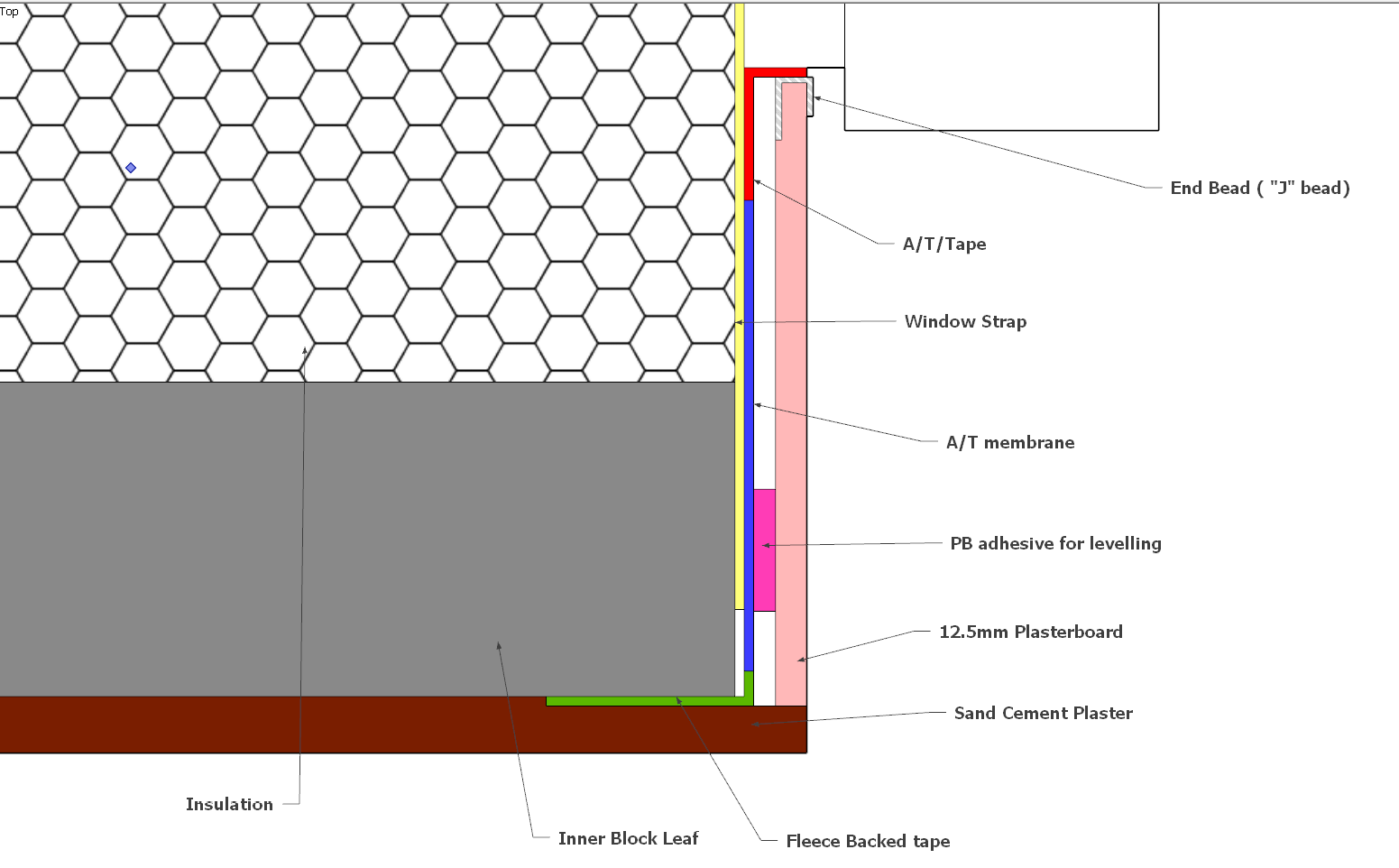

Fit some Split back A/T tape to the line and the other side to an appropriate length of airtight membrane to reach into your inner leaf. Here's a zoom in of the corner.
Step 3: Using SELF-DRILLING LOW PROFILE HEAD SCREWS 5.5MM X 19MM  Screw a 12.5mm plasterboard metal end bead to the windows so that it lines up with the edge of the airtightness tape. The screw hole through the tape will seal ok.
Your may need to predrill or at least centre punch the beads for accuracy.
Step 4.
Add mineral wool to fill the space behind the A/T membrane.
Return the A/T membrane to the inner leaf and tape with fleece backed tape suitable for plastering over. The airtight membrane will sail over the straps, sealing them outside the A/T envelope.
Step 5. Add plasterboard. Packing as required with dabs of adhesive to get it to the correct angle.
Here's a zoomed out view.

Posted
There may be an issue with the clearance being too tight on the sides of the windows with hinges and I'm unsure of your planned window board detail as it'd be very tight even with OSB window boxes when your  frames only have 32mm clearance
