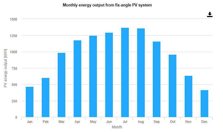

JamesPa Posted February 3, 2024 Posted February 3, 2024 (edited) On 03/02/2024 at 15:12, adrian82 said: On top, I have installed 10KW of photovoltaic panels, to sustain the heat pump. Expand Thats is not enough to sustain the heat pump in the winter months - Its nigh on impossible in a domestic setting, unless you have a very large array, to do this. Here is the plot from PVGIS of the monthly energy from 10kWp solar panels in Romania. In December and January thats about 400kWh/month, 15kWh per day, whereas you say you use 25kWh 'per night'. Do you know have any measure of how much of the energy being produced by your solar panels is currently being returned to the grid during the heating season. Except on mild, sunny days I wouldn't have thought it was a lot if any in the peak heating months, but perhaps it would be significant in the shoulder season. But as those above have suggested, if you do actually have surplus energy (which its likely you do in the shoulder season) you need either to change your pattern of heating so that the ASHP does more work during the day, or store energy. To work out how to store it first work out how much you need to store. Then its either a battery (expensive) or a big water tank. 1l of water heated by say 10C stores about 0.01kWh, so to store 10kWh by heating about 10C you need about 1cu m (1000l) of water. If you accept a low COP of 1, you could use an immersion to do the heating, with a solar diverter, get the temp up to 80C, which brings the volume required down to say 250l for 10kWh, assuming you need water at 40C for your emitters. You need some rough numbers to work out the right solution and, as @SteamyTea says, you musn't mix up energy (kWh) with power (kW). The latter is just energy per unit time thus power * time = energy so 2.5kW for 10 hrs = 25kWh. Same as kilometers per hour (distance per unit time - like power) * time = kilometers (distance - like energy) Edited February 3, 2024 by JamesPa
adrian82 Posted February 3, 2024 Author Posted February 3, 2024 Guys , thank you a lot for your suggestions, I'll start working on those, very helpful. Regarding insulation, I knew that 10cm is not much, but at that moment that was the budget...The floor pipes are mounted on a polystiren structure, which the manufacturer (Purmo) state that has also a insulation role, beside fitting the pipes. I guess that a 500-1000L buffer water tank, to heat the water during the day and release it overnight, could be the best option in my case. Or maybe some batteries, but to store 20kW sounds expensive :).
