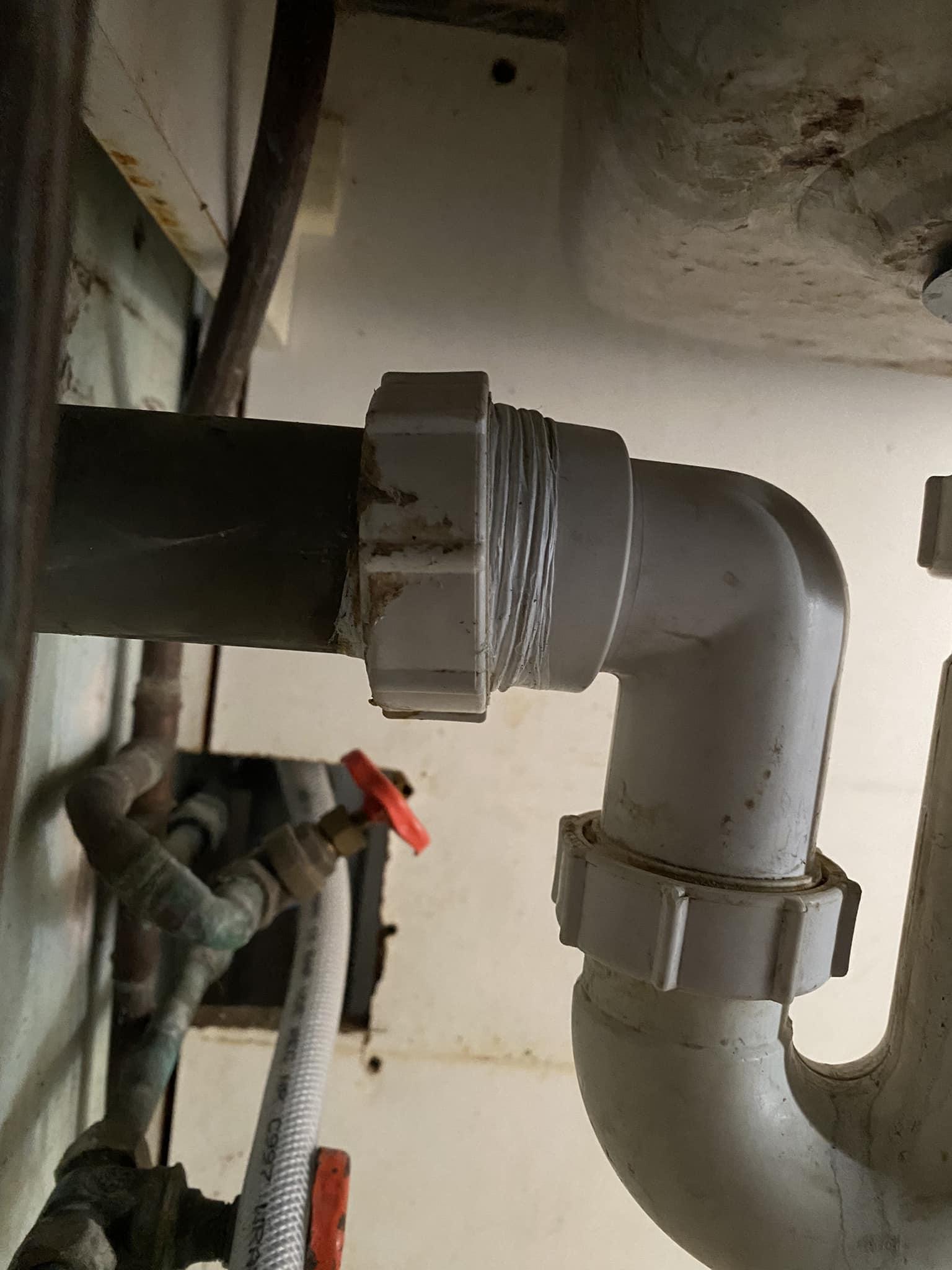

marshian Posted January 31, 2024 Share Posted January 31, 2024 On 29/01/2024 at 19:48, Del-inquent said: I had a look at putting one elsewhere but it's honestly like they got a delivery of copper pipes thrown in a cupboard and just decided to connect them up wherever they fell. Under the bath isn't accessible (because they built it in, badly) so I'd rather not end up having to replace the bath as well for a short term measure. I've attached an image of how the sink trap was fitted, just to illustrate the quality of work I'm dealing with here. I think my favourite bit is the single layer of PTFE tape on the outer plastic threads. No rubber seals were used in the construction of this waste fitting (which is why I'm now lifting the floor to replace joists...) I like the description of the pipework "honestly like they got a delivery of copper pipes thrown in a cupboard and just decided to connect them up wherever they fell. " Brilliant That waste fitting is all kinds of spezial - good luck because if that's what the previous home owners plumbing skills were like the house is going to be the gift just keep giving!!! 1 Link to comment Share on other sites More sharing options...
Del-inquent Posted February 1, 2024 Author Share Posted February 1, 2024 12 hours ago, marshian said: I like the description of the pipework "honestly like they got a delivery of copper pipes thrown in a cupboard and just decided to connect them up wherever they fell. " Brilliant That waste fitting is all kinds of spezial - good luck because if that's what the previous home owners plumbing skills were like the house is going to be the gift just keep giving!!! Oh believe me, it really is. We're replacing the joists in the toilet, as that was similarly skilfully done. 3mm of the flush pipe pushed into the back of the toilet and at the cistern, the seals had been used but they'd been put in both backwards and inside out. Then had PTFE wrapped around the whole joint, over the outside of the clamp nut. On the plus side it has resulted in a good cushioning affect - sit down too heavily on the toilet and the entire floor gives to absorb the shock... My favourite so far is the 4Kg glass and brass light fitting in one room, suspended by 3 or 4 strands of the live and neutral wires. No earth fitted, the chain to hook it to a proper fixing tucked inside the cover. It fell off in my hands. Most of the lighting circuits have already been replaced, professionally by the look of it - when we took the ceilings down I found a 10m length of the original, no insulation left burnt to a crisp so I guess he'd done some work on that at some point and realised he maybe should get help when it started smoking... Hopefully explains why I'm not keen on disturbing too much until we absolutely have to and are in a position to do a permanent fix! 1 Link to comment Share on other sites More sharing options...
