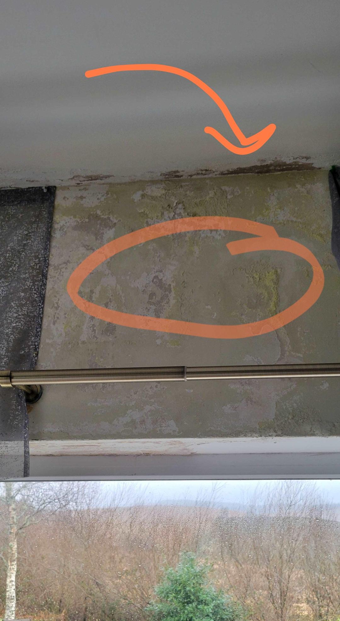

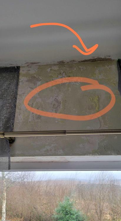

Here are some photos and more info on my problem,
About 10 years ago we decided to wrap the house in Evertex as a means of protection against moisture. But now the vertex is peeling away in spots and it is a bit of a shock to see the state of the render underneath.

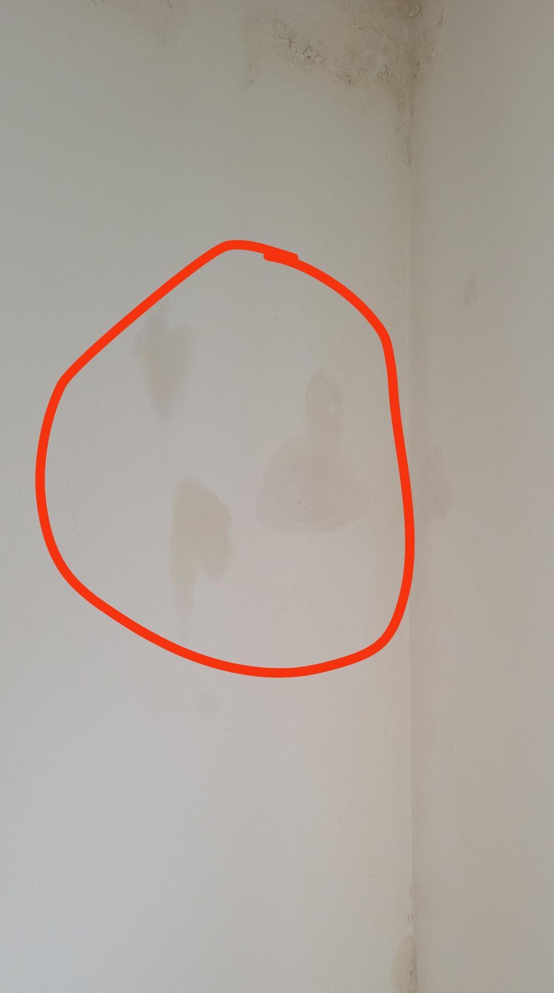

Thanks so much, I have attached some photos here, danke!

the expansion of the ceiling slab/ and the lack of adequate insulation outside the slab ...
The evertex coating you used has popped up on lots of forums with issues regarding bubbling and peeling etc. They must have had some issues with previous jobs because they closed and reopened under the name https://everflexcoatings.ie
As far as I can tell it's a very thick paint, probably of very low permeability.
When airborne vapour escaped from the interior of the house via air leaks it got to a point in the wall where the temperature fell below the dew point, the vapour condensed to water and as it couldn't dry out it soaked into the original line render, diluting the adhesives of the lime and it fell off as you can see.
My theory is that insufficient air sealing was done below and above the first floor slab. There was an easy path for indoor air of high humidity to pass right through to hit the back of the render. Here it cooled and condensed into water. As the original lime was of high permeability, the condensed water was ultimately able to dry though it to the outside so damage was limited.
However when the Evertex was applied the water couldn't go anywhere, it soaked into the lime render and then you had problems, gravity did it's part and the water migrated down the wall destroying the render below the slab area too.
The almost perfectly straight fault lines in the render are my evidence of air leaks combined with the impermeable paint being the issue.
I would almost certainly rule out differential expansion of the slab and walls as they are similar materials, and the distinct two lines at slab level rather than a complete band point towards air leakage rather than a thermal issue.
TLDR:
Bad air sealing above and below the slab allowed moist internal air condense behind the impermeable paint dissolving the lime render.

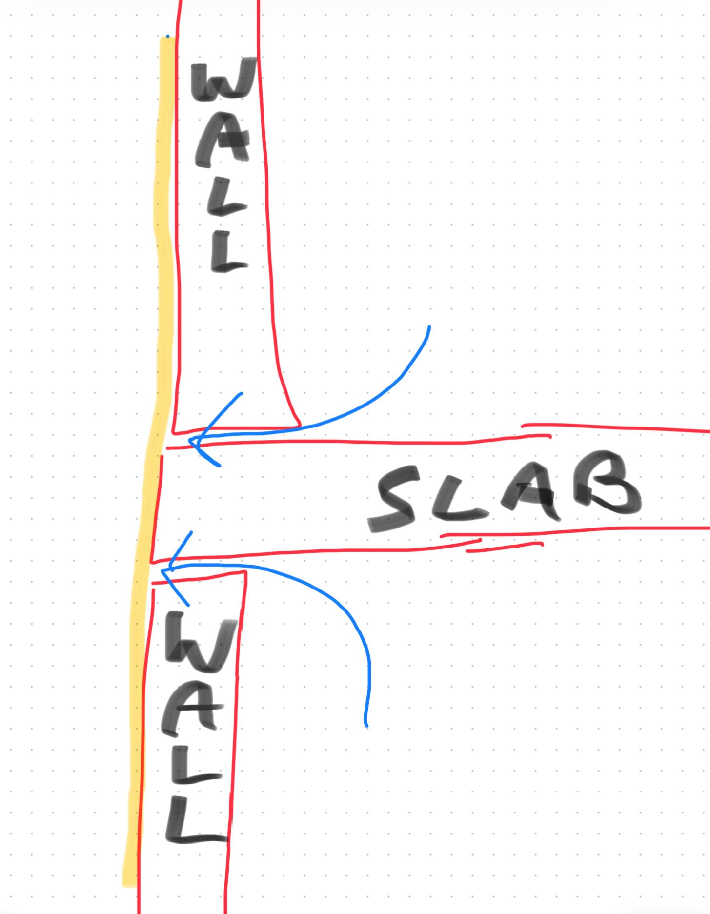

Vapour needs a surface to condense onto, like a bathroom mirror. If there was an unbroken airpath under and over the slab then it could have moved un hindered until it met the cold back side of the render.

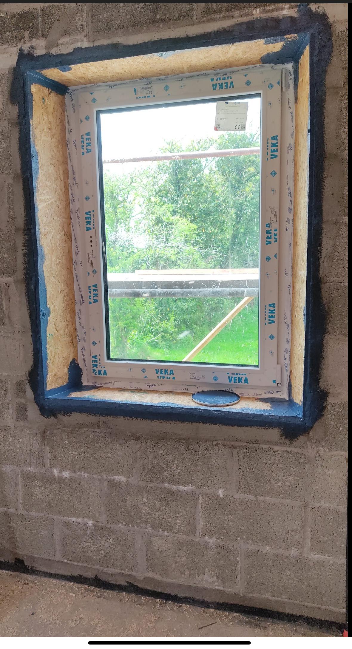

Normally done to join two parts of a house together to prevent air leaks at the interface. It's best done with some permanently elastic material like airtightness tape or paint to accommodate any movement. Walls to floors. walls to ceilings, walls to windows etc. the idea is to create a completely airtight seal.
Here is how I did our windows and floor. I filled all large gaps with sand and cement mortar and then painted on blue airtightness paint which dried to black. Tape was used to seal the OSB window boxes to the window frame. (For anyone who's interested we used a parge coat first near the floor and around the window to save using up too much expensive airtightness paint).

I'm working on a best guess here. Do you have internal photos too? Was it ok before the Evertex? Has the wall been mechanically stressed regularly , for instance by a football?

 Over a 1m distance with 50° of temperature difference they will differentially expand by less than 0.3 mm. Assuming the interior of the house is at a relatively stable temperature then maybe the outer 50-100mm might be subject these variations over a year. In any case the differential movement would be 0.01-0.03mm. About the width of a hair, hardly significant.
The air leakage is the vapour heavy air from inside making its way to the outside via air paths.

Pictures please. in good light, close and wide shots.

I have attached a few pictures to show how the problem started  appearing  ie in the first picture  a20240208_121742.thumb.jpg.d224cf516d4a06d8ae54313b5c05824e.jpgnd then how bad it actually is now. 20240208_124220.thumb.jpg.fa96cfa1c312fce2216bf0de77381d5f.jpg

Let's pick through those pics. They're really helpful.
Screenshot_2024-02-10-17-19-17-522_com.android.chrome-edit.thumb.jpg.cedba67009bc2da62c3455fe559b19be.jpg
I think that a combination of high internal humidity (caused by low temps and low ventilation) combined with trapping of some construction moisture by material's of low permeability has created an issue that we see above
Can you remember the paint you used internally? I suspect it was "plastic" emulsion that combined with the smooth surfaces of the gypsum plaster sealed the wall. Unfortunately this trapped moisture inside (from construction and air leaks) and it leached up the wall to the ceiling. Where it started making it's way across the plasterboard. The resulting bubbles are because of the water dissolving compounds in the wall and expanding.
This is a little more concerning in my view. The very localised area of dampness suggest a higher chance of external water getting in. Can you take photos of the outside of this wall and show me please. Specifically at and above the area of leaks and to both sides.
In any case the advice remains the same.

4. The picture that you said was most worrying is how all the patches started.
It's impossible to say really without having a poke around, it could all have originated from outside. I'm making a best guess from the pictures.

 We have found old photos of the house before Evertex was applied.
One interesting point is that on the outside the problems seem to be on top of the slab outside but on the inside it is under the slab. Is this of any help in diagnosing the problem?  Is it simply gravity taking in the water on the weak joint at the top of the slab and flowing down and into the weak joint underneath the slab?
Could there be a solution that involves repairing the wall outside ie the  joint at the slab level on the gable wall?
One suggestion I got was to strip a 40 cm section across the gable at the joint level and repair the problem in this way, to do something to stop the cracking of the wall.  reinforce it in some way, mesh and lead were suggested.
Thank you
Sounds like a bodge to be honest. You're lightly to need to revisit it unless you do it once and properly.
