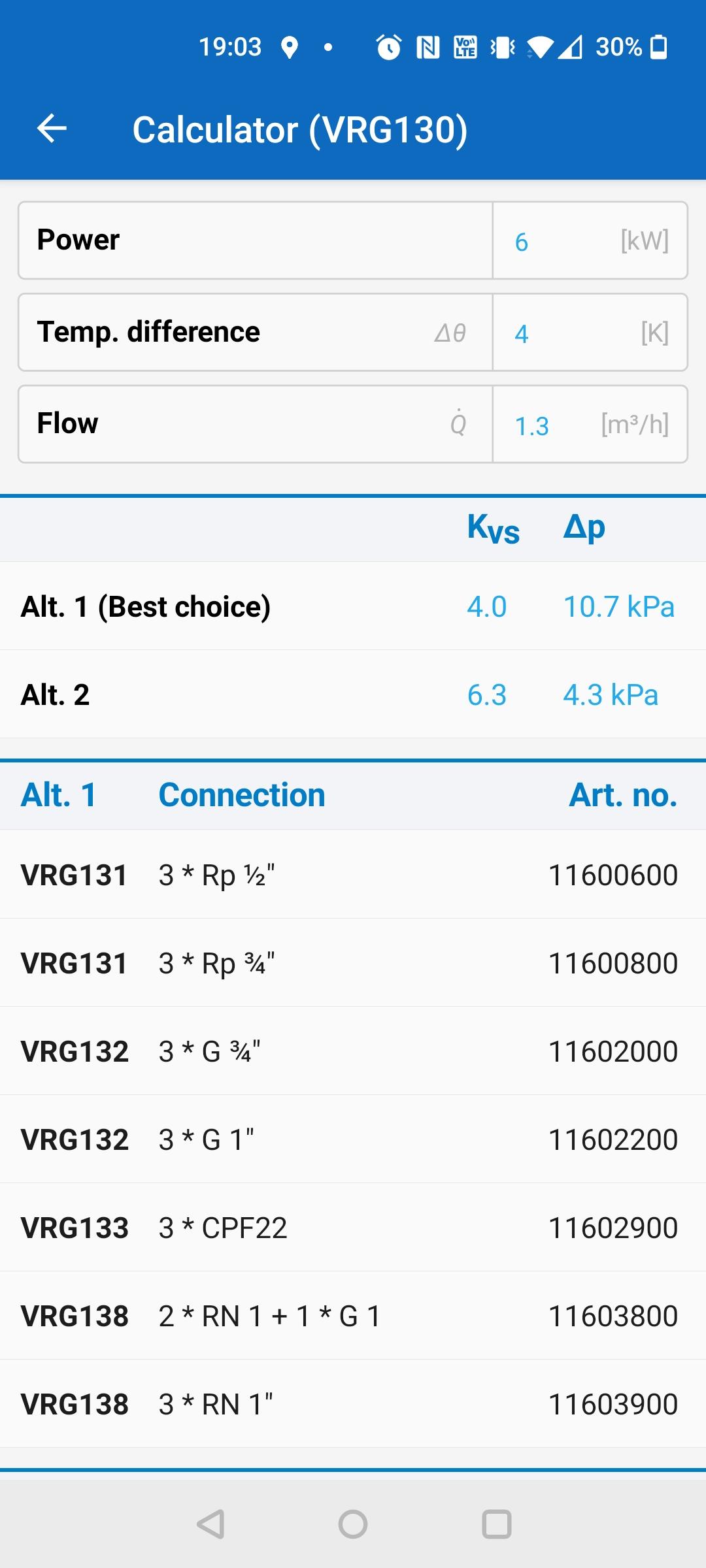

Lofty718 Posted February 4, 2024 Share Posted February 4, 2024 (edited) @JohnMo Are you sure your valve is sized correctly? it's very important to get the right KVS value(mine is 1.6). I researched and sized it myself and it spends a lot of time in the mid position so I know it is doing it's job. Look into valve authority it's very important that they are sized for the correct pressure loss/circuit size, esbe has an app that does it for you. 30 minutes ago, Adsibob said: So how much is an esbe valve and pump? And how many of these would I need? Is it one per manifold? Or one per loop? It would be one esbe valve per zone. One valve can do multiple manifolds, in theory you could run the whole house off of one valve and one pump, which is why I said your system would of been cheaper this way. edit - I'm not 100% one valve can do mulitple manifolds, maybe someone more experienced could answer that with more certainty. -No mixers on manifold -No multiple thermostats -No actuators on manifold -Less pumps The esbe actuator you want is an ESBE ARA662 (I got one off ebay for 80 quid) then as mentioned above you would buy a seperate 3 way valve that is sized correctly for the KVS value of the circuit. The valve would be a VRG131 valve they come in about 80 different sizes so it's crucial the valve is sized correctly Edited February 4, 2024 by Lofty718 Link to comment Share on other sites More sharing options...

JohnMo Posted February 4, 2024 Share Posted February 4, 2024 1 hour ago, Lofty718 said: Are you sure your valve is sized correctly? it's very important to get the right KVS value(mine is 1.6). I researched and sized it myself and it spends a lot of time in the mid position so I know it is doing it's job. Look into valve authority it's very important that they are sized for the correct pressure loss/circuit size, esbe has an app that does it for you. Yes it's sized correctly for my kW, flow and delta T. 22mm VRG133, ARA600 actuator, driven by ESBE CUA111 Controller. I used Kvs 6.3. Couldn't find a Kvs of 4 at the time. But I use mostly fully open as I am batch charging at the moment. Flow will start at about 28 at the start of the charge period and slowly increase 3 to 4 degrees as the floor warms up over the next hours. Max temp could go up to 33 on a cold day, so is set to 33 all the time, except at the end of the batch charge and it closes down to fully shut. Currently have it set I get a continuous run of the heat pump for about 8 hrs. When I did a fixed flow of 28 it would sit middle of dial and move about from there depending on flow temp. Link to comment Share on other sites More sharing options...

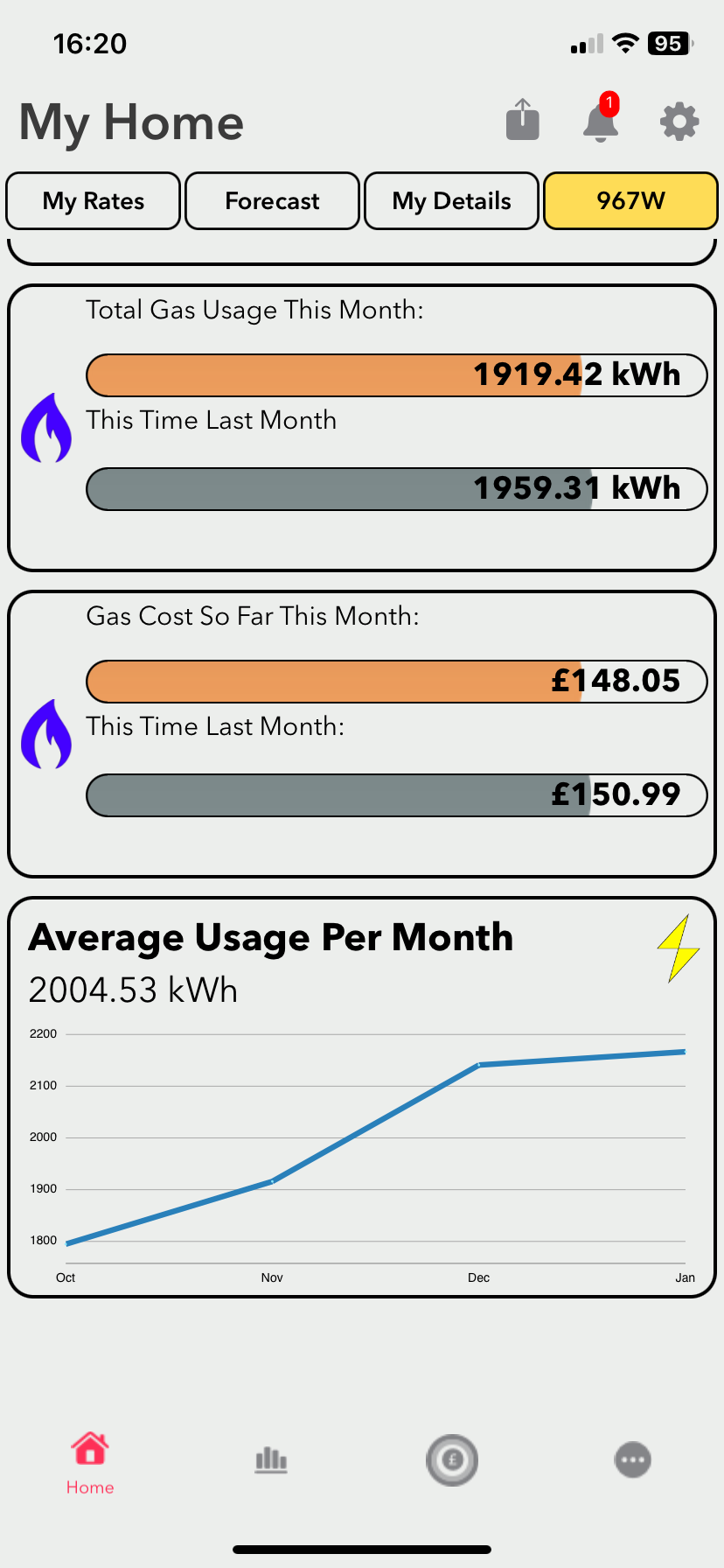

TonyT Posted February 25, 2024 Share Posted February 25, 2024 (edited) See my gas consumption for last month, heating on for 45 minutes in the morning before we got up and in the evening for an hour, plus any time extra we were cold. house felt too warm and too cold at times we are in a Scotland. This month the weather compensation has been activated from 6am to 11pm house is constantly at an even temp. gas is also used for cooking and HW Edited February 25, 2024 by TonyT Link to comment Share on other sites More sharing options...
Adsibob Posted February 26, 2024 Author Share Posted February 26, 2024 (edited) 23 hours ago, TonyT said: See my gas consumption for last month, heating on for 45 minutes in the morning before we got up and in the evening for an hour, plus any time extra we were cold. house felt too warm and too cold at times we are in a Scotland. This month the weather compensation has been activated from 6am to 11pm house is constantly at an even temp. gas is also used for cooking and HW So are you saying there is not much difference, WC giving you a more even temperature at a small, negligible, saving? But what about the savings from converting to high temp output to low temp output? Edited February 26, 2024 by Adsibob Link to comment Share on other sites More sharing options...
TonyT Posted February 26, 2024 Share Posted February 26, 2024 Not following, that’s my savings, house is warm all the time and a bit cheaper than what it was when it was on/off controlled, back then it could be too hot and too cold Thats for my house, with my gas boiler. so I’m sure with your recently modernised house you will see savings Link to comment Share on other sites More sharing options...
