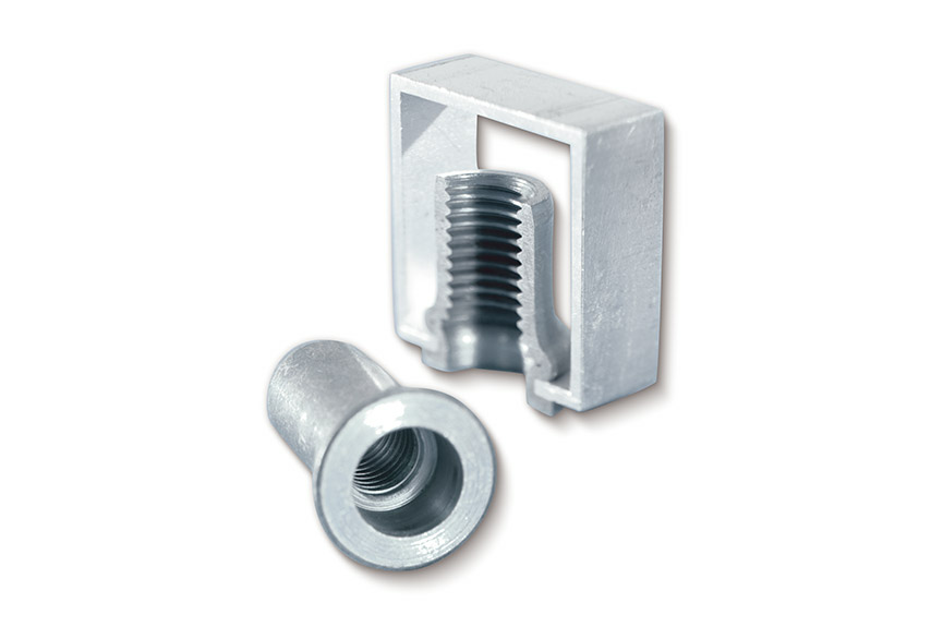

SimonD Posted February 14, 2024 Author Posted February 14, 2024 On 13/02/2024 at 12:07, joe90 said: I had not heard of holo bolts before (basically rawlbolts for steel?). However can you not fix the holobolts to the steel then remove the short bolt and replace it with a standard long bolt through the posts ?, the holobolt becoming a captive nut with the box section @ 8mm thickness? This is what they look like as used for fixing all the joists to the steels. No possibility of removing and then replacing the bolt as the whole fixing is the structural element. On 13/02/2024 at 12:40, markc said: Yes you can swap the fixings once the hollobolt (big Rivnut) has been set. On 13/02/2024 at 12:42, Alan Ambrose said: I don't know what corrosion protection you're planning, but maybe 'rivnuts' e.g. https://www.accu.co.uk/knurled-flat-rivet-nuts/69619-HRKN-M6-16-A2 Use a homemade or bought in setting tool. Thanks both, you've put me onto Rivnuts as an alternativ option but I'm struggling to find structural data for the rivnuts used for wider sections. On 13/02/2024 at 09:25, BotusBuild said: Instead of Hollo Bolts, what about some M12 stainless steel threaded rod right through the box section, with a nut on either end? This is something I briefly considered but followed the guidance of the SE and suggested fixings. I may just review this as an option. On 13/02/2024 at 12:46, JohnMo said: Bit of an observation, from the drawings the drop looks quite big, so do you need a structural design to ensure your design is robust enough? It's 3 meters drop so yes, I need to ensure it's robust enough. Currently the only option I know I can use is Interclamp/Kee Clamps tube clamp arrangements and depending on post diameter, I can install them up to 2m centres. Essentially what I want to do is come up with a design we like and then pass it by the SE as a final nod. 1
joe90 Posted February 14, 2024 Posted February 14, 2024 Not heard of rivnuts either (led a sheltered life me) these however would need inserting on the other side of the box so the bolt would extend right through the box section (better stability?) however would it crush the box section when tightened? I can see benefits in both and guess your SE would specify which was best 🤷♂️
JohnMo Posted February 14, 2024 Posted February 14, 2024 14 minutes ago, joe90 said: Not heard of rivnuts either (led a sheltered life me) these however would need inserting on the other side of the box so the bolt would extend right through the box section Thing with rivnuts you drill a hole in a plate or box section on the side you want to bolt. They go in the hole and you deform them so they compress against the base material. They don't go on the opposite side of the box section. Used hundreds building cars and kitcars. 1
