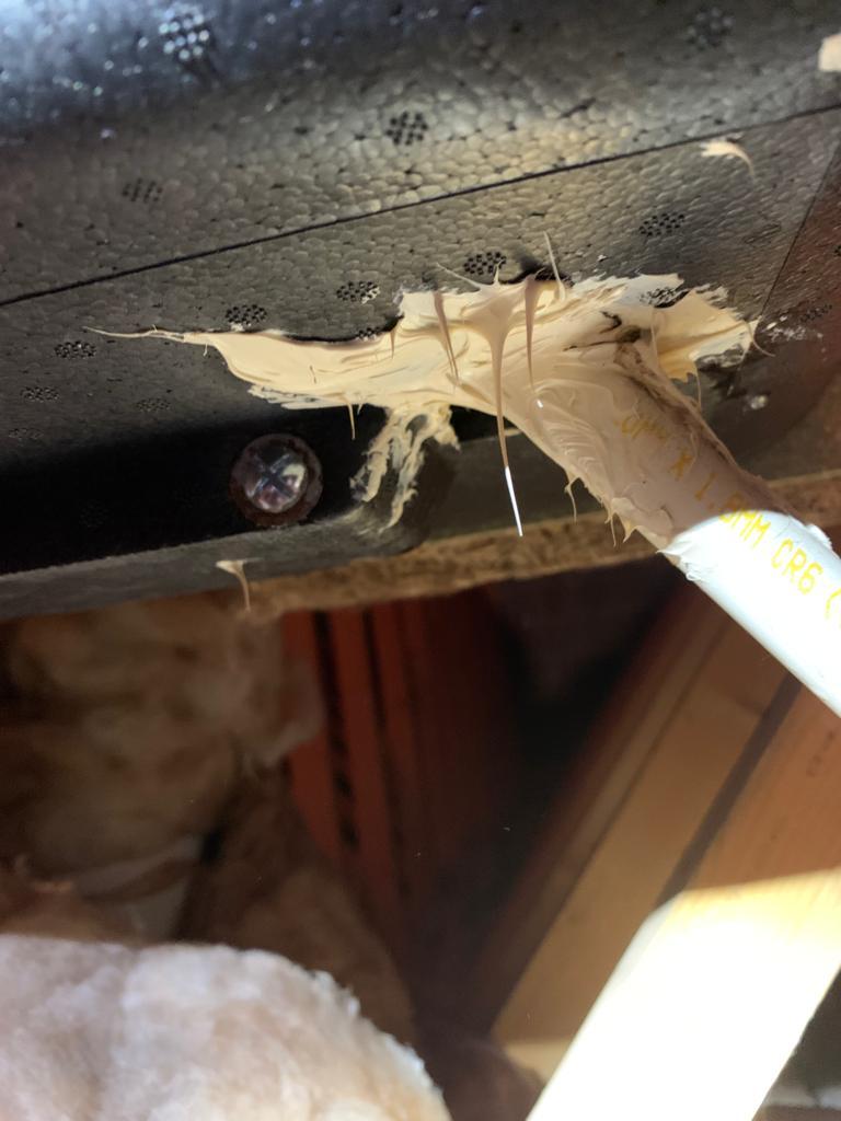

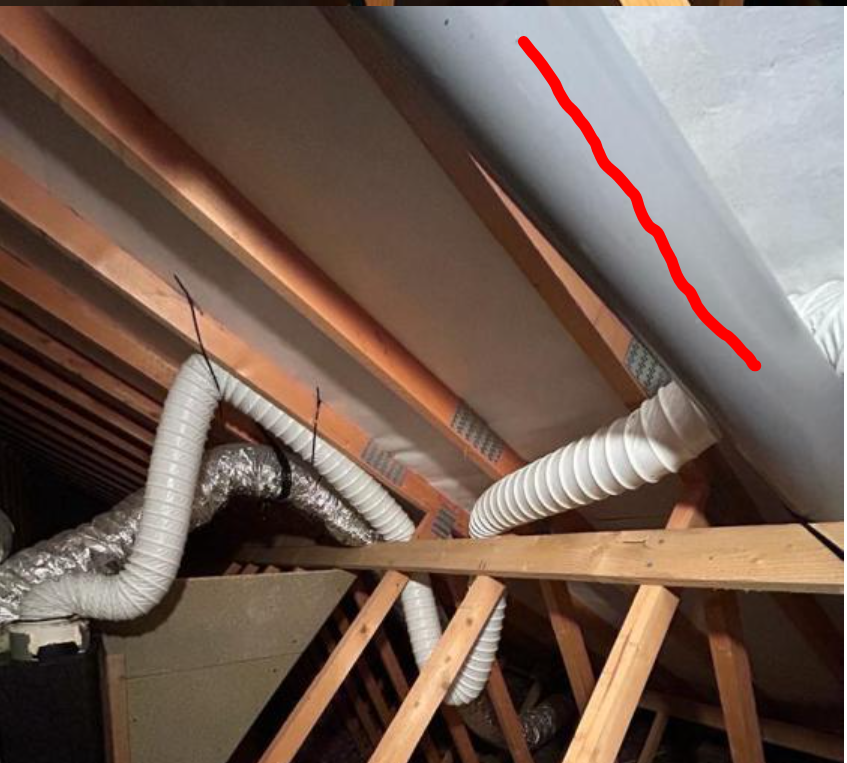

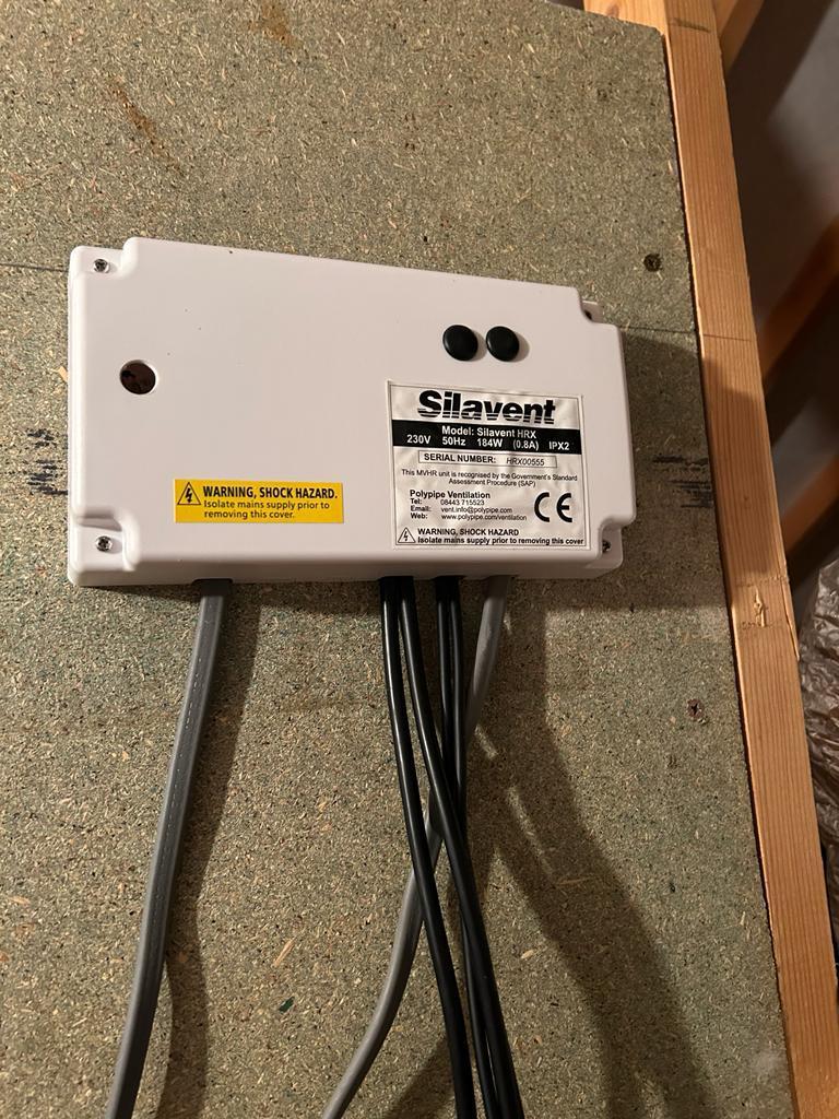

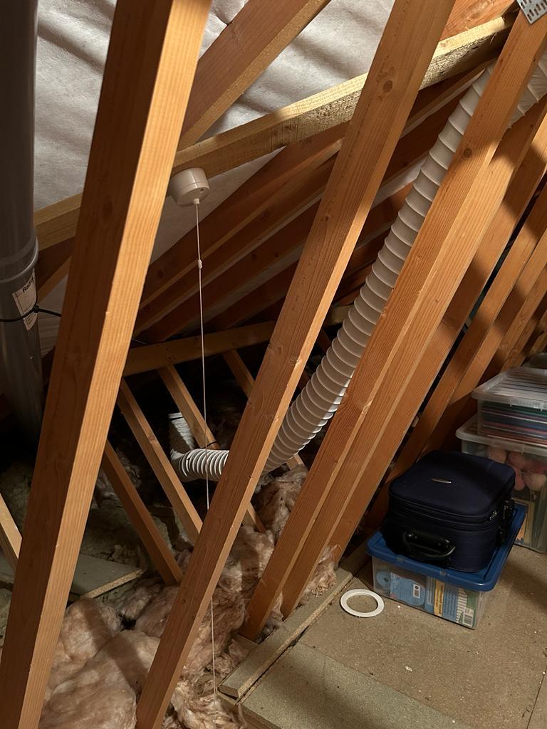

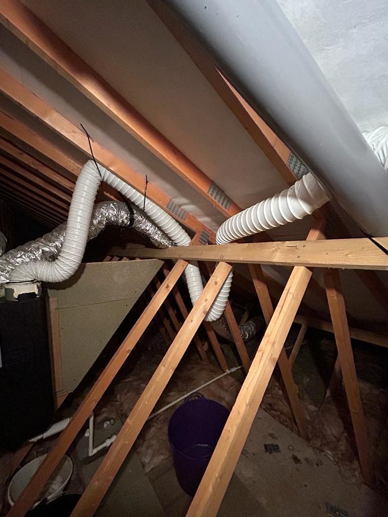

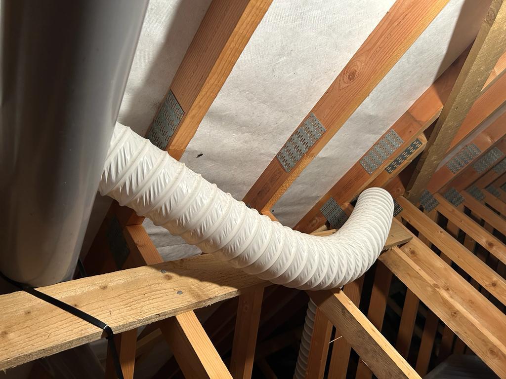

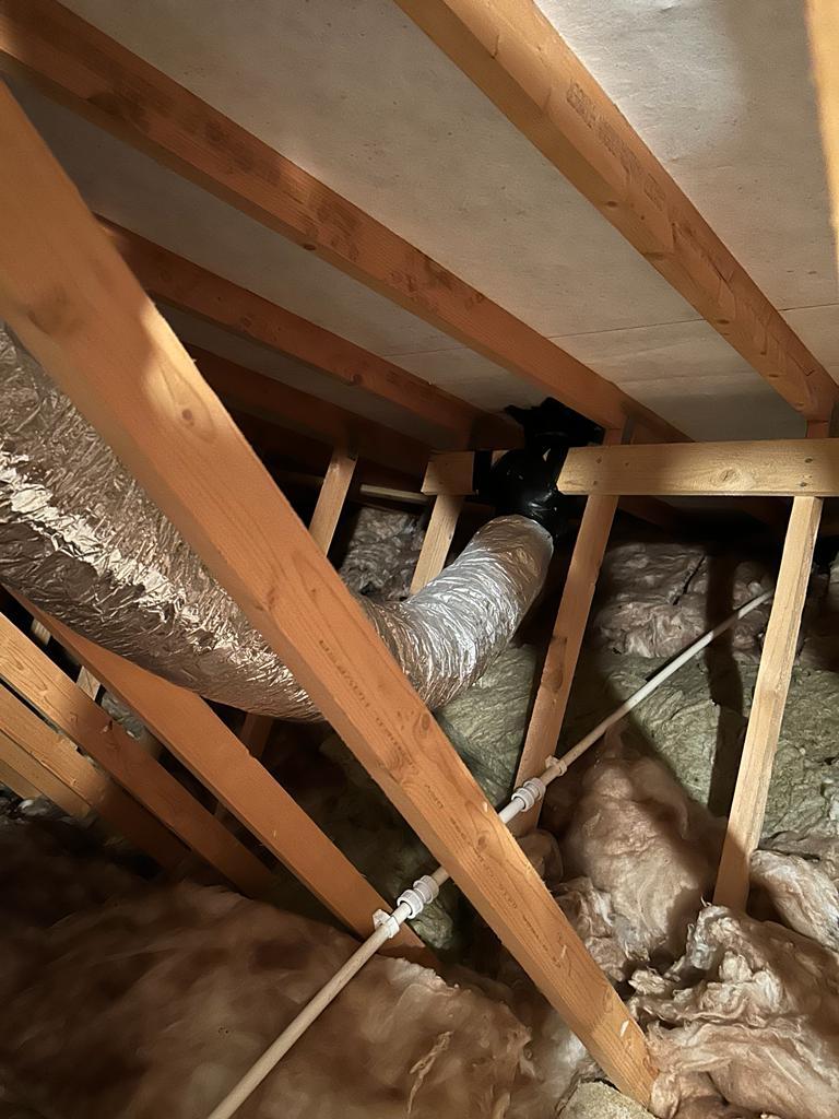

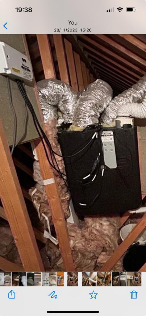

hotnuts21 Posted January 10, 2024 Posted January 10, 2024 A friend of mine has a newish house (10yrs ish old) and it's has a cheap MVHR unit in the loft. It's been ok, although its leaked a few times. About a month ago she was told a leak she'd noticed on the bedroom ceiling was coming from the small 'waste/condensate? pipe at the bottom which had been bodged with so much mastic the replacement parts weren't available and what they (local heating company) could get didn't and wouldn't fit. So she was advised to switch it off. She went into the loft this week and the small white pipe which goes up to a roof vent is full of water and dropping in places. I'm gonna go and hopefully help her drain them, whilst waiting for the quote for a new unit. Any tips on how greatfully received However, what I can't understand is where is the water coming from in the pipes? Why is so much building up with the unit off? I'm still looking to install my own unit, so all possibilities are a good learning experience too. Some photos below and wow my first though was mega bodge and amazed it lasted 10yrs.
Eric Posted January 10, 2024 Posted January 10, 2024 (edited) An absolute bodge as you have said. Water is probably condensation in the hoses. That type of hose shouldn’t be used, should be plastic pipe installed with flexible connections on the unit & silencers etc. I have installed a Vent Axia unit previously & was very pleased with it as with others on here. Probably best to disconnect all hoses & stop the water/condensation first. Edit. Unit in a cold attic needs to be well insulated along with the ducts. Edited January 10, 2024 by Eric Added info. 1
hotnuts21 Posted January 10, 2024 Author Posted January 10, 2024 This is/was the waste/condensate pipe that's been leaking and started the problems. Installed like this 🤮
Conor Posted January 10, 2024 Posted January 10, 2024 Complete shitshow. Tbh probably need a company in that knows what they are doing to redo the ducting and condensate pipework. Either that or spend a few a few hours here reading through the many posts and have a go yourself / help your friend out. Probably nothing wrong with the unit, it just looks like it was installed on a Friday afternoon by an unsupervised apprentice. 1
Russdl Posted January 10, 2024 Posted January 10, 2024 The white pipe filling with water looks like a tumble dryer hose! I presume it’s ‘exhaust’. I can’t quite work out the orientation of it, Is it just filling up with rain? What does the outside look like?
markc Posted January 10, 2024 Posted January 10, 2024 Condensate drain running up hill? No wonder it’s filling with water

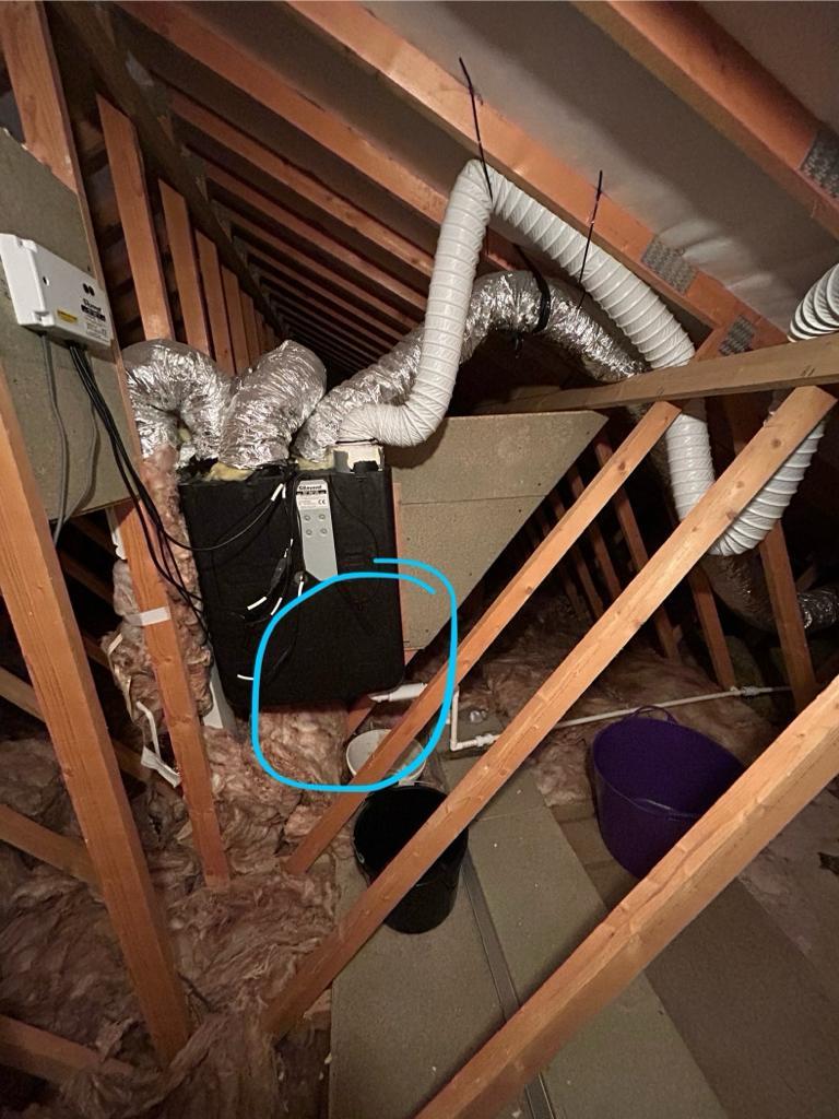

Marvin Posted January 11, 2024 Posted January 11, 2024 Oh dear! We have an HRX2 with no problems. However only after installing did we understand that all ducting and the MVHR unit needs to be inside the building thermal envelope to obtain proper benefits regarding saving heat in winter and cooling in summer!!! This is the "one way" waste connector we have fitted... https://www.i-sells.co.uk/domus-green-line-mechanical-ventilation-with-heat-recovery-condensate-drainage-kit-white?gclid=Cj0KCQiAwP6sBhDAARIsAPfK_wYvtNFQ06YTJNrp2FcwUG_o-N1L47Mj2wMqy8FUC0WHoCT-YlkamPMaAiSbEALw_wcB Our condensate waste pipe is down hill all the way! We have rigid ducting all insulated. We usually clean the filters every 6 months. Also think the bottom of the MVHR unit needs to be level. You really do not want to turn the unit off: Moist air entering the exhaust pipes from shower rooms etc will condense in the pipes rather than in the unit causing more problems!!! Marvin 1
Blooda Posted January 11, 2024 Posted January 11, 2024 13 minutes ago, Marvin said: https://www.i-sells.co.uk/domus-green-line-mechanical-ventilation-with-heat-recovery-condensate-drainage-kit-white?gclid=Cj0KCQiAwP6sBhDAARIsAPfK_wYvtNFQ06YTJNrp2FcwUG_o-N1L47Mj2wMqy8FUC0WHoCT-YlkamPMaAiSbEALw_wcB This what I Used:- Viva Magna Self-Sealing Waste Valve 32mm | Toolstation There looks like one similar in the blue highlight, but as the drain is going up hill then there's no hope of it draining @hotnuts21 She needs to get someone in to sort out the ducting and the unit will hopefully ok. Need to look for a local Refrigeration or HVAC engineer who should be able to sort it out. At the moment it has the potential to cause more harm than good. I bet the filters have not been cleaned / replaced, causing efficiency issues. Unrelated, but idea what this pipe is ? 1

hotnuts21 Posted January 11, 2024 Author Posted January 11, 2024 I also have to say I'm quite impressed that the black tape holding the inlet up and to the rafters has lasted that long 😄 But having another look at the condensate pipe run, im wondering why it seems to be going in the opposite direction to the soil vent and rather right to the eaves...
Blooda Posted January 11, 2024 Posted January 11, 2024 Simple but effective Check List from the Vent Axia Installation Manual More to it than that, such as the ducting should be rigid with a small section of flexi and that trap shows a wet trap. Flexi creates more turbulence which will affect performance / electric efficiency and more noise, also more likely to cause duct build up. Also more prone to damage. 2
