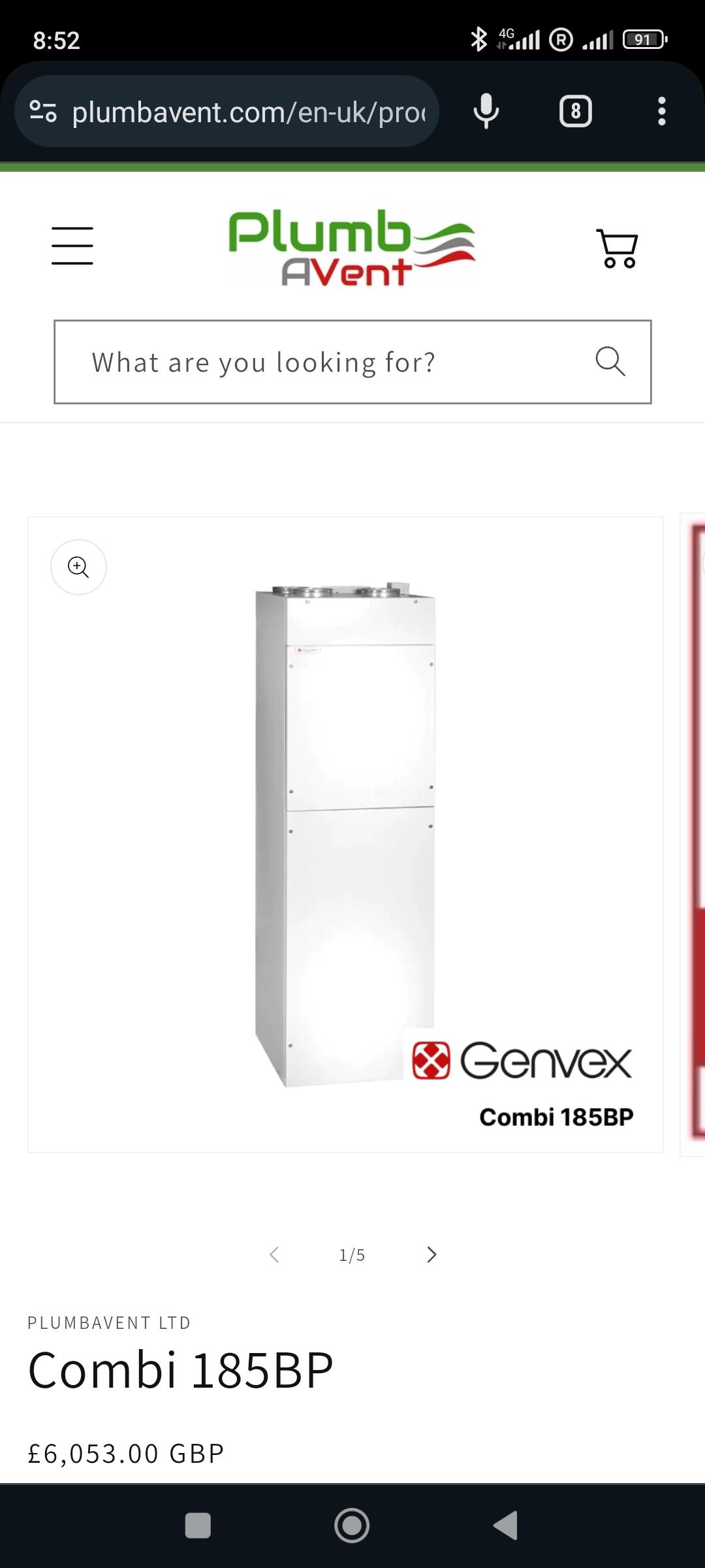

Joey Posted January 8 Share Posted January 8 1 hour ago, Iceverge said: That kind of cash would make it a much more attractive idea. At a rough guess for a 180m2 house. High quality MVHR unit ex ducting and manifolds. £2.5k ESHP cylinder for DHW £2500k A2A unit for space cooling+heating. £1000. A bit of money saved because of avoiding a few different installers. Catching up on an old thread earlier I saw a Genvex unit had only failed after 25 years. It could persuade me for a passivhaus. Haven’t come across that site before! After having a quick browse, it seems the Total Home Environment system they quoted £25k for is just a modified version of this with a fancy cover and couple of extra features… Sure this doesn’t include the water tank and ductwork, but it’s £21k less! Schematics and performance look almost identical. Link to comment Share on other sites More sharing options...
Gone West Posted January 8 Share Posted January 8 3 hours ago, Iceverge said: At a rough guess for a 180m2 house. IIRC our house was only 120m2 for PHPP. I think unless the fabric of the building is significantly better than PH maximum levels, ie overall values U=0.1, the combi 185LS would struggle to keep the house warm. That is unless the interior is around 20C, but we did keep ours at 23C. That Plumbavent site is a good find, I'd have rather dealt with a UK company than Danish. Link to comment Share on other sites More sharing options...
