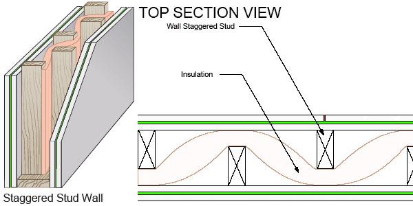

But putting aside thermal properties for a moment, neither EPS or PIR are very good for acoustic insulation. It might not be relevant for your current purpose, but it is another dimension to easily overlook.
+1, you need acoustic insulation (mass is good) or detachment ( staggered stud wall)

If you need acoustic insulation I would go for rockwool rwa45 between the studs or acoustic roll on metal frame and blue sound plasterboards with sealant over it.
If you need thermal insulation mostly and a bit of acoustic I would go for pir insualted plasterboard
Or something sharing most of the properties of rockwool. I've used BioFib Trio (cotton+linen+hemp) and it seems to be doing its job. It has similar heat conductivity and sound absorption properties to rockwool. Of course for sound insulation you also need mass (more than either rockwool or BioFib trio provide).
