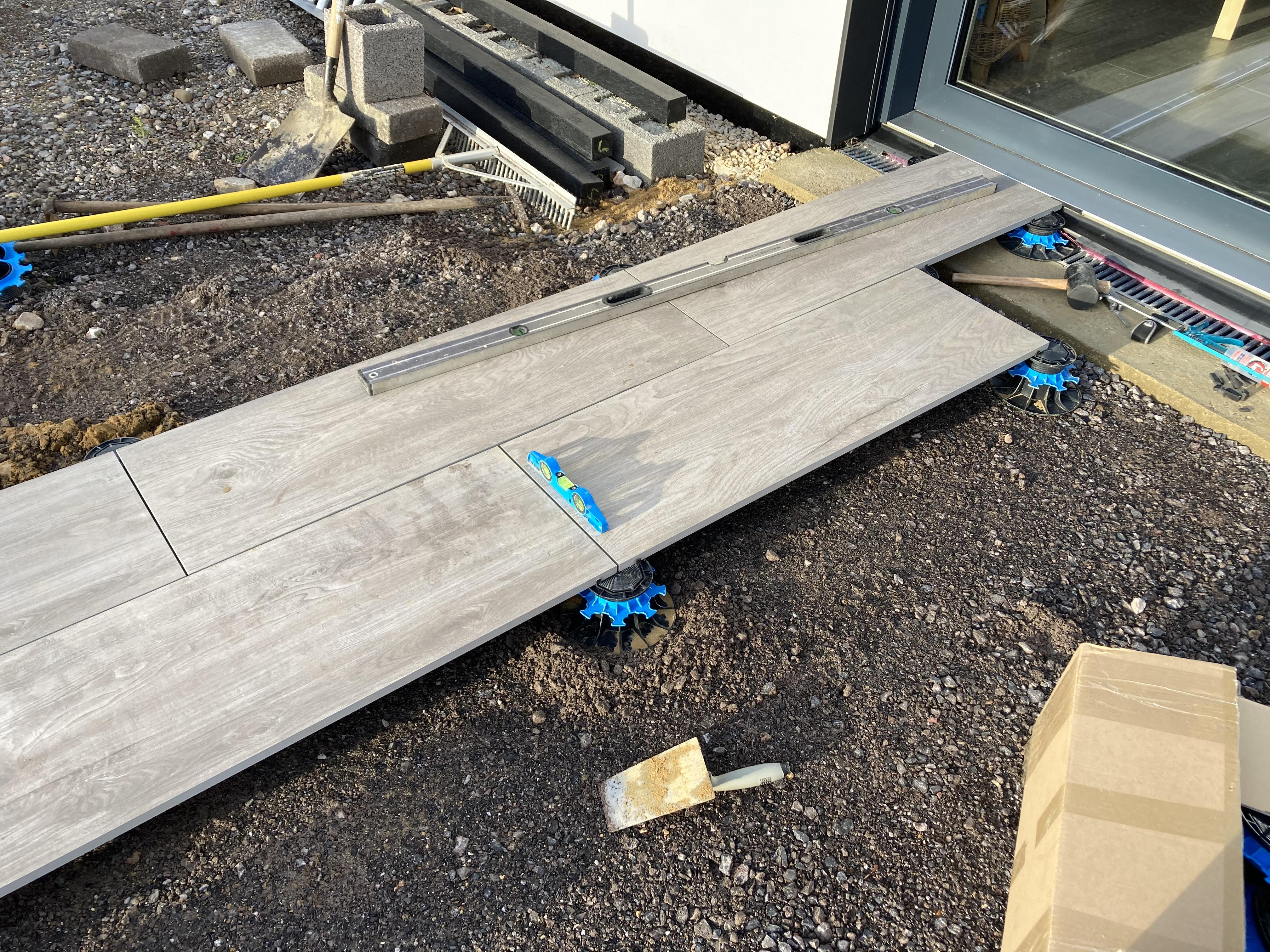

Russdl Posted January 5, 2024 Share Posted January 5, 2024 @richie9648 have you considered pedestals for your patio? The air bricks would remain unobstructed, and your patio could be pretty much level with the patio doors. We did that with the Aco below the patio tiles and out of sight. Link to comment Share on other sites More sharing options...
richie9648 Posted January 5, 2024 Author Share Posted January 5, 2024 3 hours ago, saveasteading said: Avoidable risks should be avoided. Not that we know how the house is built. Air bricks are to ventilate a suspended floor, but perhaps the floor is now ground-bearing. @richie9648 perhaps you can tell us. the building you see in the pic is an extension. Built before we moved in. It has a concrete floor which I am sure of the older part of the building is suspended timber flooring so I assume there is some ducting from the air bricks into the older part of the house 1 Link to comment Share on other sites More sharing options...
Russdl Posted January 5, 2024 Share Posted January 5, 2024 39 minutes ago, richie9648 said: so I assume there is some ducting from the air bricks into the older part of the house And probably needs protecting. If you’re not familiar with pedestals for a patio here’s a picture of ours, different build to yours but I’m pretty sure it would work and the pedestals would keep the air bricks free to do their job. Link to comment Share on other sites More sharing options...
