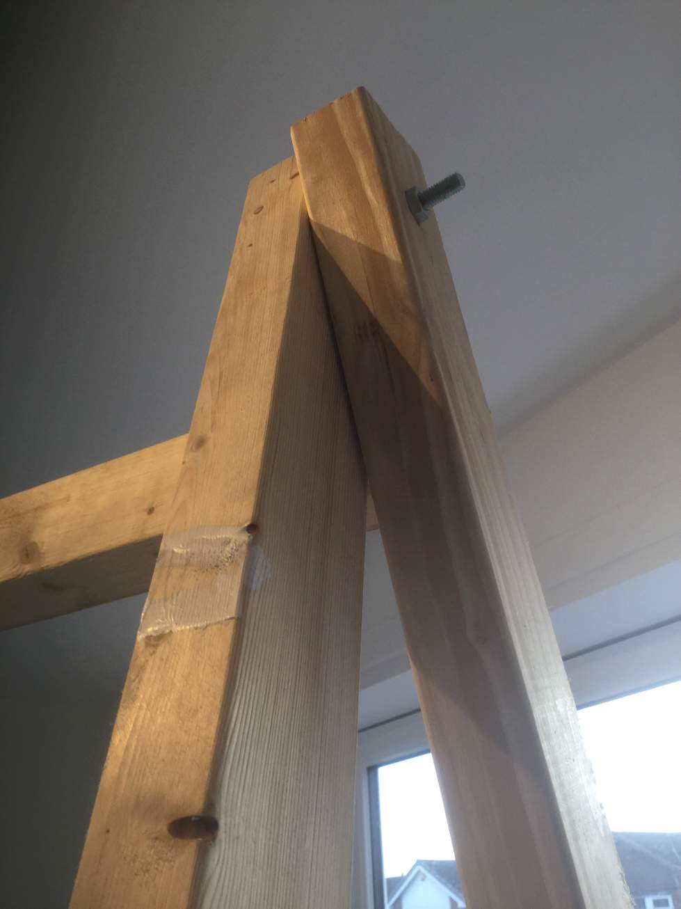

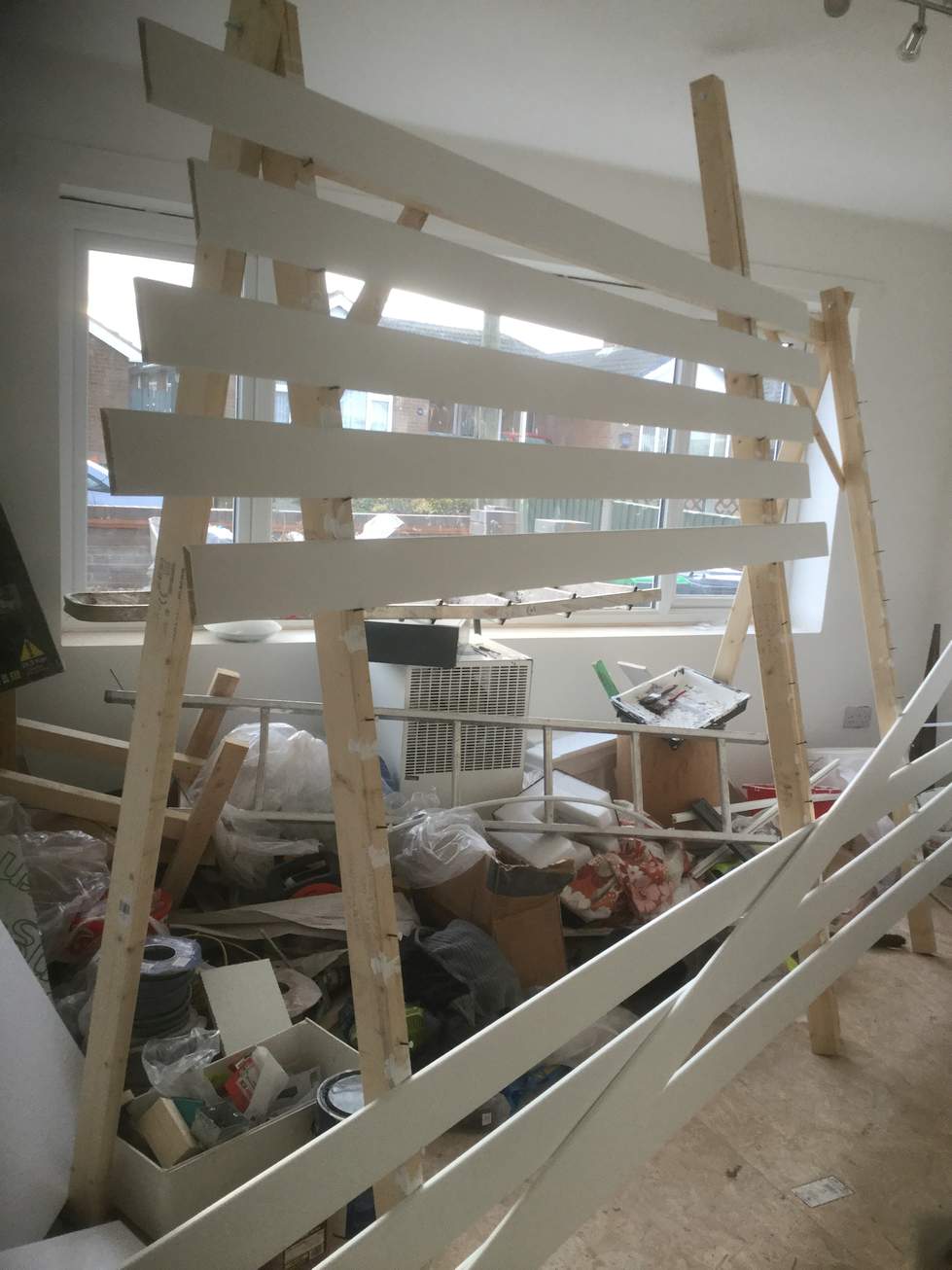

Ferdinand Posted September 18, 2017 Share Posted September 18, 2017 Following on from the other thread about paint sprayers, I now have one, and the next thing I need is to build some dismountable racks for supporting skirting boards for finishing / painting. I need enough to spray do about 32 4m lengths of skirting in one session, and I need to be able to store them in a small space for next time. My current thinking is for a pair of 2.4m CLS (bought too much CLS) A-frames, joined by a pair of horizontals each side which can be removed for storage. The skirtings to be supported by 2" screws driven 15mm in on the faces of the A-frames at 225mm intervals. That would give me space for 8x 4m or 5m lengths each side for spraying with a finish or paint. i was trying to do a diagram, but it was looking comical so I may just build one and take a photo. I wonder if anyone has any tested designs they could post? Thanks for any help. Ferdinand Link to comment Share on other sites More sharing options...

Declan52 Posted September 18, 2017 Share Posted September 18, 2017 Not just set them across 3 trestles. Could use the Bottom rung to hold a gd few, the top rung for some more then more with the extended bar up 2 holes. Easily get 15-20 lengths on it. 1 Link to comment Share on other sites More sharing options...

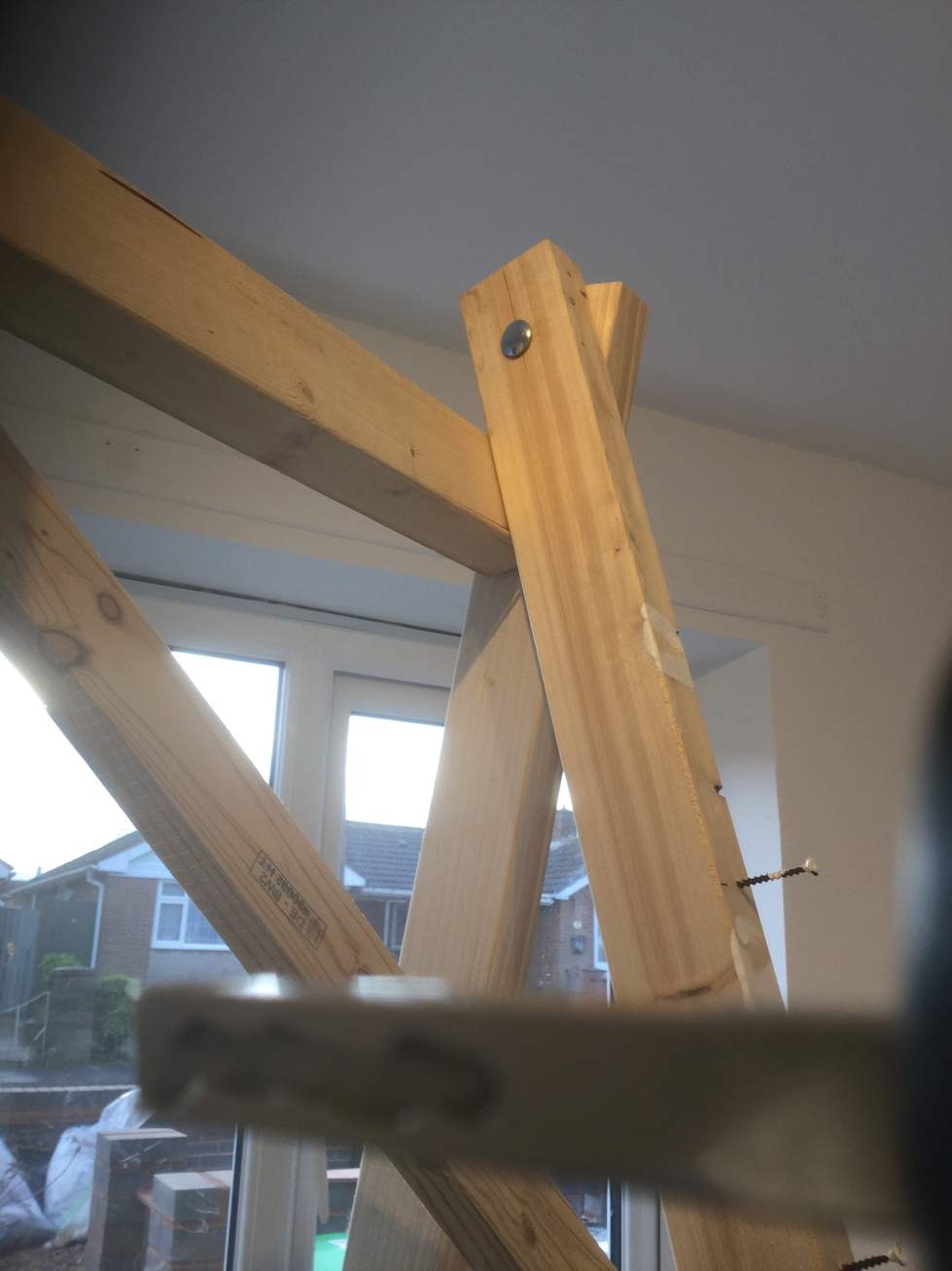

Ferdinand Posted November 26, 2017 Author Share Posted November 26, 2017 (edited) Reporting back, today I took a few pics of the A-Frames we ended up with. The verticals are about 2.1m high (ie lower than roof of shed for storage), and the horizontals are 2.4m. Once both sides have screws on it will hold about two dozen lengths of skirting. The extra vertical is for shorter lengths. It folds flat (2.1m x 2.4m x ~100mm !) to take to the shed, and *could* be dismantled. The important points were the brace for which we just screwed an angled timber, and that the horizontals are on the inside leg of the A so it folds OK. Ferdinand Edited November 26, 2017 by Ferdinand Link to comment Share on other sites More sharing options...
