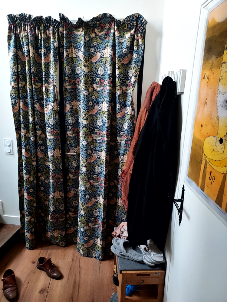

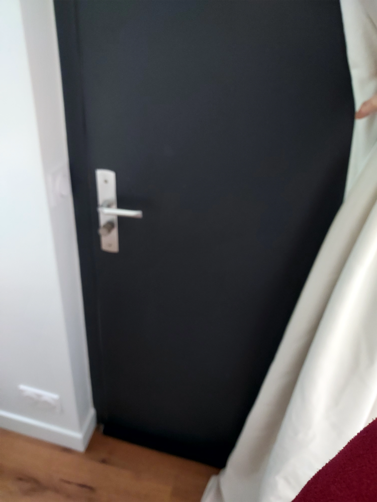

Garald Posted December 31, 2023 Posted December 31, 2023 I have two metal doors, one leading to a common corridor, the other one leading to a courtyard. Since they were installed by a previous owner, I have no information on whether there is any insulation inside, but there can't be much. I want to know how to improve insulation by attaching fabric or other materials to the door. If I understand correctly, there are basically two effective things one can do (since one needs much more thickness for effective insulation of a more conventional kind): a) convection barriers, b) reflective material (basically, "space blankets") What I have so far: 1) door seals/gaskets (work rather well - before, one could clearly feel a draft by wetting the back of one's hand and putting it on the door's edges on a cold day), 2) a Moondream thermal curtain, beige and ugly as sin, 3) on the corridor door, a William Morris curtain, with lining pocket still empty. Notes: - I used to think that 2) was just an overpriced curtain, but now I realize it must have a space blanket inside (since it is 99.99% polyester and 0.01% aluminium) - My parents and my girlfriend dislike both curtains, but 2) in particular, for non-identical reasons: my parents associate curtains on doors with extreme poverty, whereas the gf associates it with windows in Amsterdam brothels. Go figure. - My parents suggest https://www.amazon.fr/magnétique-thermique-Phonique-Isolation-extérieure/dp/B0BJ2XZDKR/ref=pd_lutyp_ci_mcx_mr_typ_d_d_sccl_1_2/258-6865142-2480719?pd_rd_w=7ub4t&content-id=amzn1.sym.7c1a512f-46a9-459c-9fcb-1c7b8864b865%3Aamzn1.symc.0e04ee4a-2b8c-44d8-b829-f6d01bf2800a&pf_rd_p=7c1a512f-46a9-459c-9fcb-1c7b8864b865&pf_rd_r=N33HFZP7ZADRK8GC1NFX&pd_rd_wg=XQmgG&pd_rd_r=54d45237-debc-459e-99e3-f2e1671ffab7&pd_rd_i=B0BJ2Z21VL&th=1&fbclid=IwAR2FUPTW2ARERdP9w81MtLRnG52fcKpLXomTXWRJzkMZSfYTYcW1Ro1bROE (which looks like a (heavy?) cotton curtain made for doors, nothing more) As I see it, I can do two things: - cover up the Moondream thermal curtain with that thing from Amazon - line the William Morris curtain with a space blanket, getting a local sewing shop to sew it into place (can space blankets be washed?). Comments?
Russell griffiths Posted December 31, 2023 Posted December 31, 2023 My neighbour has just done something similar ugly steel security door, drilled it full of 10mm holes and pumped in 3-4 cans of expanding foam, he then screwed oak tongue and groove boards to the face, it now looks like an old farm door, he had to add timber to the frame and pad out the architrave. It looks better than I probably described it. 1
SteamyTea Posted January 1, 2024 Posted January 1, 2024 Basically, reflecting thermal energy is not going to be very good, so that only leaves you with the option to add some sort of sheet insulation material. Or maybe fused silicone (aerogel). If you have the option to add thickness to the door, even 20mm of phenolic is going to help. Post up a picture and see what the creative minds can come up with. On 31/12/2023 at 16:14, Garald said: parents associate curtains on doors with extreme poverty Expand When I was a kid back in the 1960s, we lived in Holland, many of the houses/flats has rugs on the wall. This was a response to the Hongerwinter 20 years before. If I see rugs on walls now I see it as an act of defiance rather than poverty. On 31/12/2023 at 16:14, Garald said: the gf associates it with windows in Amsterdam brothels. Expand Never seen an Amsterdam one, but passed by a lot of Den Haag ones. There was a brothel at the end of our street. When my parents needed a babysitter, that is where the girls came from.
Garald Posted January 1, 2024 Author Posted January 1, 2024 (edited) On 01/01/2024 at 06:53, SteamyTea said: Basically, reflecting thermal energy is not going to be very good, so that only leaves you with the option to add some sort of sheet insulation material. Or maybe fused silicone (aerogel). If you have the option to add thickness to the door, even 20mm of phenolic is going to help. Expand I thought reflecting thermal energy and stopping convection were the only thing one could do with trivial thickness. Is 2cm of anything (that is, anything other than a vacuum) really going to help more? (I thought phenolic should be used only on the outside, due to potential toxic emissions? Of course for all that I know there may already be phenolic inside the door.) On 01/01/2024 at 06:53, SteamyTea said: Post up a picture and see what the creative minds can come up with. Expand Here's the beige curtain that most likely has a space blanket within it, as part of the lining. OK, OK, if I keep this ugly beige curtain, I'll have its bottom part hemmed. Behind it: OK, this second picture is so out of focus that you can barely see the new seals on the side and on the bottom. They help. The same kind of door is hidden behind this nicer-looking curtain: On 01/01/2024 at 06:53, SteamyTea said: When I was a kid back in the 1960s, we lived in Holland, many of the houses/flats has rugs on the wall. This was a response to the Hongerwinter 20 years before. If I see rugs on walls now I see it as an act of defiance rather than poverty. Expand I think my parents are thinking not of "improvised supplementary insulation" but of "the landlords are too cheap to pay for doors, so they put curtains instead". On 01/01/2024 at 06:53, SteamyTea said: Never seen an Amsterdam one, but passed by a lot of Den Haag ones. There was a brothel at the end of our street. When my parents needed a babysitter, that is where the girls came from. Expand That sounds like the beginning of many an interesting story. Edited January 1, 2024 by Garald
SteamyTea Posted January 1, 2024 Posted January 1, 2024 So basically you have a flat panel door, can you stick a sheet of insulation on it without making it look silly? May need some hinge/frame/trim modification to help the looks. On 01/01/2024 at 09:47, Garald said: an interesting story Expand Are they brothel creepers.
Garald Posted January 1, 2024 Author Posted January 1, 2024 On 01/01/2024 at 10:25, SteamyTea said: So basically you have a flat panel door, can you stick a sheet of insulation on it without making it look silly? Expand That's the challenge, isn't it? You'd think that would be standard by now. I wonder why one can't just get it on IKEA or Amazon.

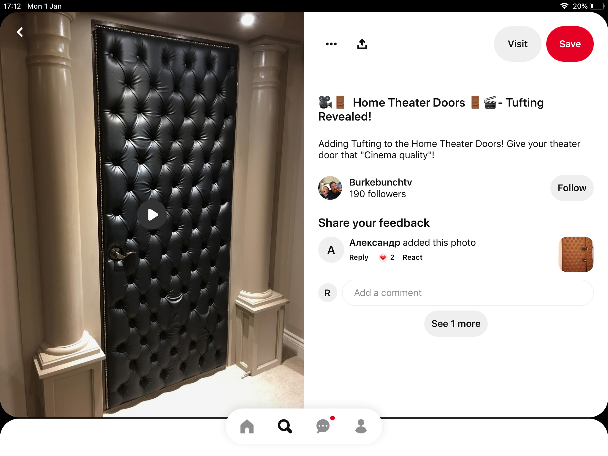

Russell griffiths Posted January 1, 2024 Posted January 1, 2024 What about the look of a gentleman’s library dark maroon leather in a diamond or hexagonal pattern.
Ferdinand Posted January 1, 2024 Posted January 1, 2024 If it is a rented property, are there limitations on what and how you can attach things to the door? Can you use something like Aerogel blanket (ie Spacetherm or similar) for your layer on the door face and then one of the suggestion above as a cover? Aerogel blanket is available in self-adhesive form, I believe - if you look around.
Garald Posted January 1, 2024 Author Posted January 1, 2024 On 01/01/2024 at 12:42, Russell griffiths said: What about the look of a gentleman’s library dark maroon leather in a diamond or hexagonal pattern. Expand Sure, would be nice, but where to get it?
SteamyTea Posted January 1, 2024 Posted January 1, 2024 On 01/01/2024 at 17:17, Russell griffiths said: how about this. Expand I was going to google 'tufting', but thought better of it. 1
Garald Posted January 1, 2024 Author Posted January 1, 2024 On 01/01/2024 at 13:41, Ferdinand said: If it is a rented property, are there limitations on what and how you can attach things to the door? Expand Ah, I see, someone here I haven't yet bored to death with my neverending renovation stories. No, it ia not a rented place :). On 01/01/2024 at 13:41, Ferdinand said: Can you use something like Aerogel blanket (ie Spacetherm or similar) for your layer on the door face and then one of the suggestion above as a cover? Aerogel blanket is available in self-adhesive form, I believe - if you look around. Expand Is Aerogel safe and flexible enough that it can be used as a curtain lining (where it might be partially exposed, unless it comes already hermetically enclosed in something)? I thought silica could be a bit problematic over time. I've just read that aerogel fabrics are now a thing, but it's unclear to me whether they are already in the market. But yes, I guess aerogel blankets could make sense behind sealed tufting. Should I wear a mask while cutting them? Is that enough?
Garald Posted January 1, 2024 Author Posted January 1, 2024 On 01/01/2024 at 17:17, Russell griffiths said: how about this. Expand Right - where can one get this sort of thing?
