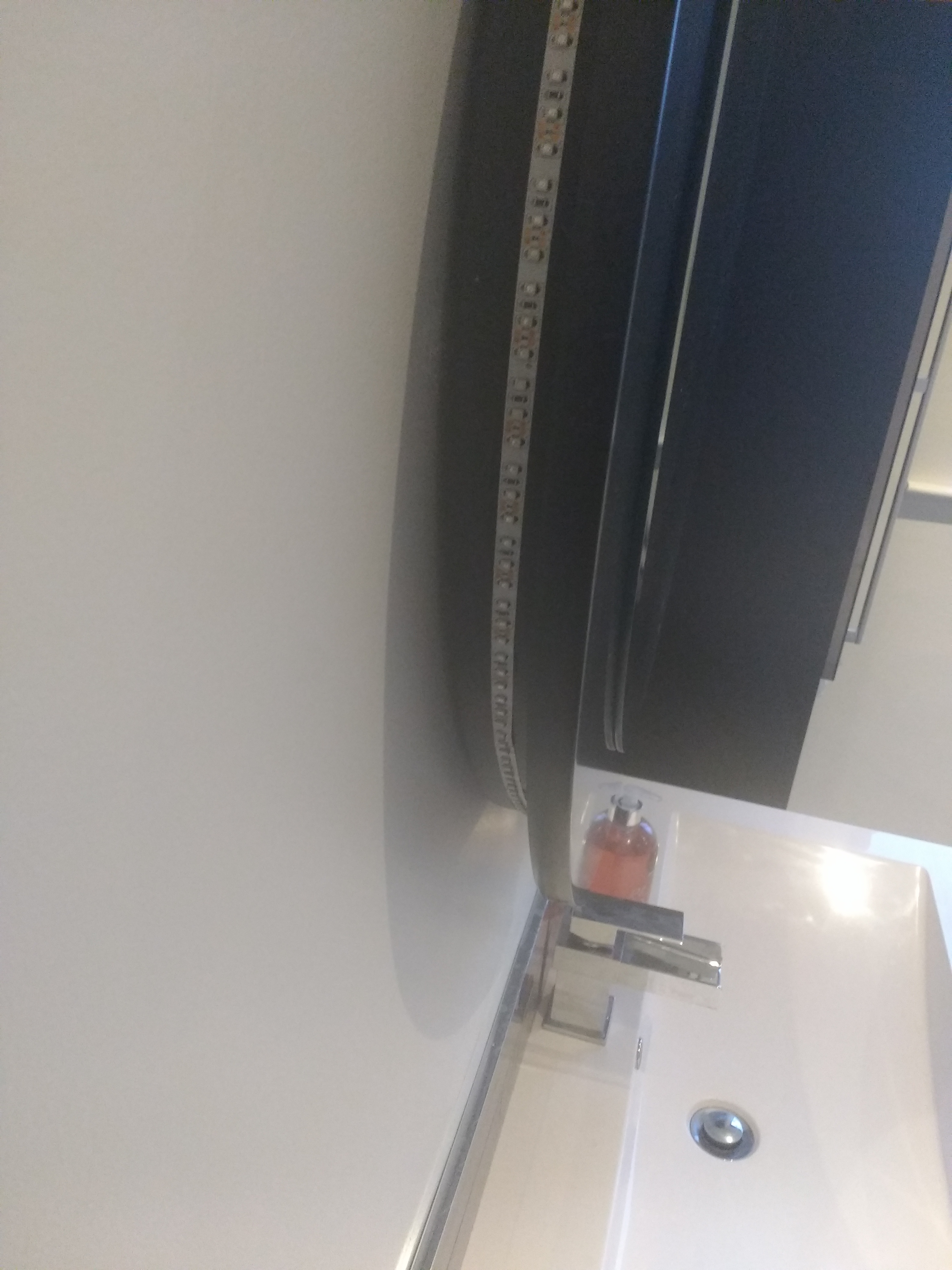

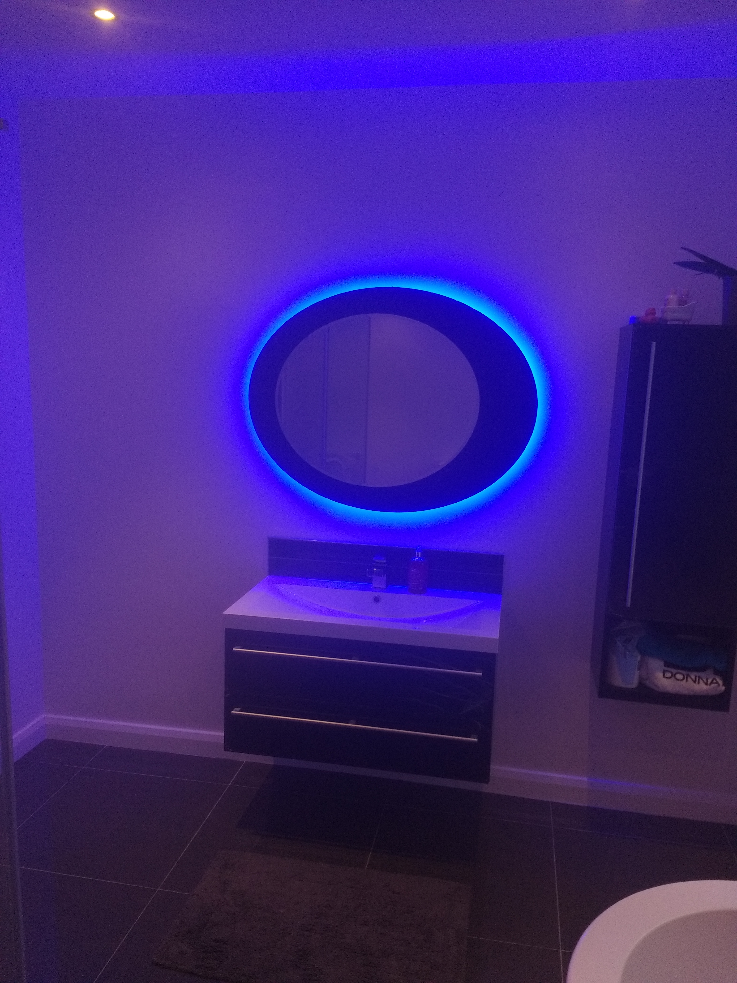

Declan52 Posted June 10, 2016 Posted June 10, 2016 I have led lights around my bathroom mirror. Same strip of Colour changing lights that I have in the kitchen. Will take a pic when it gets dark and post it later on.
Nickfromwales Posted June 10, 2016 Posted June 10, 2016 Ok, but minus the glow-in-the-dark undercrackers please
Declan52 Posted June 10, 2016 Posted June 10, 2016 Not sure why the pic has made the light purple its blue.
mafaldina Posted June 10, 2016 Posted June 10, 2016 If possible to offset the mirror from the wall a tad I would tuck an led strip of mini lights, warm white, just in behind the edge so the light comes out of the narrow space around. Hope that makes sense. A bit like Declan's lower pic, but tighter space and less offset (only need 10-15mm), it would mean remaking your 'frame'.
