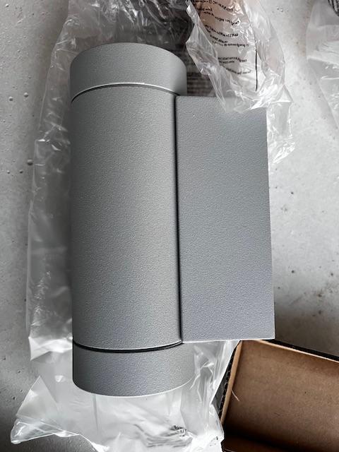

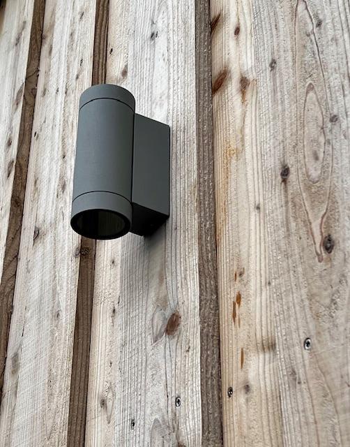

Kelvin Posted December 26, 2023 Posted December 26, 2023 1 hour ago, puntloos said: Yours seems to only downlight though, we'd prefer 'up' as well, at least in some areas. They are both uplight and downlight (doubles) and downlight (single) It’s why we went for them as we are using the singles (downlight) in the single storey section and doubles (up and down) in the 1.5 storey section. I’m down the plot later so shall take some pictures for you. 1

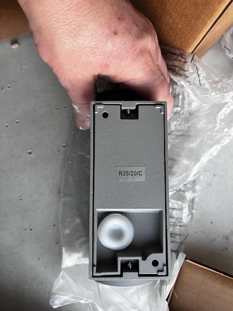

Kelvin Posted December 28, 2023 Posted December 28, 2023 (edited) The mounting holes have rubber grommets for the screws and the rest of seems well sealed against the rain. It’s certainly better made than what we had in the previous house and they never leaked. There’s a bit more wind driven rain here though. Edited December 28, 2023 by Kelvin 1
puntloos Posted December 28, 2023 Author Posted December 28, 2023 49 minutes ago, Kelvin said: The mounting holes have rubber grommets for the screws and the rest of seems well sealed against the rain. It’s certainly better made than what we had in the previous house and they never leaked. There’s a bit more wind driven rain here though. That's a nice attention to detail. I do hear that aluminium isn't great in rain though. How long have you had these?
Kelvin Posted December 28, 2023 Posted December 28, 2023 Fitted them today so about 3 hours 😂 They are powder coated. My son in law is an electrician and he rates them.
