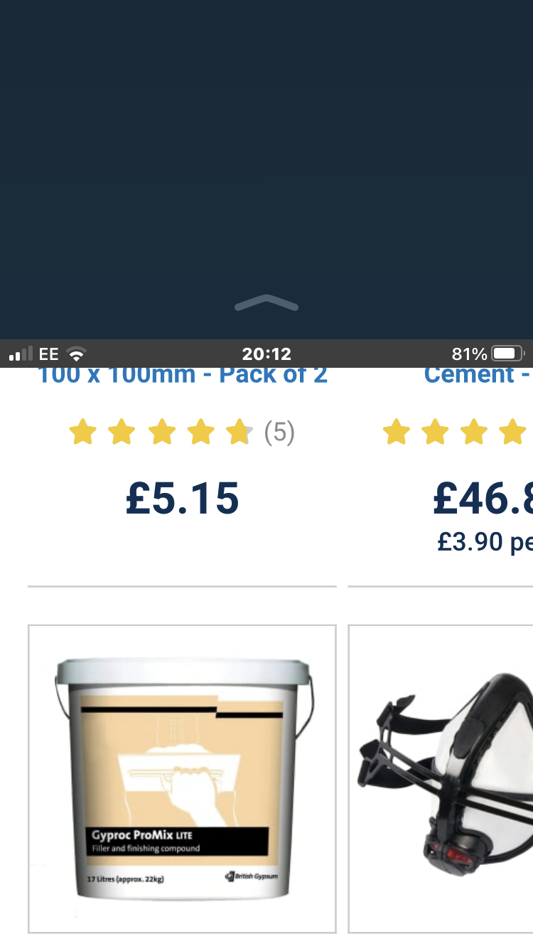

I'm now also at a finished skim coat stage and wanting to start to put some paint on the walls and ceilings, I've tried searching for the pro-lite filler @nod recommends but my search only comes up with a car body filler, can you point me to the product you use please ?
I'm more used to the automotive industry where anything resembling a shine gets sanded before painting, should I be giving my multifinish a fine sand before misting, or as plaster is porous does it not need it ? I've read both to sand and not to.
Thanks
Depends if the plasterer polished to a sheen (like the automotive) or not, if polished too much the rollers slide rather than roll to leave paint on the surface so if it’s polished, sand it.

Wickes have it Ready mixed
1 hour ago, nod said:
 Thanks, I was just searching for pro-lite filler.
