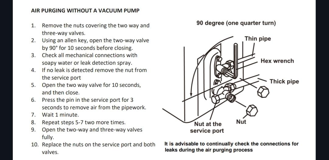

S2D2 Posted December 27, 2023 Share Posted December 27, 2023 +1 for R290 unit. You don't have to vacuum it down as it can be flushed with it not being an fgas. Better if you do, but mine has been fine. Link to comment Share on other sites More sharing options...
SteamyTea Posted December 27, 2023 Share Posted December 27, 2023 (edited) 16 minutes ago, S2D2 said: it can be flushed With this. https://www.ebay.co.uk/itm/266041448775 And one of these. https://www.ebay.co.uk/itm/353229779754 Edited December 27, 2023 by SteamyTea Link to comment Share on other sites More sharing options...
S2D2 Posted December 27, 2023 Share Posted December 27, 2023 6 minutes ago, SteamyTea said: With this. https://www.ebay.co.uk/itm/266041448775 And one of these. https://www.ebay.co.uk/itm/353229779754 Depends on the unit but the electriq one I installed claims no extra items required: Link to comment Share on other sites More sharing options...
