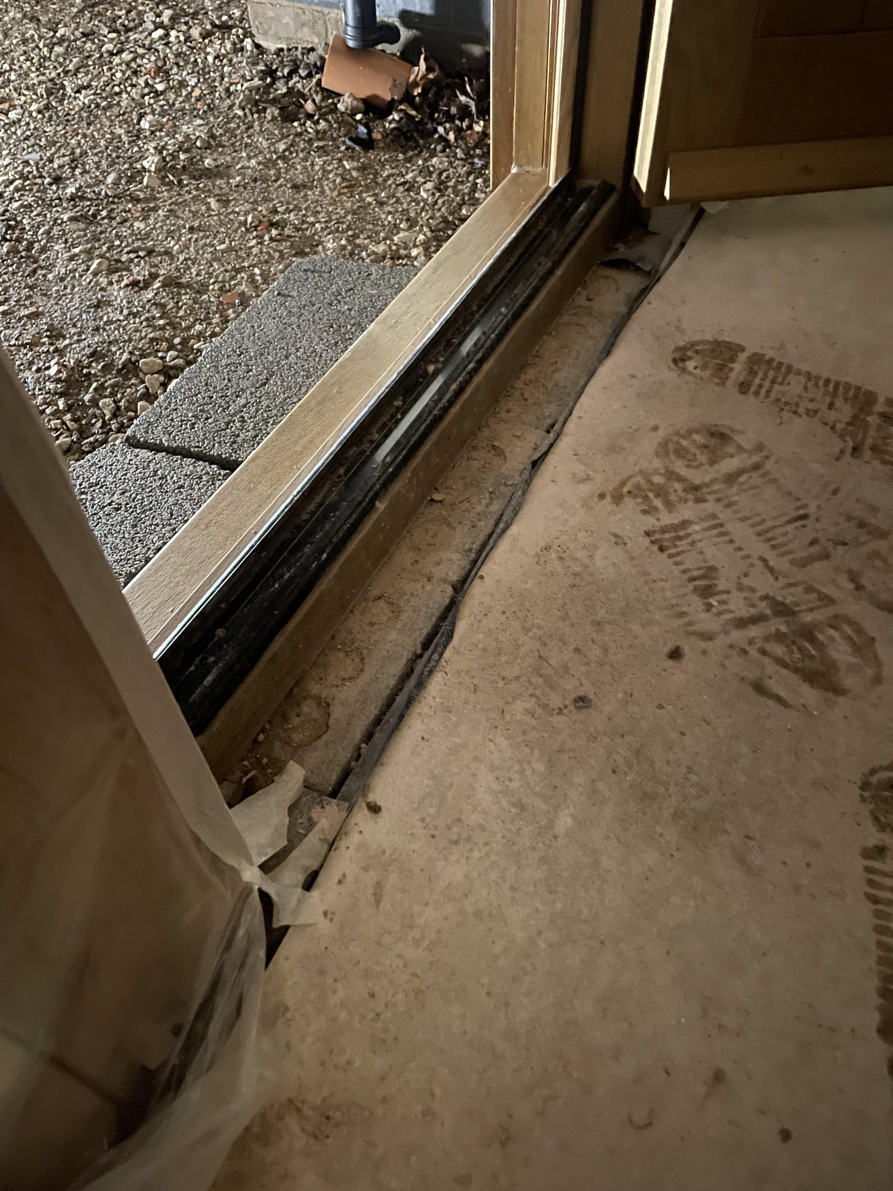

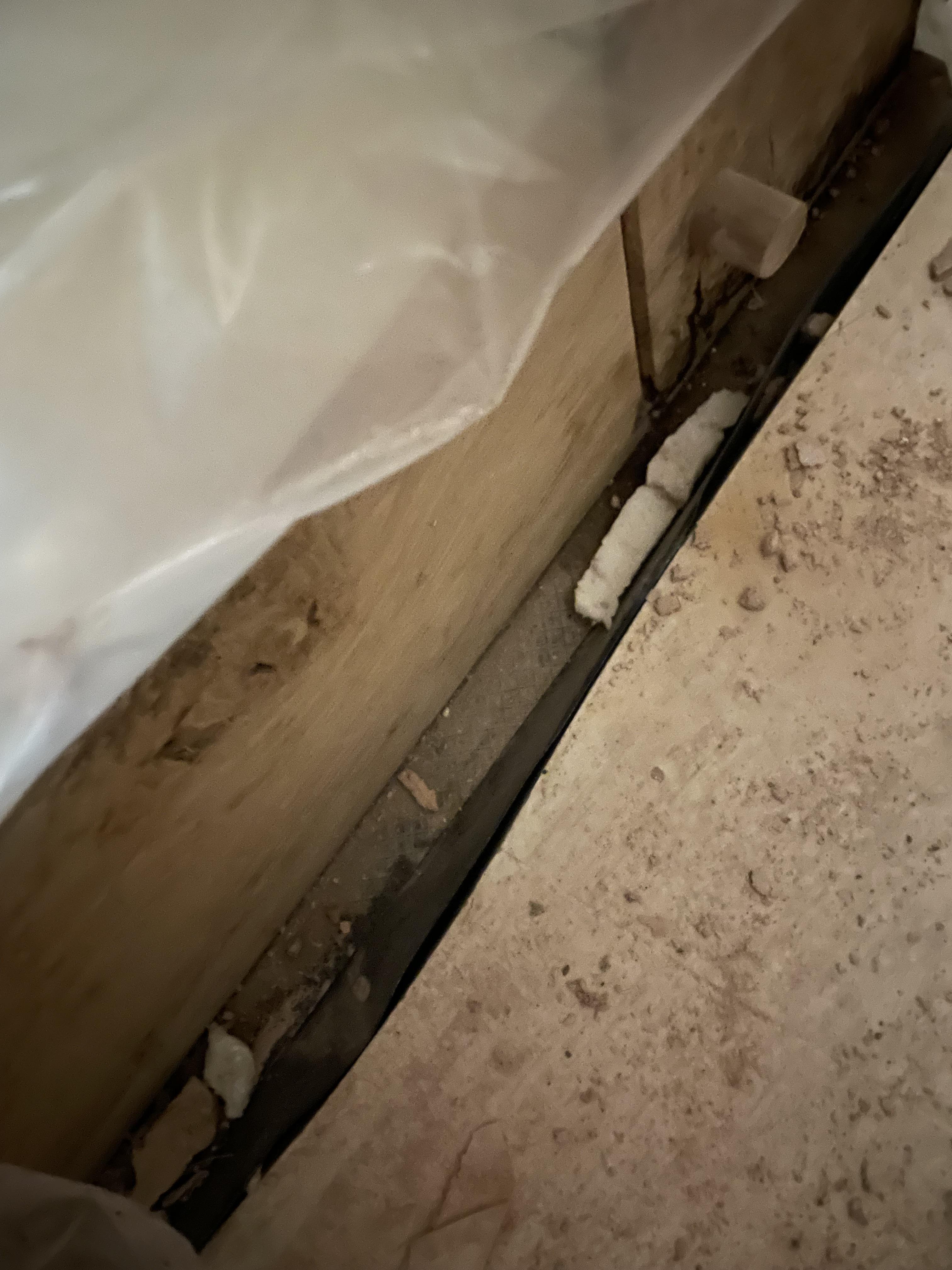

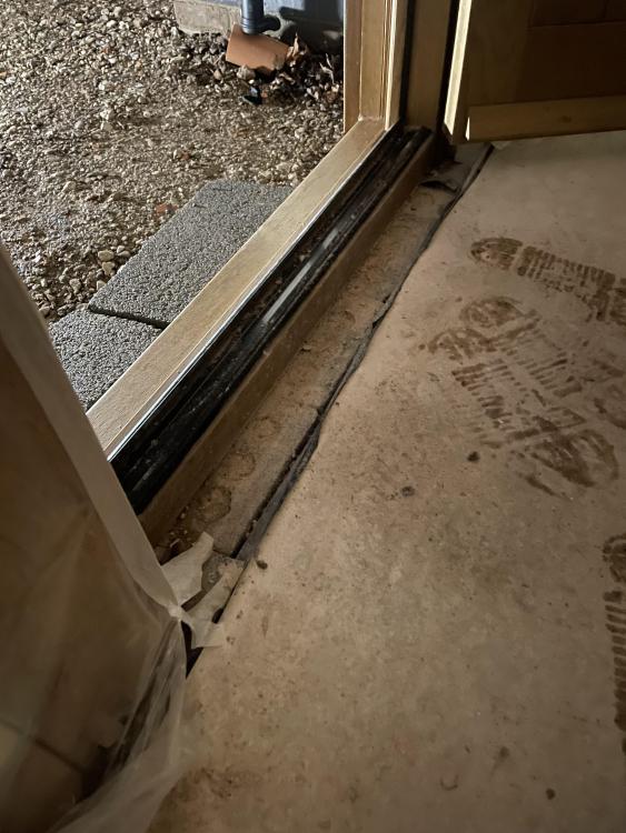

I also have another question relating to preparing the floor, as the company who did my screed floor protected the oak front and there is a large ish gap from the edge of the screed to the floor ( see pictures)
what is the best way to fill this gap? It’s about an inch deep and think it will need  like a lining to hold in the gap filler/levelling compound otherwise it will  run away I think.
apologies for the poor description in my problem but hopefully the pictures help!
