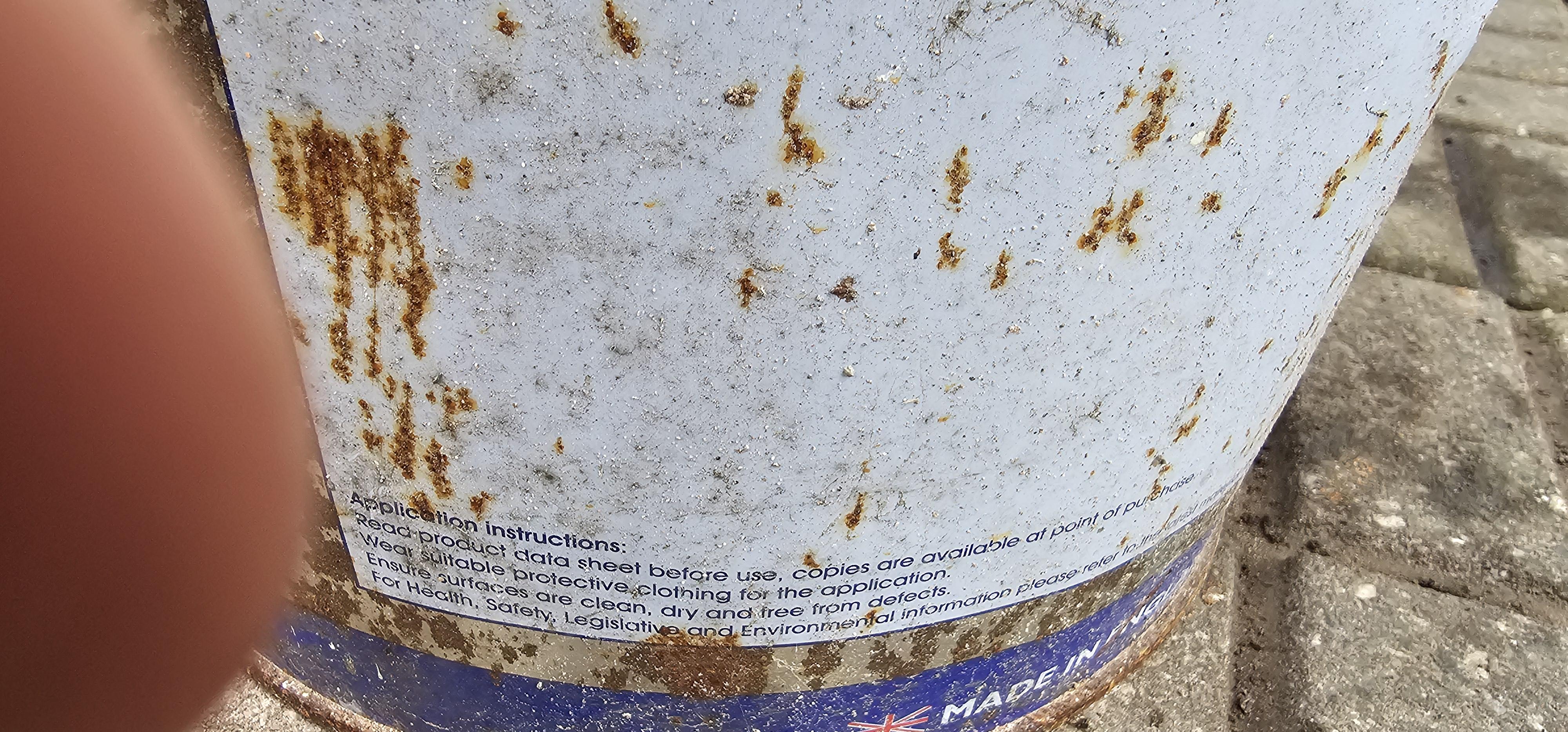

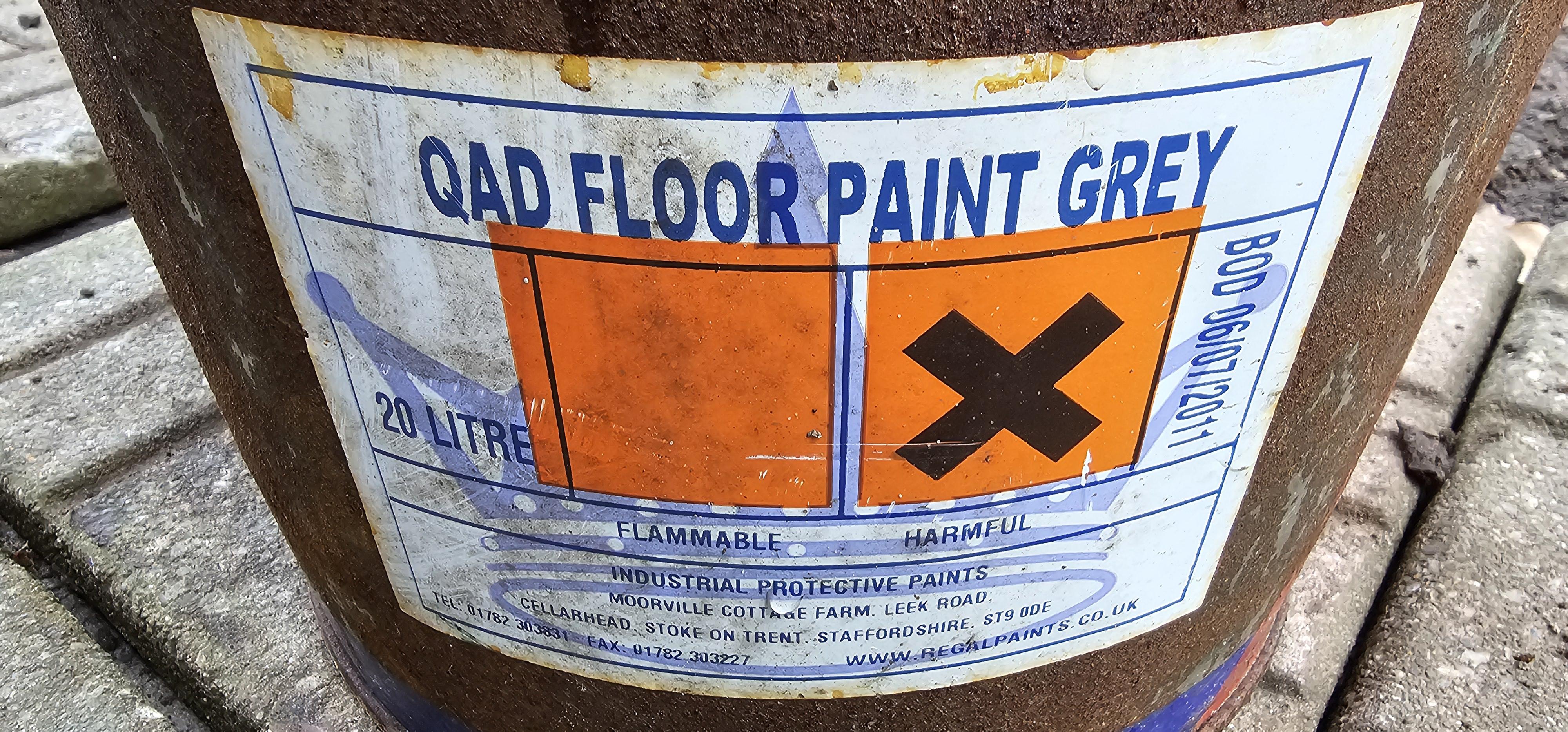

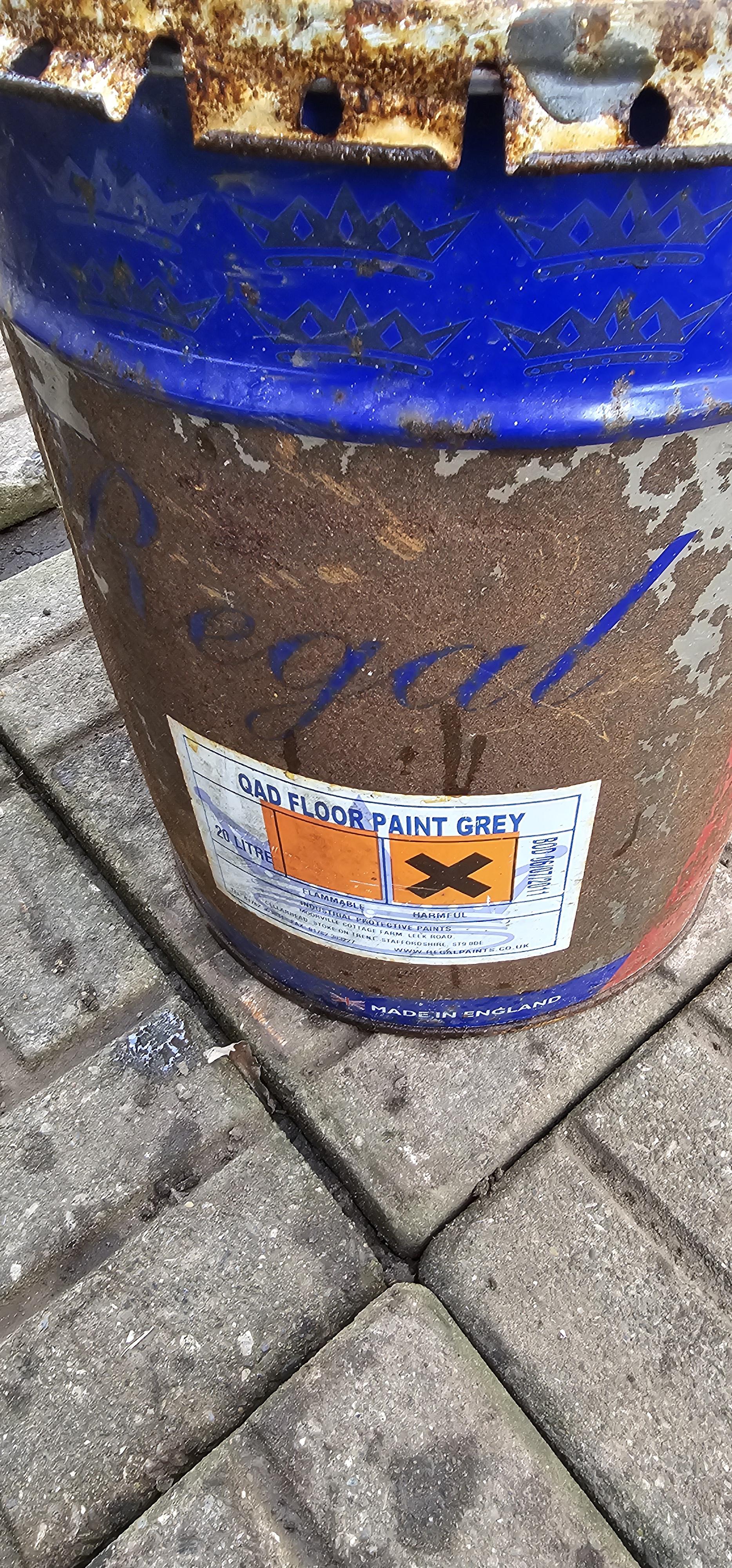

Have you got a close up of the label? The tin looks pretty ropey.
If you intend to park your car in the garage, I would buy some proper decent stuff.
Once you've put paint down, if it does lift you're in a world of headaches!!
Looks like the can is 12 years old... date on side....06/07/2011
I had some garage floor paint that was 6 years old and despite stirring lots it had lumps and didn’t leave a decent surface (tried on a small area) I binned it and bought some new stuff, glad I did. Give it a try on a small area.(no I didn’t thin it and gave it two coats),.
