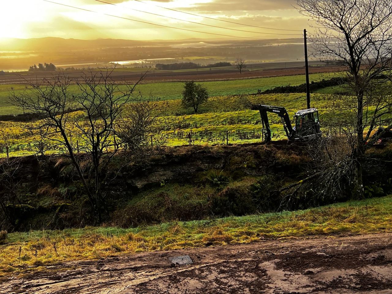

I need to make decision in where to put the PV installation. I’ve decided not to put it on the roof so it will be ground mounted. I have two places where it can go neither are ideal. One is on a bank so will require terracing to get some flat ground to mount it. It’s overshadowed by some trees which would impact early morning sunlight. The other location is on top of a bank. It’s already quite flat and ideally located for maximum sun exposure. However, it’s on top of a small cliff with a burn beneath it so I’d need to get the cabling down from here and across the burn. From there it would be in a trench back to the garage.
The digger is at the right most side of the panel location which will then run left for 21m approx, then down that small cliff, across the burn and into a trench back to the garage.

Ours is similar.  To get the SWA across the burn I went to the plot boundary where I erected a fence on the boundary line straddling the burn and the SWA crosses the burn fixed to the bottom of the fence.
You could also build a nice foot bridge over the burn (on my to do list still) and use that to support it.
My inverter is in a shed, roughly half way between the supply head and the panels with long DC cables to the panels.  Volt drop on the DC side is lot less of an issue than on the AC side.

 looked at this when i did my remote panels, you need the inverter by the house.  The inverter is trying to push electric to the house and compensating by supplying a higher and higher voltage to overcome the voltage drop. It basically inverter trips on over voltage with long cable lengths. As @ProDave says take the voltage drop on the DC side. Use a DC isolator by the panels, then run SWA from there to inverter.
