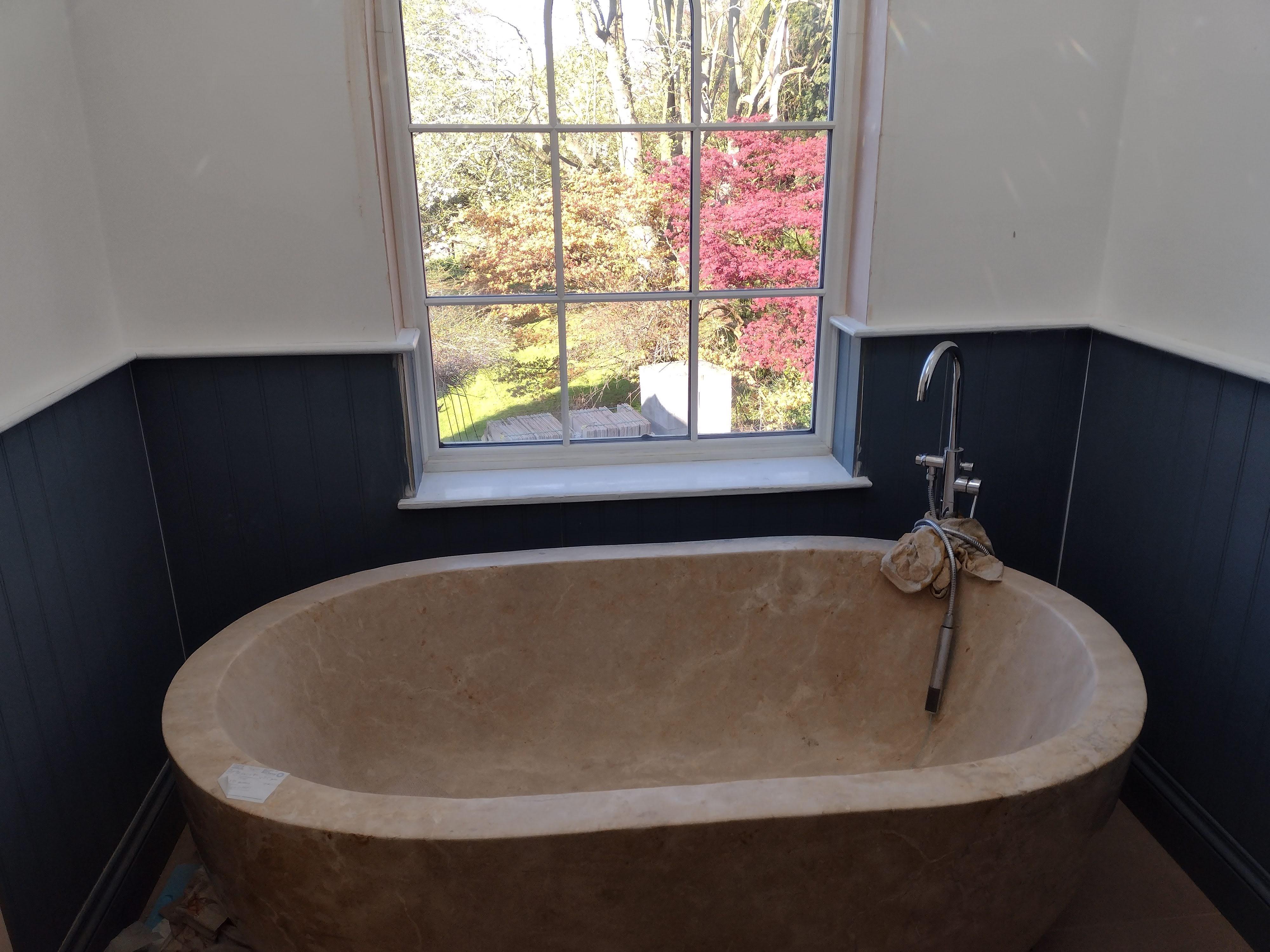

We are thinking about paneling to a height in our bathroom, when we redo it. Less of the rebuking of paneling please.
We are thinking of using the "precast" MDF sheets for ease and cost. I'm just looking for opinions if this would be suitable for a bath panel and use of as a splash zone around the bath instead of tiles. It would be painted/glossed/sealed etc. You see plenty of examples of doing the same but I'm hesitant of longevity.
We are also looking to align the bath central to a window (omnitub if anyone is nosey)and in an "alcove" which would require spacing the bath out 48mm from the wall according to CAD drawings. CAD also suggests our bath tap filler would reach the bath sufficiently if positioned direct on the wall.
I see two options, either stud out the paneling full or part depth (i'm sure no-one will notice alignment off by 20mm) which would allow bath taps to be fitted onto the mini stud wall. Or creation of a shelf running the length of the bath and if doing this unsure if it would be tiles or if some sort of panel the same material of the bath could be purchased?

I know you've all been on the edge of your seats with anticipations of the bath. I was too lazy to actually put it on a sheet so have a screen shot.
The 48.5 measurement is the gap that would be rquired to align the bath central to the window and unsure how to detail.
https://ibb.co/6gCKKQk
So yeah basically create a full height 48mm deep false wall, or half wall with a ledge.  To reduce depth of alcove, so bath centres on window.    I have the same OCD about details like that.
For me if it was deeper than 48mm, something deep enough to put decorative stuff on, I’d create a shelf mid height or whatever.  But at 48mm it’ would likely be useless for that so I’d be tempted just to stud all the way up and as you say good space to run pipes etc.  if you intend to panel this alcove it’s certainly going to be easier just to have the flat wall all the way up rather than stepping in 48mm.

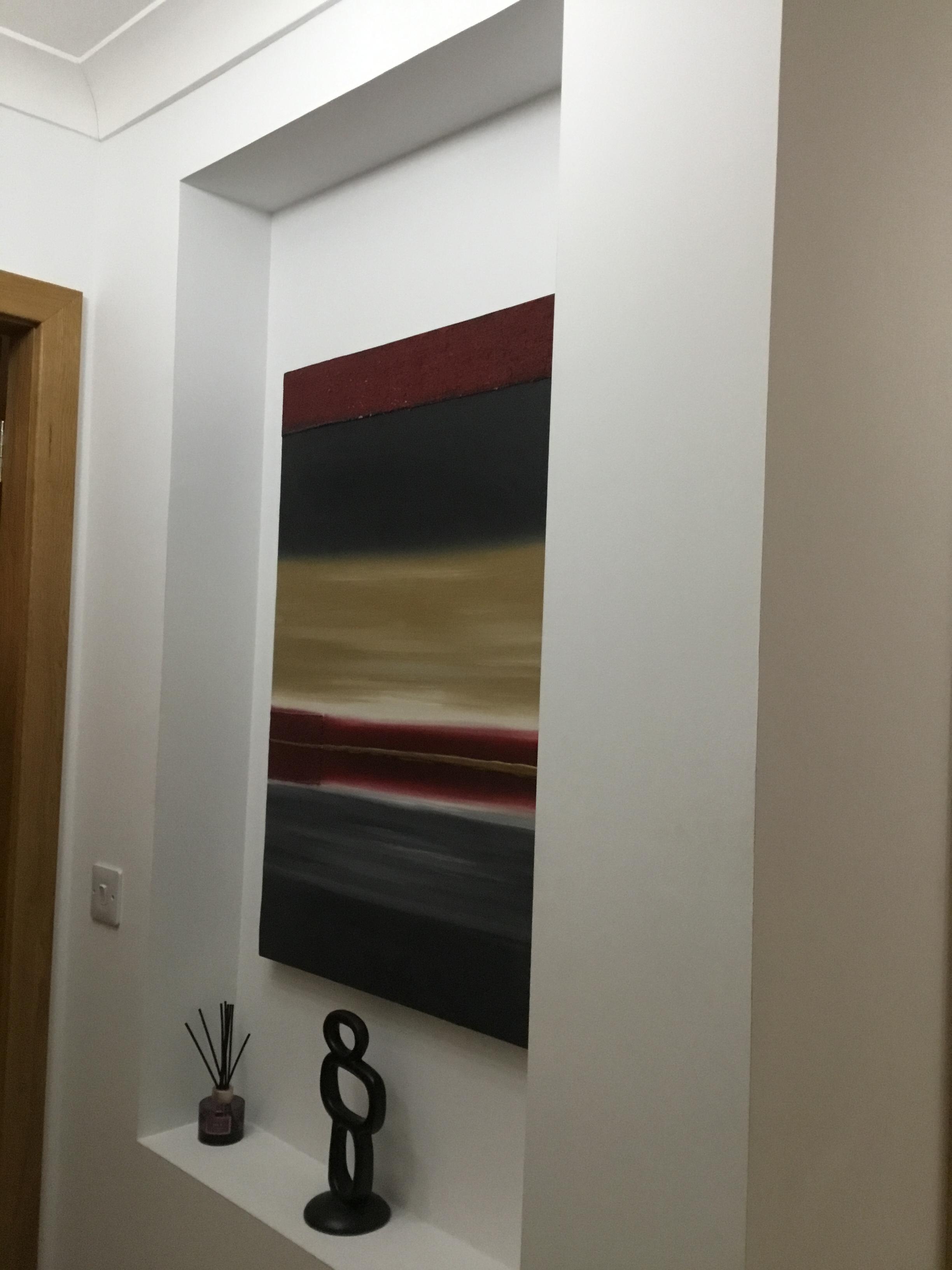

However if you intend just to panel half height or whatever and leave upper half as plain wall what you could do it’s create a rectangular recess in that new false stud (48mm deep obviously) and have  a large piece of art or a framed mirror in it.  A shallower version of the attached pic, which is what we did to camouflage a vertical boxed in soil pipe.  That could look quite good especially if the recess is same shape of artwork or whatever.  As I think you’re going for a fancy lux look with the panelling etc a big mirror with a fancy frame might fit in with the styling.
just an idea…

Thanks @Bozza it's good to know I'm not going crazy over this one detail.
We've talked about having a (fake) living wall along that wall. The whole outside in, lying in the bath and looking at the trees etc so I think a half height stud would work as the "living" element will have a depth that hides any changes.
