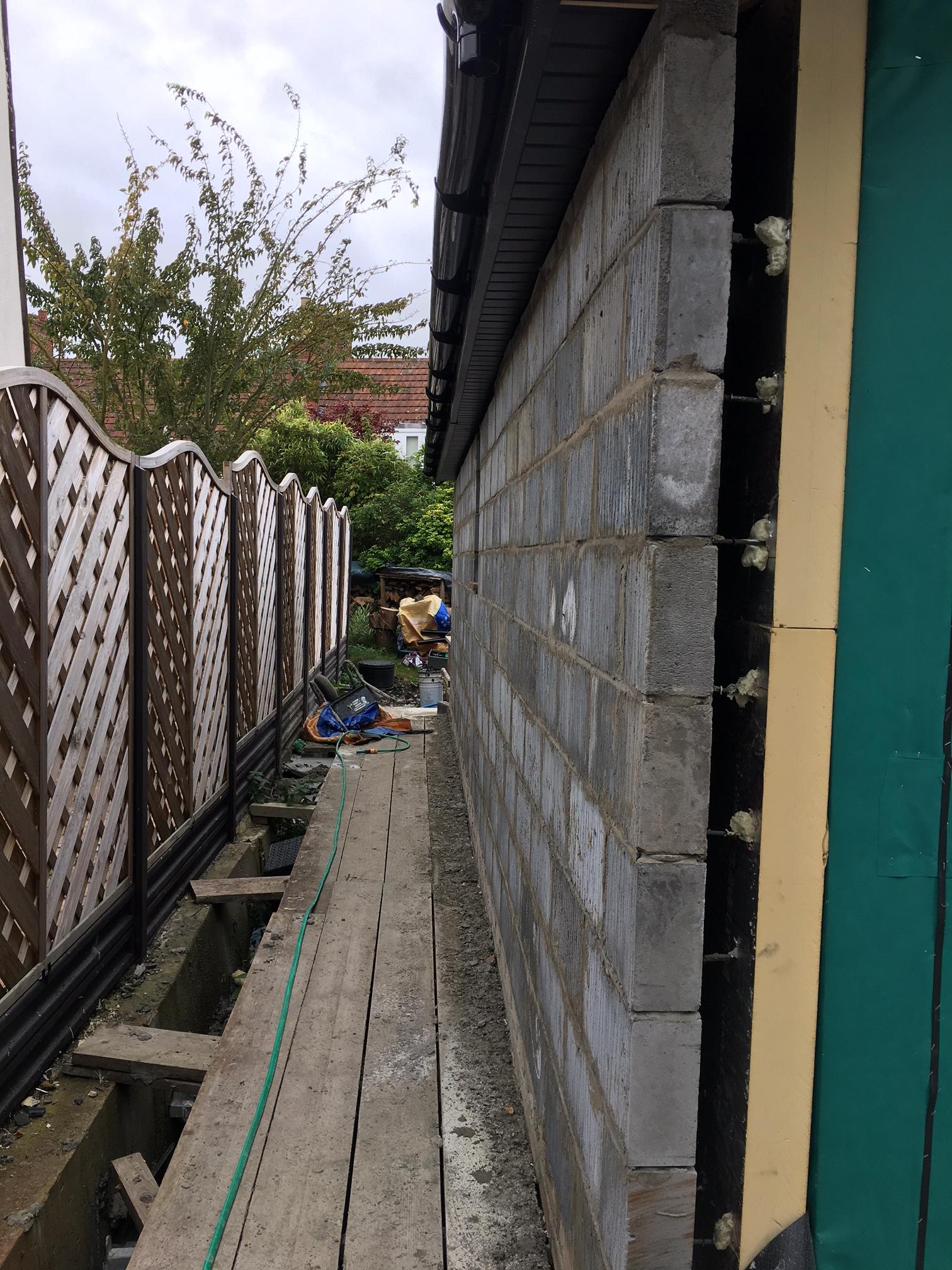

Pocster Posted October 17, 2017 Author Posted October 17, 2017 Well! I did my blockwork!. Architect didn't believe I did it!. it is SPOT on (if I do say so myself!). I started with a line through then once I got going just used the spirit level on every block! - shows the bloody soffit's out a bit now!! I am for hire!; very cheap rates; but I take forever!! LOL! 4
Pocster Posted October 17, 2017 Author Posted October 17, 2017 Just wanted to show that I'm not always completely incompetent! 1
Pocster Posted October 17, 2017 Author Posted October 17, 2017 38 minutes ago, Declan52 said: Looks dead on. There is nothing straighter in the universe !
Declan52 Posted October 17, 2017 Posted October 17, 2017 1 hour ago, pocster said: There is nothing straighter in the universe ! Your soffit 1
